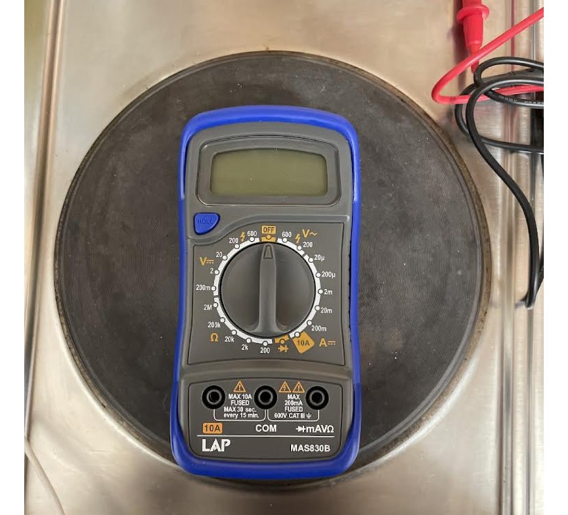

Which probe goes to each one I’m lost and also what setting do I need to set my multimeter C01E002D-0242-4CE4-AC2A-628CD33FA506.thumb.jpeg.b4865a7e6ea8d1783a2fafde1a40b2cb.jpeg
Gnd is ground and Black is Ground / negative , though it doesn't matter with probes as all you will see if wrong is a -5v instead of 5v.
V---- 20 range lhs of dial.

I got 4.7v im Guessing that okay and that im on the old one which is flashable
