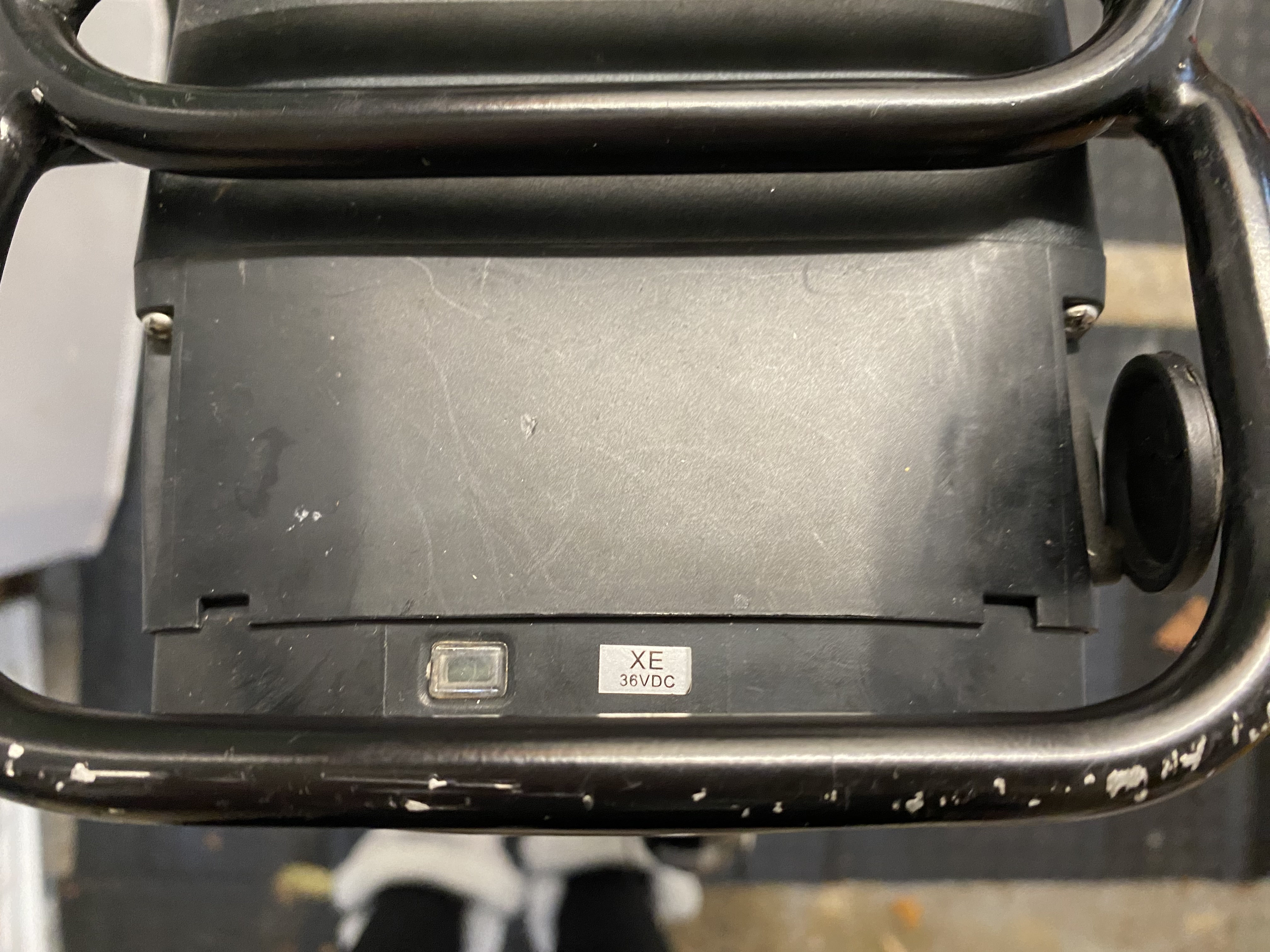

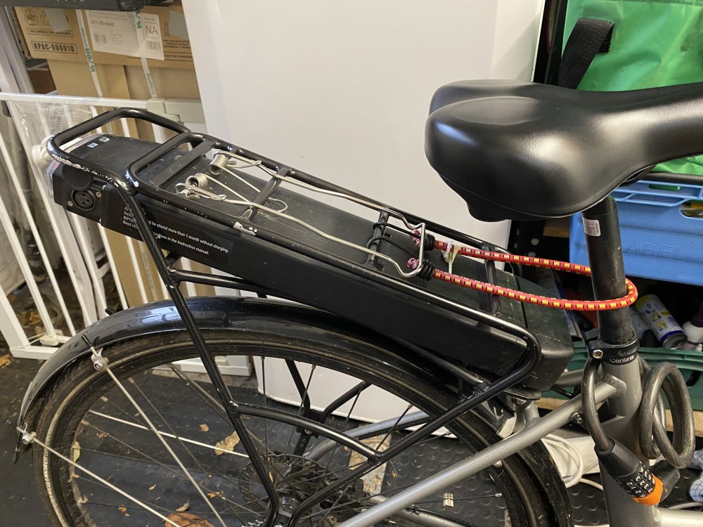

The bike itself doesn’t have a lot of identifying marks so I’m not sure what battery to replace it with. Attached are some pics that may help.

Looks as if it's a Dawes Central
https://www.e-bikesdirect.co.uk/brands/dawes/dawes-central-step-through-hybrid-electric-bike-6-6ah-17-frame-7-speed-700c-wheel-grey
  • Battery: PROMOVEC 6.6Ah 36v
Yours may not be the same, it can vary with year or model. Remove the battery and see if there are more labels on it.
Probably https://www.promovec.com/download/1872664
It may be worth contacting ebikesdirect to see if they have spare batteries.
Alternatively the system looks similar to some batribike ones; the bike could even be a rebadged batribike.

Hi Sjpt
You are absolutely bang on! Bravo! Unfortunately not only do I zero electrical skills, I am embarrassed to say that I can't even remove the battery. I've unlocked it, but it simply wont budge. Promovec say they can sell me a battery if I can give them the article number that is on the underneath. That can't be seen without removing the battery. I can't find a manual online, or anything on youtube. Maybe it is time to change the bike? :(
