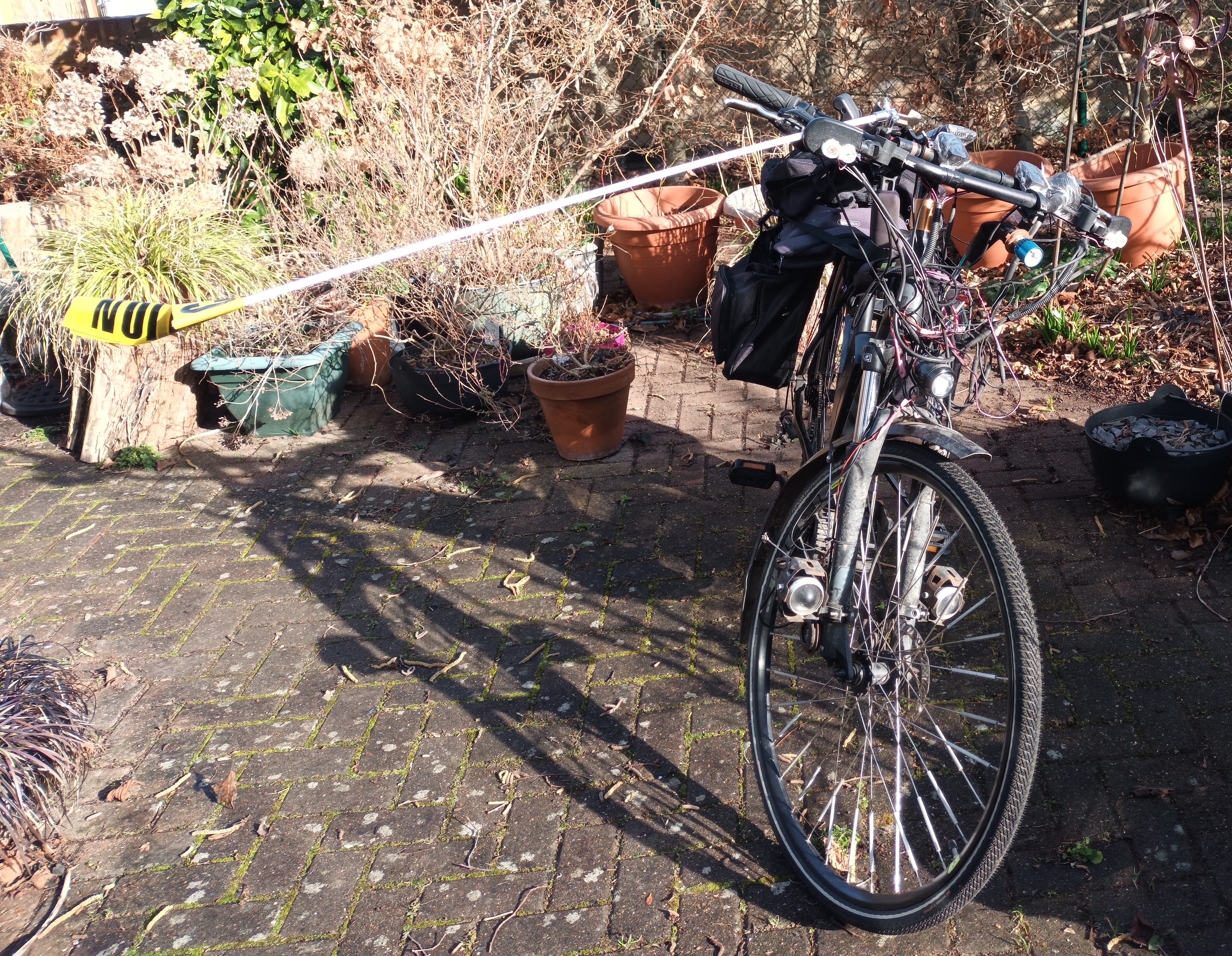

I wanted a warning pole to make drivers give me more room, but when in traffic I wanted to retain the narrowness of a bicycle.
So onto the handlebars I fitted a clamp https://www.ebay.co.uk/itm/404076550188?hash=item5e14d6d82c:g:pUMAAOSw1kJjqskl&amdata=enc:AQAHAAABIJrE3tpAt+xsXcJx0rXIXf9IK7q7zbJLHm1ojUfLtdN5CRnIMmP9+3NVWO1ImFh+U1VkSnAah1gSW54/ACIeDpv8vrMWOSBIpzXgMRgzyOWT0RADmKtn4ndf6zDX7XhNOiyDKNIsgu/eWIFbXg6q6SGny1bQlwiifLIz7y2hF8wdeqSU/5ScQiHFf+Yz0GfbPCwUw/vg3/Epxw9vplOEWFPhrQoCEP47paSSCqvnOsK31/YnSlCpZxUE0esmH5jByxwZAXlla1e5BCHj0PgadCTjBGUAA+6MvsWlK5rhoe89I6wQPXneqJ5nagLXimDSAD71w0NUajKFM4E2womFmIh1u5afsMUVb0p/tmeA0lAzyHrhXvxSLSroRbo3ZgttVQ==|tkp:Bk9SR8S8h_TLYQ
then added a swivel joint https://www.ebay.co.uk/itm/393022202859?hash=item5b81f2e3eb:g:jTEAAOSwvi5ftWIS&amdata=enc:AQAHAAAA4It43NOLIpzFDULfrvhWpctiAERVFmr1Wc+y27nrC6nrMNqCDzJ+YvXxBzE5NQwWvbMciFjt+c7Y5Yt7dvvLTBus/4WMjKWNGyhJWudwvWT7SeUWzp2VBPj3fYGr8jC2BE7CcWcIfGsY570qQKLtdsp7nyxQ17kH7/V7WpUfyIBn335uxCZoCLwneyXzbc9IjrHhEKfbgDU+sES/NRoZuN6jkmSFCHDj719pBZdL7lzvlhtLBigzHs5tGBQcIEQVpJu2nhk7DI5IQpfXWAvxPvCwpNo+ScaHj6r7BjWaXdf7|tkp:Bk9SR5bqjfTLYQ
To this I added a plastic pole from I think B&Q (it's been in the loft for ages) with a flag at the end made from a warning tape.
It works, with the closest pass now being about 1 foot from the end, rather than 1 foot from my handlebars.
When approaching traffic I can simply flip it up & over so that its laying across the handlebars.
At journey's end I simply rotate it so it lies along the length of the bike.

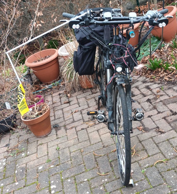

I am thinking about the night version made from angle iron (plastic) with LED strips front & back.
If superglue doesn't dissolve the plastic pipe, superglue + baking soda to weld the plastic angle to a short length of pipe? Could look like a Sith lightsaber... :oops:

[mention=18904]trevor brooker[/mention] - Perhaps clear acrylic tube to contain your LED strip lights? Some kind of cover for use in daylight? Of course various other clear acrylic tubes are available on ebay and elsewhere.
