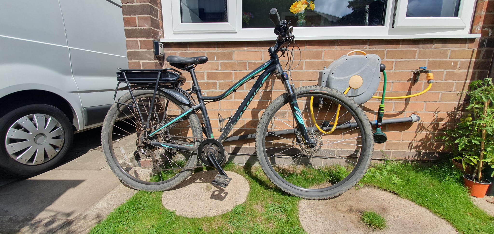

Hi All,
Hopefully a straight forward question, my wifes bike has TSDZ2 with a rear rack battery 48v 15ah, but after a couple of years biking she now says the back end of the bike is getting too heavy for her, i was wondering if i could simply put a smaller bottle type battery on the downtube but the only one i think will fit is a 36v 9ah would this still work with the 48v motor ? or if anyone has any ideas on other battery options.f51d4125-8475-477d-8b6a-fea7e2772821.thumb.jpg.f5b7ca5a129413595a9f0cb8c886feb8.jpg
Lvc for the 48v controller will be wrong for the 36v battery, when the 36v battery hits 39/40v you will have cut outs and if not sooner in higher power modes .
The battery meter would also read empty nearly all the time.
You will need a 48v bottle battery or smaller footprint battery.
Not much space in the triangle for a battery so you may have a slight issue fitting something.

The space inside that triangle may be too small for a conventional downtube battery. Cut a pie e of cardboard 36cm × 10cm to see if it will fit. If not, fit a 48v 10ah bag battery.
