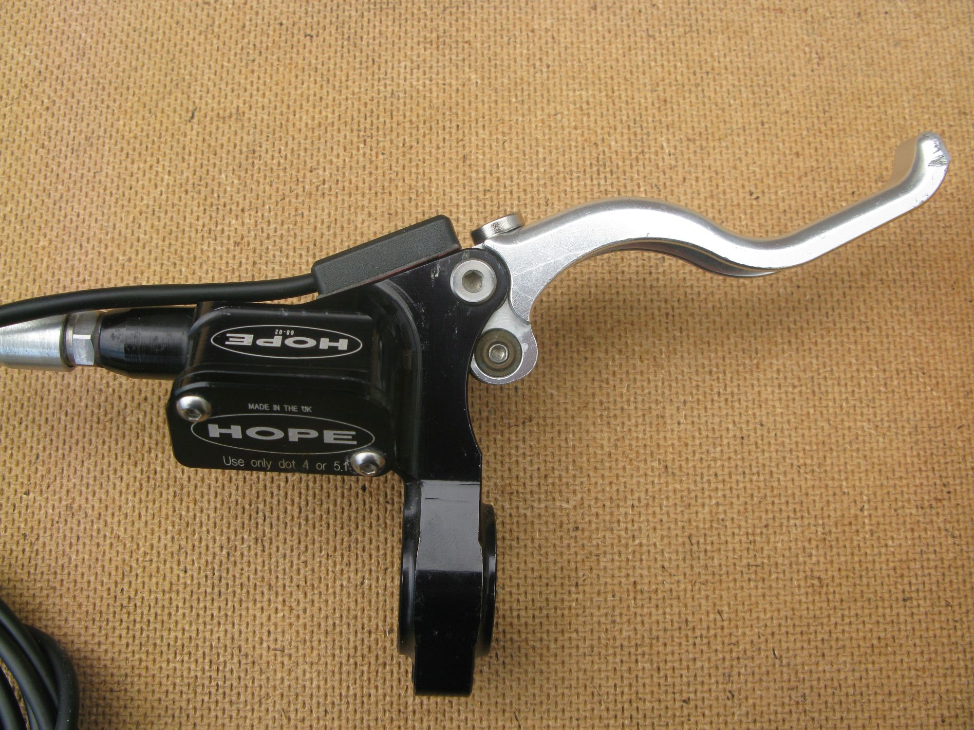

Tektro M285 are the easiest to fit hydaulic brake sensors to. This is on one of my old bikes:
Is that a reed switch in the sensor head? Did that come as part of a kit, or did you have to put that together yourself?
you can make your own with off the shelf reed switches but they cost only about £16 a pair of ready made sensors, it's not worth the effort making your own. I put a 2mm screw on the magnet because I don't trust the sticky pads that come with the sensors.
I did the same, first positioned the magnet with a bit of double sided tape. Adjusted position so that it switched correctly. Then drilled a pilot hole throught the hole in the centre of the magnet and secured it with a small self tapping screw.
