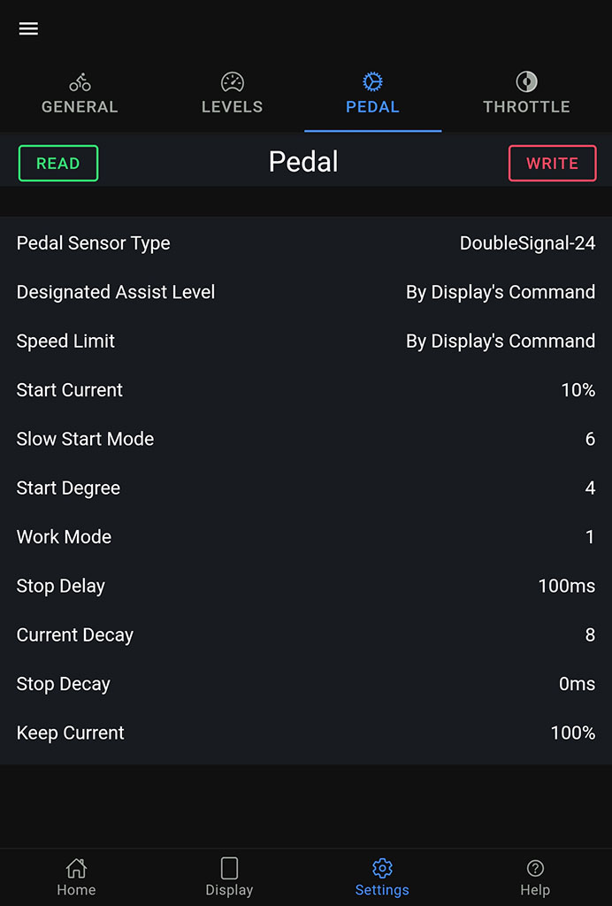

Which one? There are several Bafang mid-drive owners here. Mine's a 36V 250W BBS01B.
A higher gear works better, that and max assist gives enough of a push, enough speed that lasts just long enough on a slight upward slope,
I have no difficulty starting pedal assist on steep hills, provided I'm on a low enough gear when I stop, or I end up having to cycle downhill a bit, or to the side, or I zigzag up if there's enough room. Setting "Keep Current" to 100% using the Speeed App and a Bafang programming cable helps, otherwise power drops off uselessly. Factory settings are absolutely awful, mine were.
