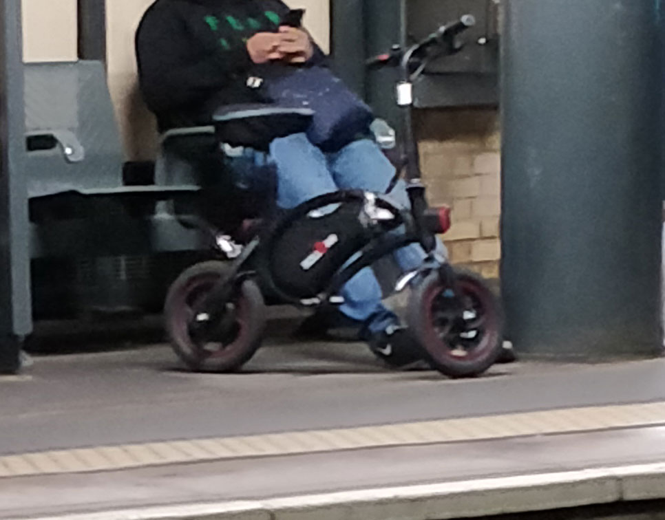

Saw this eariler tonight - throttle only 350W electric motorbike with no pedals, about to board a train. This model is 2 or 3 years old. Some sort of gaffa tape repair. Sometimes I don't know why I bother trying to be legal.
Edited by guerney
