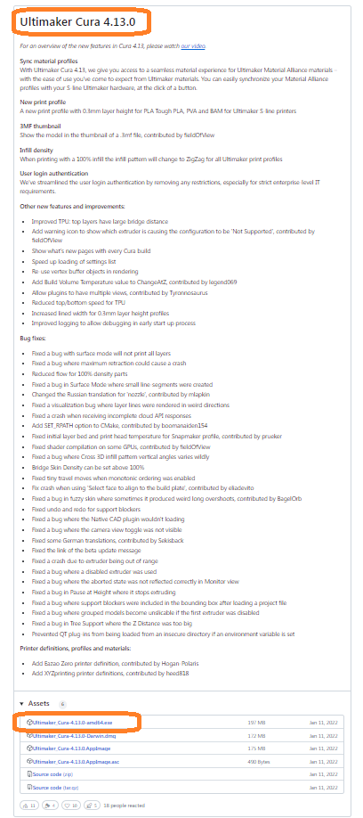

I did try looking for Cura 4.x but the best I came up with was a github repository which tbh didn't seem to have any executables in it.
I'm a bit of a numpty where github is concerned - I like fully packaged installations, double click and all that, lol.
Cura 4.13.1:
https://github.com/Ultimaker/Cura/releases?page=2
Expand the [Assets] tab to see the .exe Windows installer - install this.
I just upgraded from 4.10.0 to 4.13.1 on Win7 Mackbook Pro until I have some time to mess on my Win10 workstation to get 5.x working.

The link works however it's in chronological order of releases so most recent at top of page, SCROLL DOWN for the 4.13.1 release or just search the page (CTRL+F) for it....
I'm using it now on Win7 laptop, try 4.13.1, just run the .exe and installer should remove older version first. Setup a profile for you printer (YT vids it if there isn't a default for your specific printer as this dictates bed size etc.).
SCROLL DOWN - durgh, found it - I told you I was a github numpty and not helped by vireing the link first time around on my phone !:(
So yes, 4.13.1 installed and working - that version didn't have Elegoo printers listed but thanks to this YT vide
which lead to Github resources here, that's sorted.

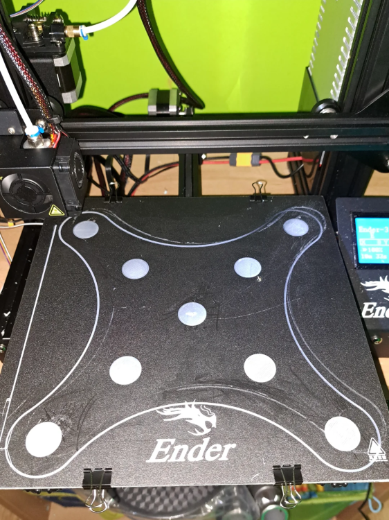

Is there a 'test' print option in the firmware ABL so you can print a test pattern and make sure the z-offset is optimal?
Not on my printer - I'm wondering if there is a test print out there for me to use?
Search for '3D printer bed level test', you want a pretty flat print that covers most of build plate.
