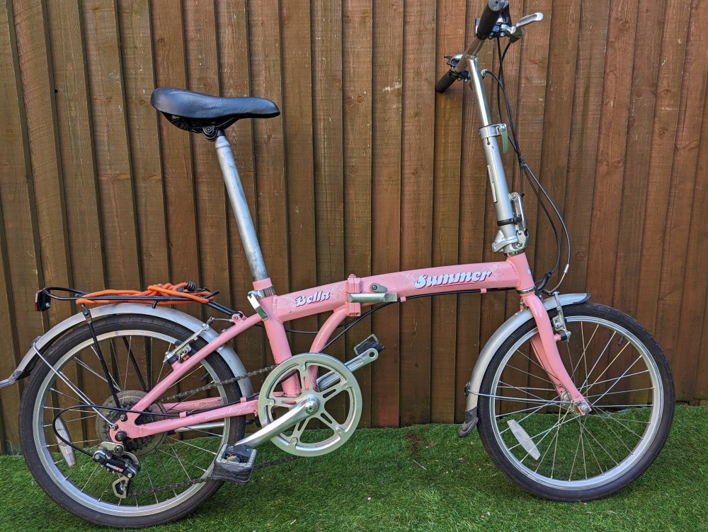

I wanted a bike that I could do a bit of exploring when we go on holiday in our campervan. My wife has a lovely little folder that I have got my eyes on
PXL_20240531_170736901.thumb.jpg.59ed5671bd2c3e41a845f9170ec31827.jpgPXL_20240531_170749779.thumb.jpg.93c3bc2f3c7377b8dca5245b680d2614.jpgPXL_20240531_170812451.thumb.jpg.13e7daa9d30db398e0b41c7879e27f66.jpg
I had a little ride on it just now and it put a big smile on my face !

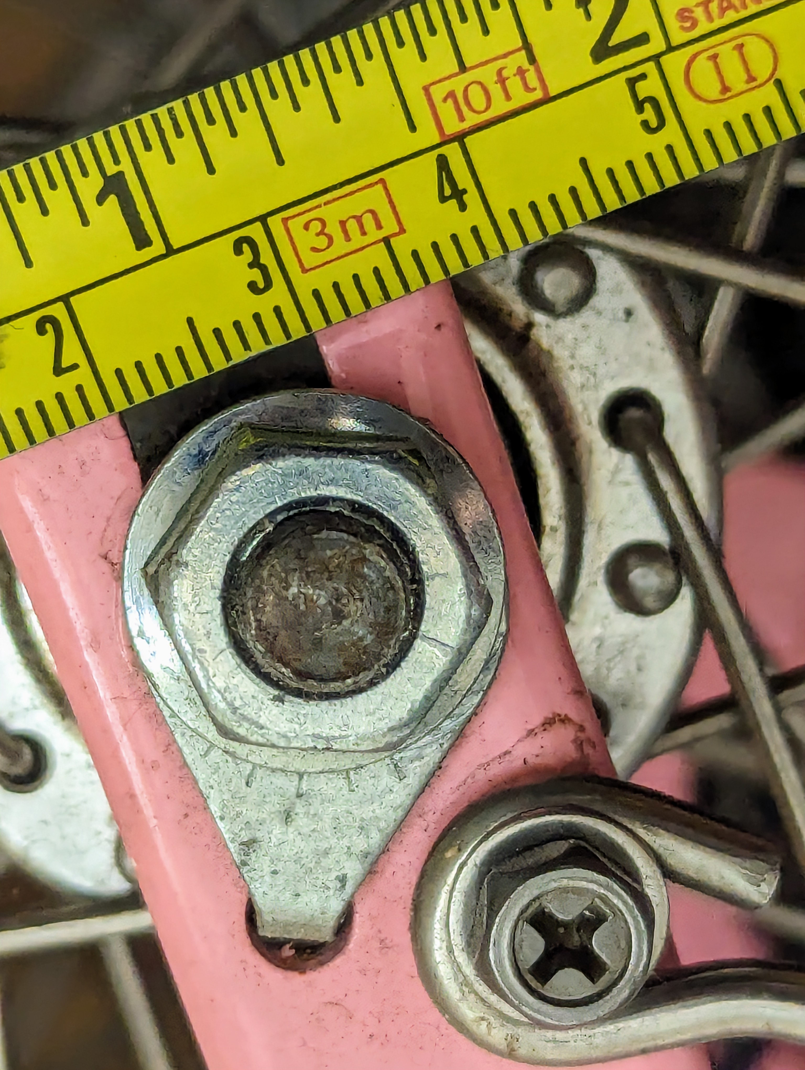

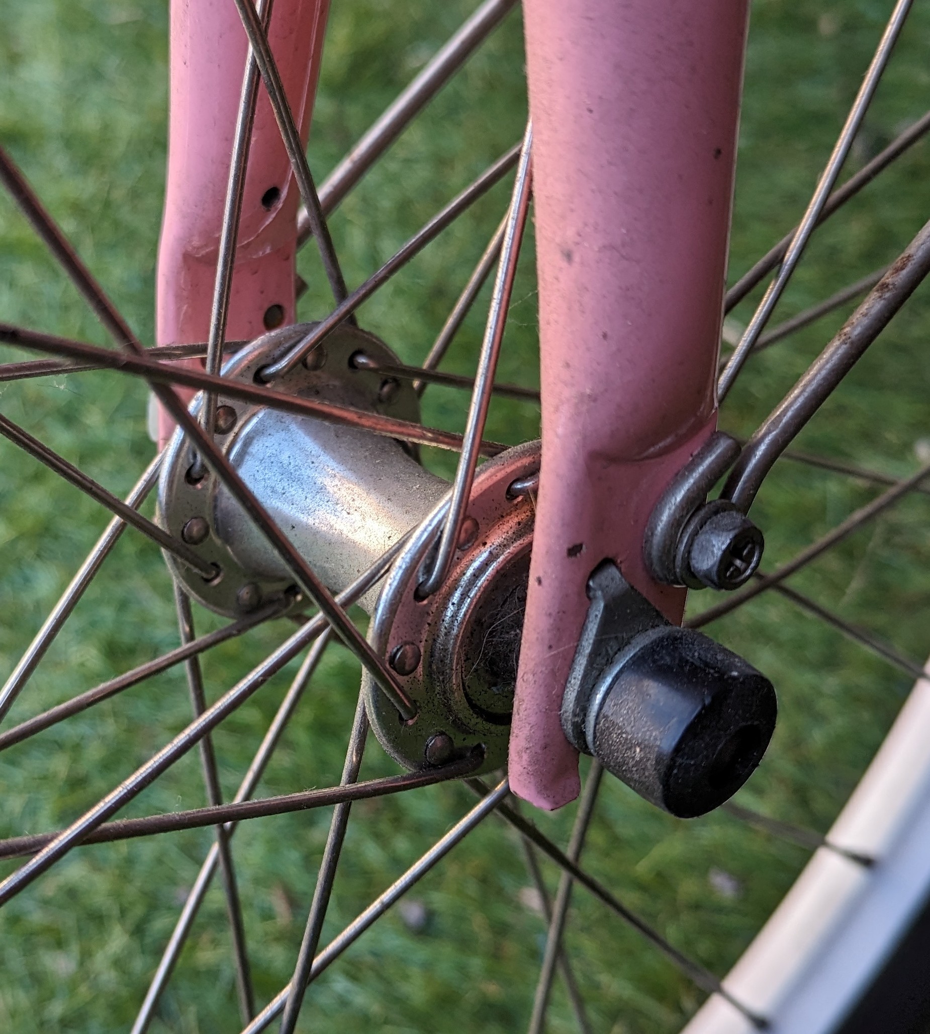

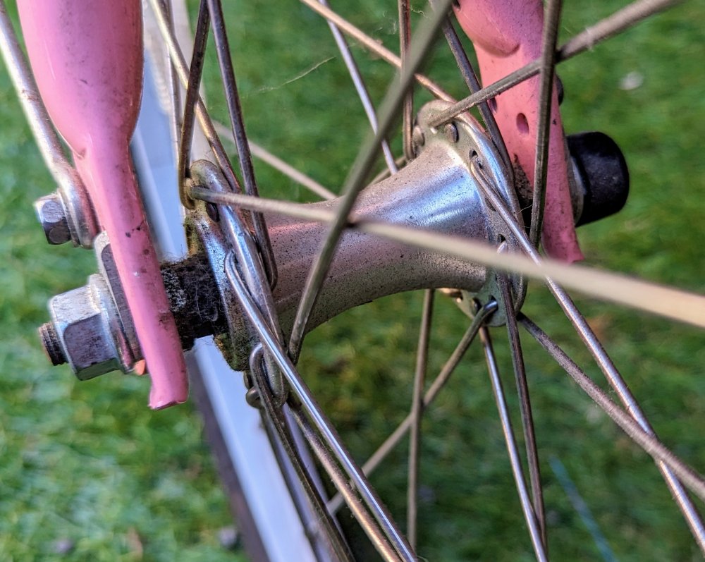

Roughly 75mm between front forks

Thanks, spoke to Andy, the front fork spacing is 75mm which is too narrow for the Woosh options

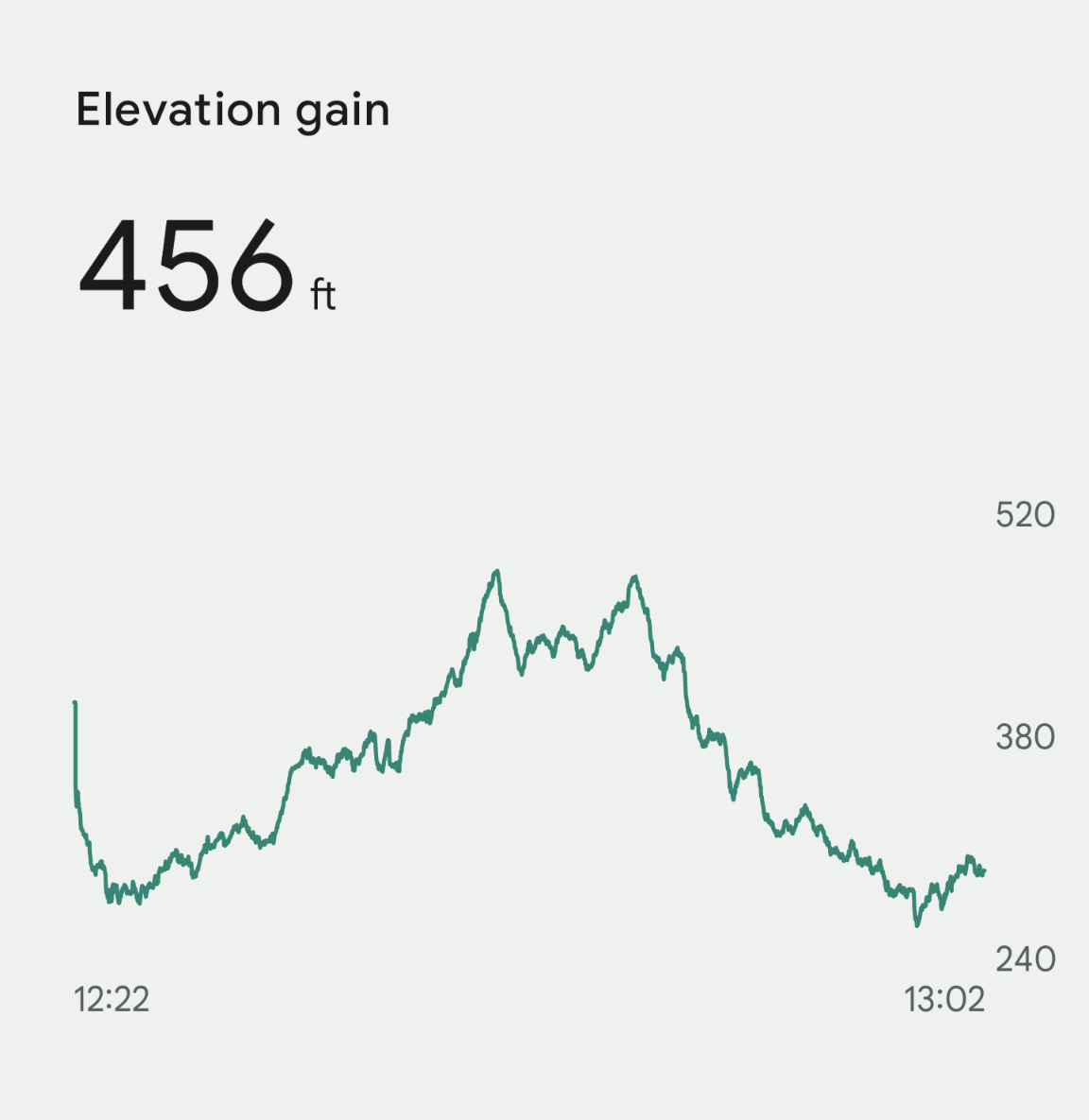

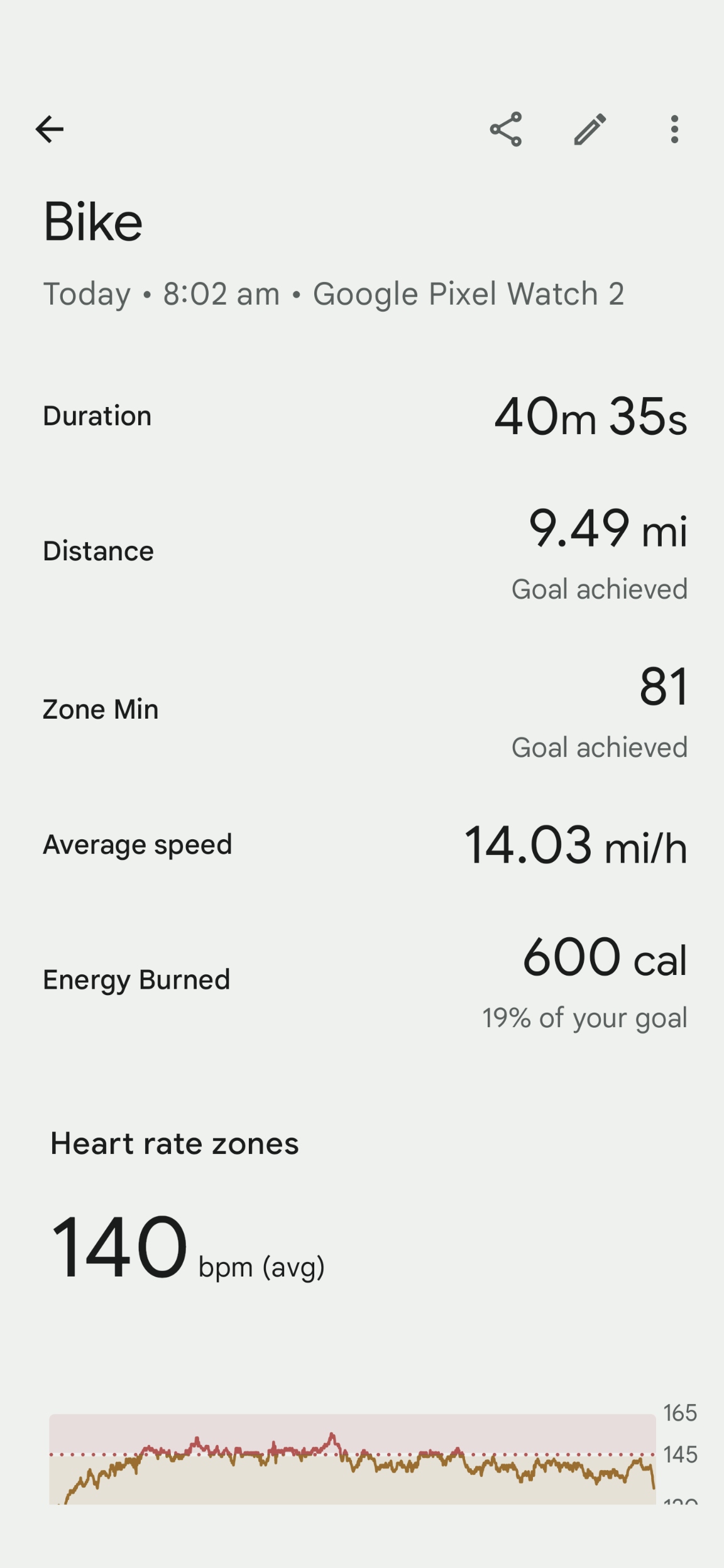

Just tried a 10 mile ride before I did the conversion with 500ft of elevation gain - it was great, very comfortable, I managed to average 13 mph according to Fitbit, and to pedal some (flattish) miles at 15.5 mph average speed - the gearing really was the limiting factor, but I guess there is nothing I can do about that - freewheel minimum teeth is 14t ? (So 52t*14t *20 inch wheels) It's only a campervan bike so I can live it as is.

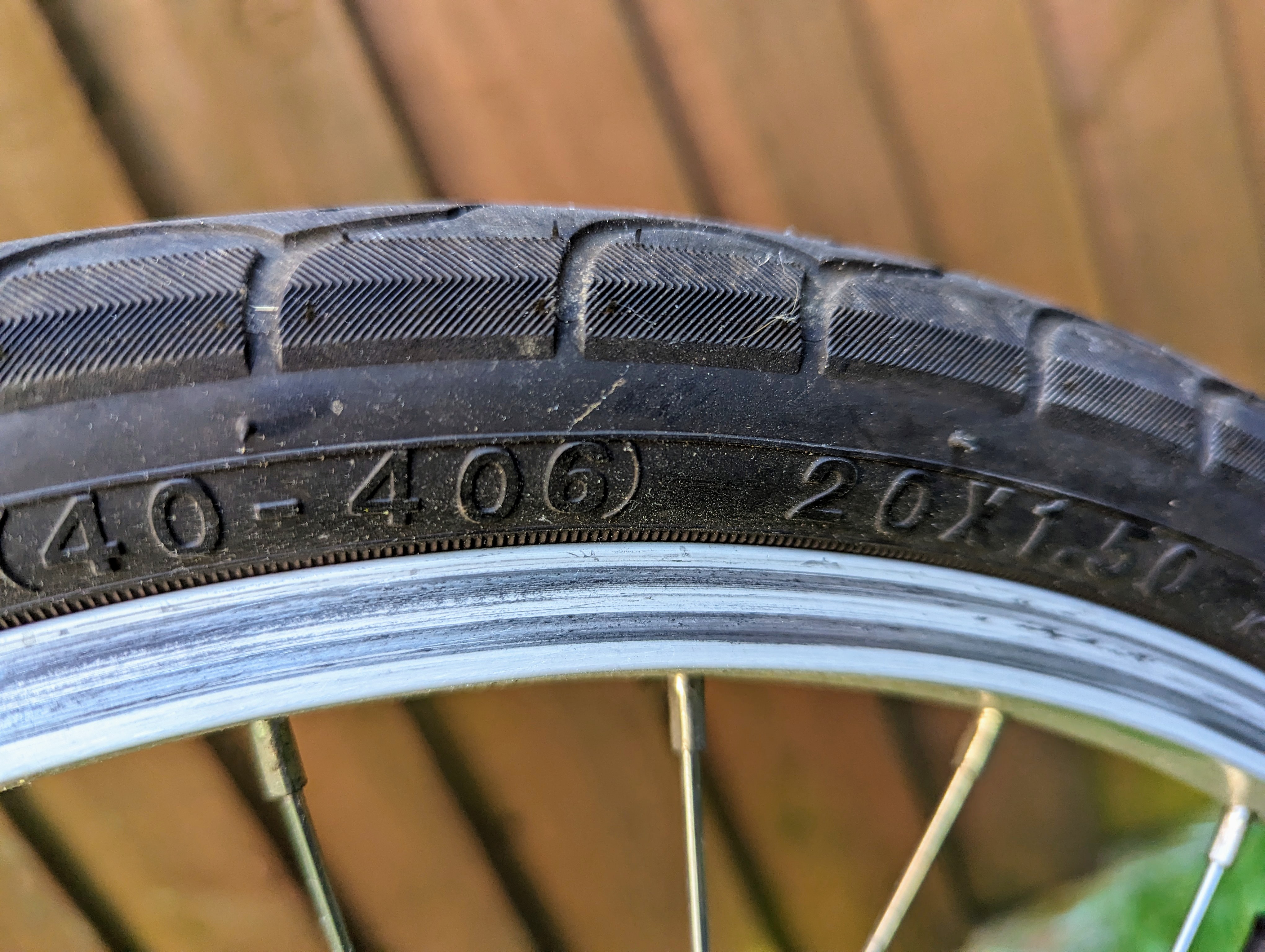

For front wheel option, I have the motor with 75mm dropout but not in 406 rim. You would have to lace the wheel. That's why Andy suggests the DWG2NC kit.

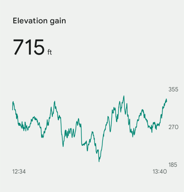

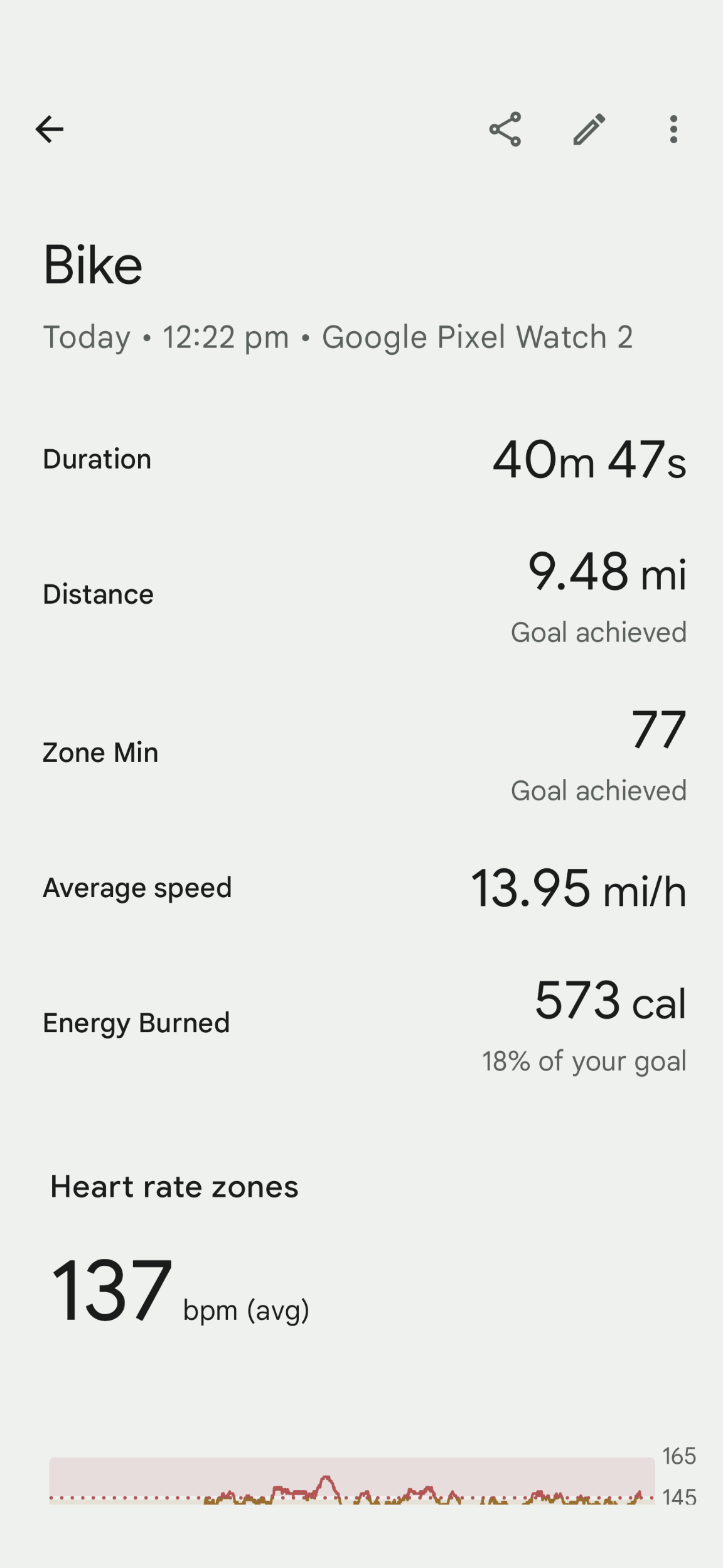

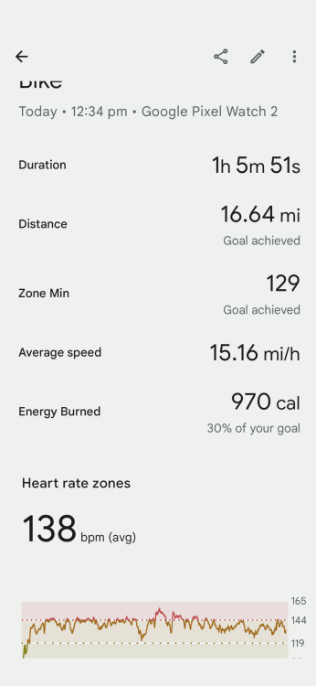

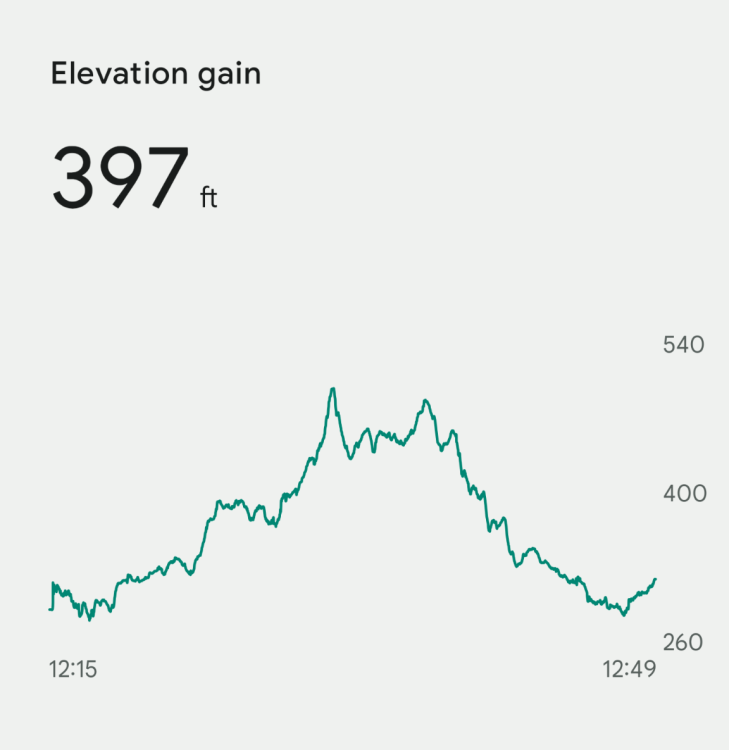

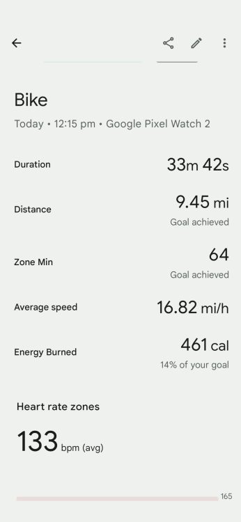

Ok - before conversion !
I might try the same circuit with [mention=3847]saneagle[/mention] 's 11-28 freewheel (can I average 14 mph ? !) and then again after I've converted it with the microhub (1.5kg akm75) and Woosh bag battery (1.8kg)
[ATTACH type=full" alt="PXL_20240531_170704341.jpg]58006[/ATTACH]
[ATTACH type=full" alt="Screenshot_20240605-130820.png]58008[/ATTACH]
[ATTACH type=full" alt="Screenshot_20240605-130907.png]58007[/ATTACH]

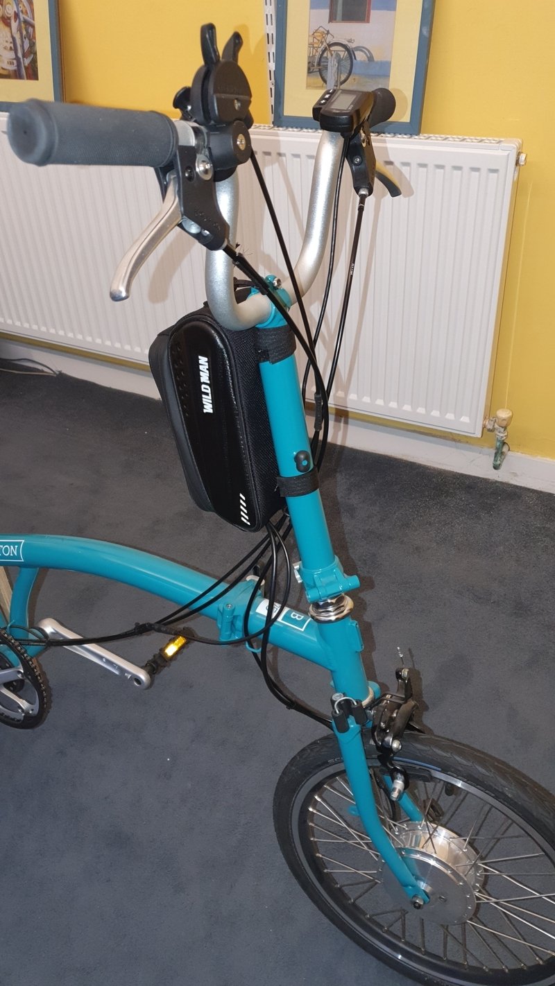

What are you going to do for brakes?
https://www.ebay.co.uk/itm/335421855578?itmmeta=01HZM6N55Q15KYGME3TJRJF81E&hash=item4e18b3575a:g:XeoAAOSwIHJmXFld&itmprp=enc%3AAQAJAAAA4Ja34kzZz1f0lb9%2BWWA5wiYvRdPZQom%2FKN%2BfeyYwyFYNHZSlPMG9zHAhUphaF778%2FeLE7uFzYb8fgQMWkQEBEafviYdvGRegiER9TJxVOSOV10XQ7p2TjmZbfSKf8vgbeyK6NF3ifJ9gRhA6HyDD8PFFKhZ8MksvFj0hBQiXhMTkyv3OsNqLEWaR6l4%2FVhhWAMh%2BWB7lYFsry0j6%2BHB9SGx53a%2FfEuND4fNVlGZcReg1dTKqJMnqsZtCHzkODeLLGOL96qb1huuHSpRSntcNQUa9gkv3Yrw3CXj27Mb4BbZL%7Ctkp%3ABk9SR_jS1Ib9Yw
I think a light folder, ridden at 12-14 mph, will stop well enough with v-brakes. Anyway, we've accumulated over 10K miles on our 20" folders with v-brakes.
I did change the rear brakes on mine to hydraulic calipers and they are far better, but I did require an adapter, The front would have required a new wheel and fork, Not worth it for my riding speeds,
Yes, I'm not allowed any more e-bikes but I was allowed to convert my wife's folder otherwise I would have started off with a bike with disc brakes. This is purely a campervan bike to use on our holidays. I was rather surprised how fast it is unpowered, I had assumed it would be massively slower than a full size bike.
I bought that freewheel that [mention=3847]saneagle[/mention] suggested and it is a lot less frenetic peddling in top gear. (11t vs14t)
Made a bit of difference unpowered and felt less frenetic but I think it will make a bigger difference once the kit is fitted
ETA - you really notice the hills unassisted !

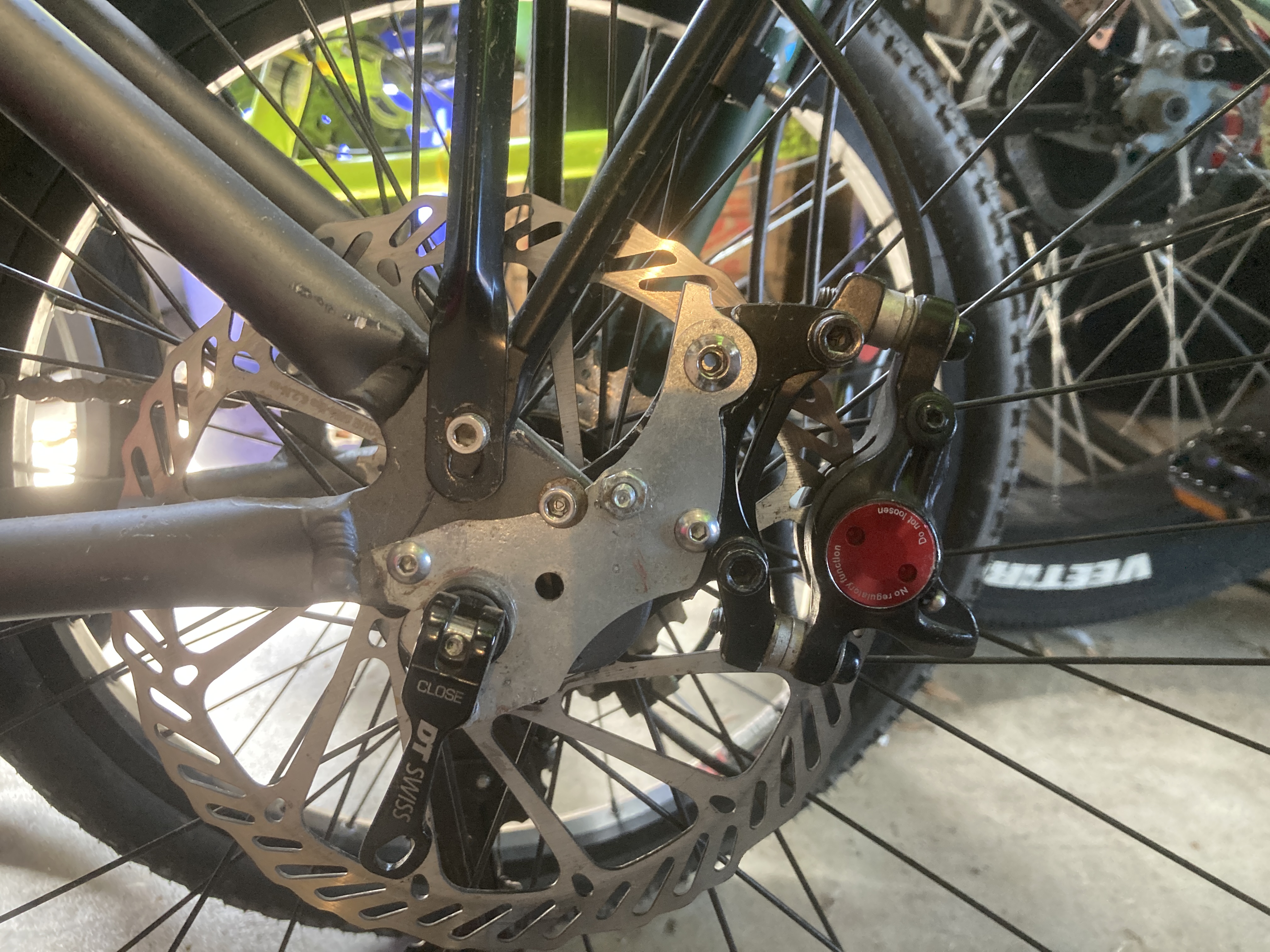

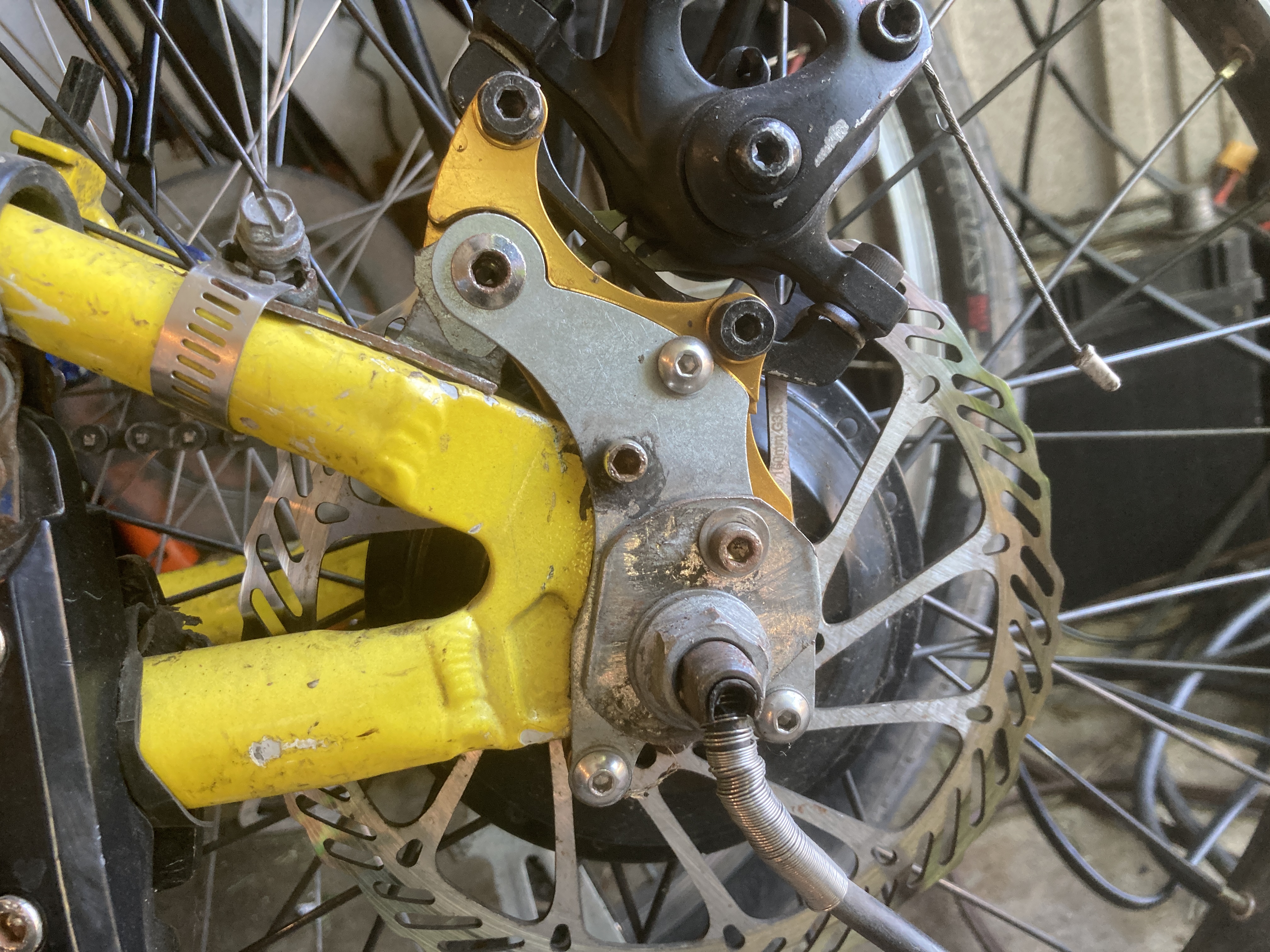

...I'm very curious about what adapter you used, and where you got it from. Also how you installed it. I'd prefer disc brakes to save my rims, because the right ones are increasingly difficult to source.
Edited by guerney
These were designed for gasoline conversions. What I did with them was to remove a lot of metal so it would fit between the dropout and motor, and cut a slot to match the dropout, and position it in a way that I could use existing holes in the frame to hold it. A torque arm like strut was also added.
https://www.bikeberry.com/products/bbr-tuning-billet-aluminium-disc-brake-caliper-bracket?variant=36268020564134&/?utm_source=google&utm_medium=cpc&utm_campaign=PMAX%20high&gad_source=1&gclid=CjwKCAjwgpCzBhBhEiwAOSQWQWcCpak8uAL0Ecr-QyrhlJQHjQWXCuuU9oMX8Qtbxdow032QDUJt2RoCS1IQAvD_BwE
This type was less metal cutting work. It clamps to the dropout, is designed to push against the frame during braking, and requires a thru-axle or skewer. Position it so a screw can be added thru the dropout to hold it. Cut the plate to match the dropout to allow a hub motor. Make sure it can resist the brake force,

Thank you, I'll see if I can use that to install a rear disc brake to my Dahon Helios, which doesn't appear to be compatible with the first adapter.
HorizontalDropoutonly_400x.png?v=1709941828
At that price, it's worth trying to save wearing away the rear rim. I've got a rear cable disc brake from a bike I found dumped in the woods, to test it with. Of course I'll need a new hub etc.

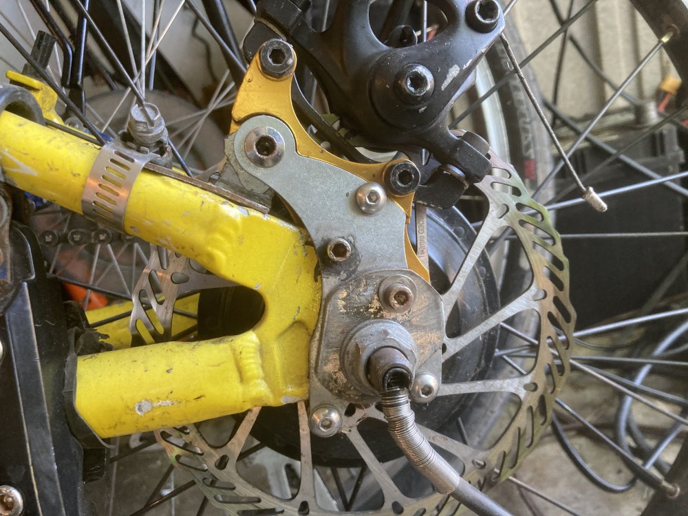

RJ the bikeguy taught me a lot about wrenching bikes, but he did need to do further work with that adapter.
Using it with Q100 hub motor. Torque plate over the adapter. To remove wheel, I take off the torque plates on both sides, and the adapter is slotted to allow wheel to come out.
The adapter rests against the frame to resist rotation. There’s a small bracket hose clamped to the chainstay to help keep it there.
Edited by harrys
Same adapter on a 26” frame, regular hub. It’s clamped on in a similar fashion and positioned with a slot so wheel can drop out. It’s clamped to frame with screw on lower left. A second screw resists rotation.
Hydraulic caliper is quite smooth.
Edited by harrys

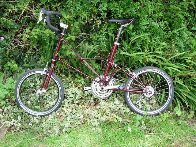

That perfect steel framed folder might just be this Pashley Moulton TSR 27 that I used to have and sold about twenty years ago. I rode it powered by me 40 miles in two hours and two minutes. It isn't exactly a folder, but you could withdraw a pin and it came into two pieces so it was easy to fit in the boot of a car. It was a surprisingly fast bike.
[ATTACH type=full" alt="58137]58137[/ATTACH]
That wouldn't be easy to convert.
Well I won't argue with you on that one. You've done many and I haven't. Really, it would be a bit of a sacrilege to mess up a bike like that anyway. Possibly you might fit a nice BBS01 on the BB. No idea where the battery would go. No one would convert that bike anyway.
There was an ARCC conversion for exactly that bike, though a bit expensive.
https://www.arccbikes.com/knowledge-hub/news/electric-bike-review-arcc-electric-moulton
I've never found a bike that couldn't be converted, but I often ask why someone would want to go through the trouble and expense when there are easier options.
