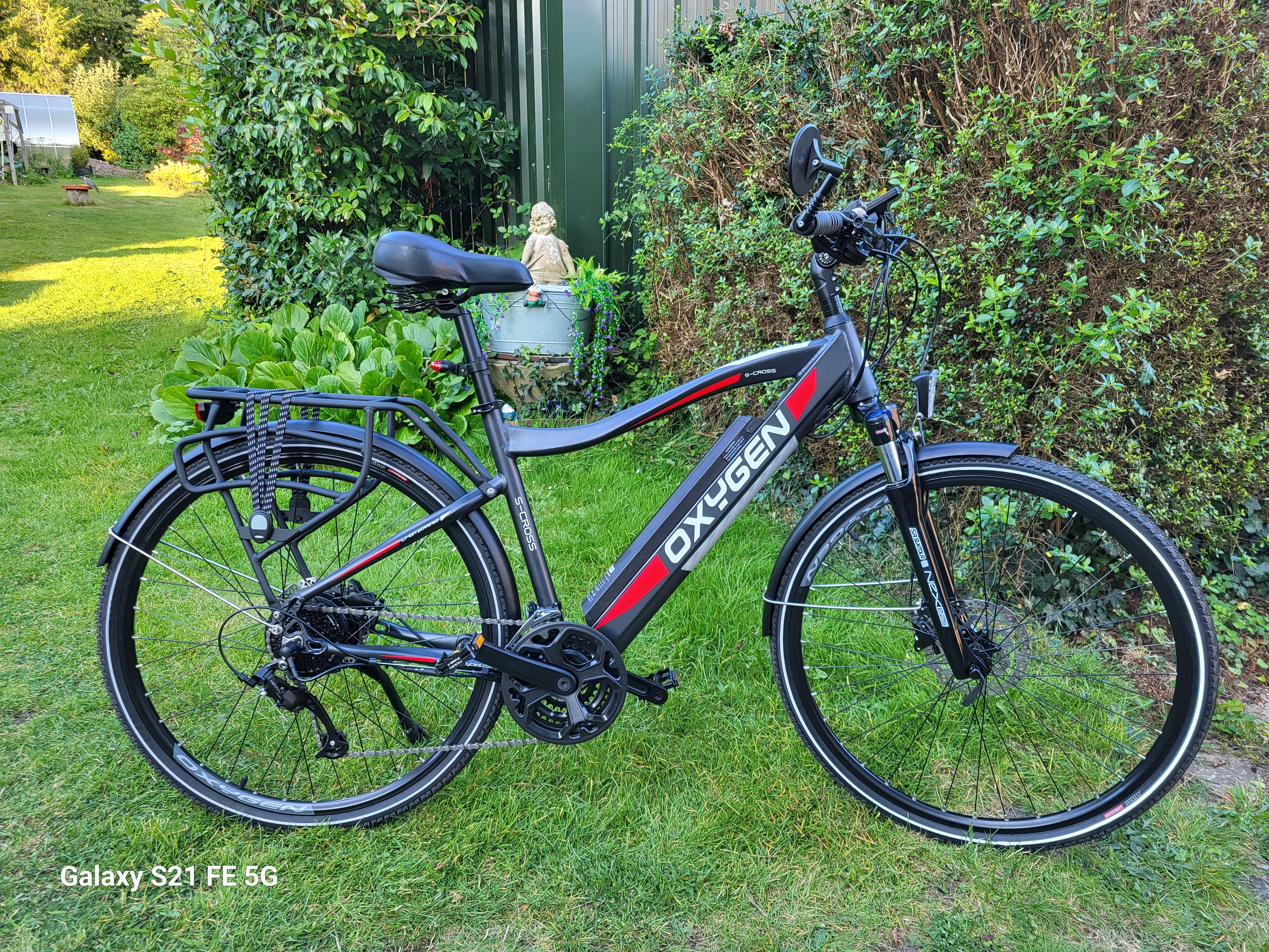

2024 Oxygen S Cross CB MK11. I've only had it a week.
I'm pretty clueless with a soldering iron. My plan is to source the right gear, then get a local Ebike chap to install it. I know it's going to void the warranty, but I want the same experience in the cruise that I had with the Freego. Everything else on the Oxygen is great, really strong hill climbing and well balanced handling. I guess I could endeavour to put up with it if I must, but I'm in my 70th year and I want maximum fun, if the issue can be fixed, that's my priority.

Ok i missed the bike full id in the title and searched for freego oxygen doh!, That bike sure looks more 15mph capable ;)
Yeah, probably not the bike you would have bought if you expected to want to upgrade the control system..
If applicable a return might be worth consideration? if looking to upgrade the control system a bike with a more bolt on look can be both cheaper to buy and easier to modify.
