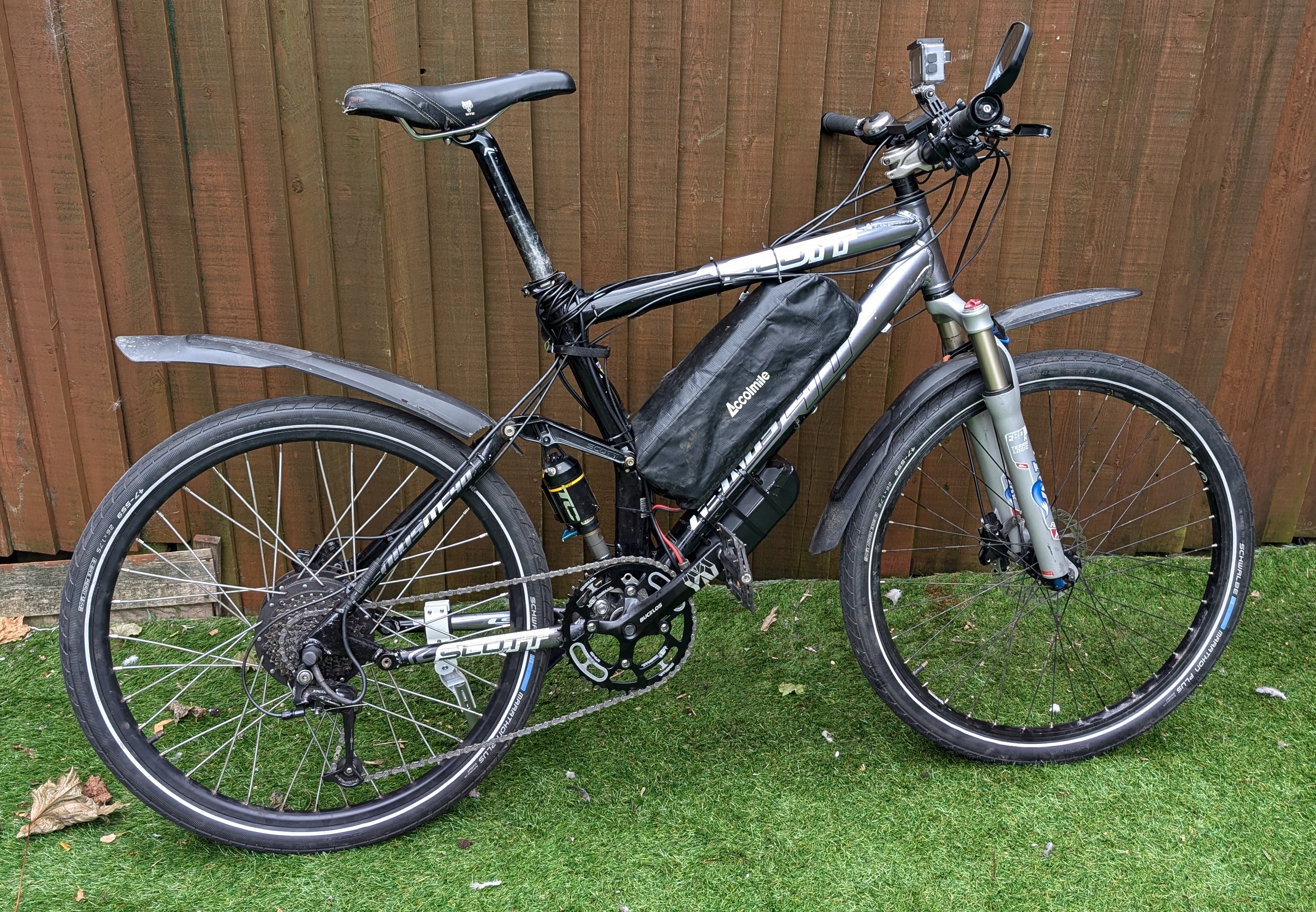

I took my rear hub wheel off my Carrera (with coil front fork) and moved it to a genius mc40 (aluminium frame) which cost peanuts

It is a rear hub conversion
I stated with a £50 Facebook marketplace 15 year old Carrera Vulcan hardtail (26" wheels) with mechanical disc brakes and fitted the ubiquitous Bafang G020 rear hub ( winding code 12) with the standard 48v 18amp speed based controller. I upgraded to hydraulic brakes (£30 off Ali express) and the woosh bottom bracket torque sensor - which came with a controller with power based pas levels
That all worked really well, but it was a bit heavy to get in and out of my shed, the coil front fork wasn't great on trails and on very steep hills (1000 ft climbs with gradient getting up to 27% with a combined weight of 130kg for me and the bike) the 6 MOSFET controller would overheat
So that is where I got the Genius (again off Facebook marketplace) , fitted the Bafang rear wheel , with a 9 MOSFET KT 22anp controller (that I have "detuned" to 18 max amp). Seems brilliant on road and trails, possibly would have got the winding code 14 version if it was primarily for trails. Went to single front gear (48t) for leisurely pedalling cadence, again, possibly would have gone slightly smaller if using primarily for trails. 48v 20ah battery is a bit tight but can slide on and off (20" frame).
The suspension seems fine so far, checked the shocks air pressure after a couple of months and it has kept the same air pressure - no leaks
