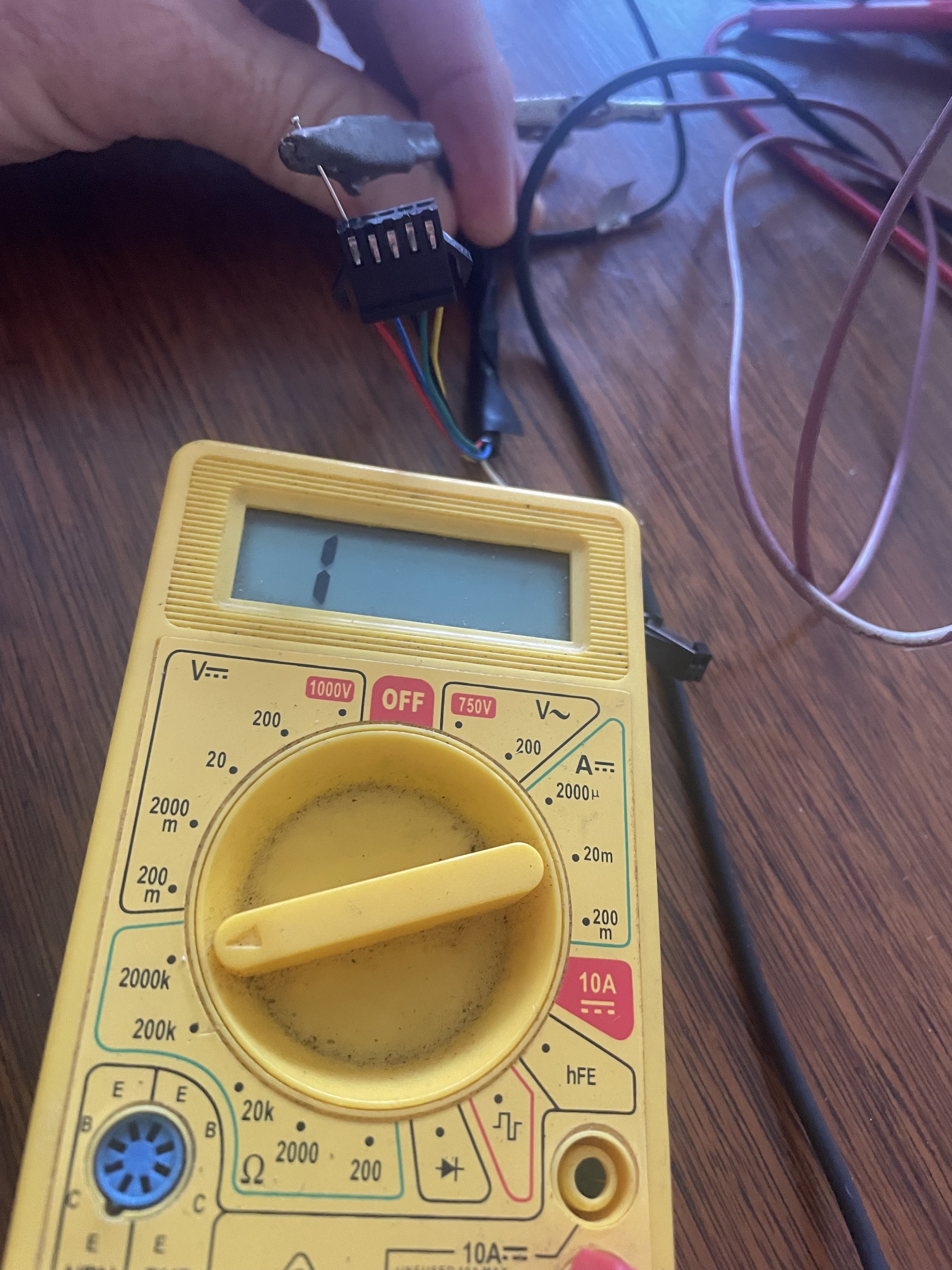

thanks. There are no error codes. I have disconnected the main cable so there is no power running through. Also disconnected from the brakes. The red and blue wire are connected ( continuity tested).
The problem. Unable to to turn on the bike from the lcd screen on button. Bike turns on if I disconnect and reconnect the lcd 5 pin plug or if I disconnect and reconnect the battery. Battery is fully charged and after a few minutes riding the battery level indicator goes down rapidly and then no power to motor. Voltmeter shows battery is still on 54v and hasn’t gone down. The bike will turn off from the lcd screen button. New lcd screen and new controller installed.
What you show and say are not at all clear. You show a 5-pin connector in photo 1. What is it on the other end of the wire? You also show a 1 into three cable, but they normally have a moulded round connector on the other end with 6, 7 or 8 pins depending on whether it has the connector for the throttle and separate lights function, not a flat 5-pin because the 5-pin has no brake signal wire. A 5-pin is:
Red - battery voltage
Black - ground
Blue - switched power for the controller
Green - Data receive
yellow - data send
Where's the wire for the brakes?????
If the flat 5-pin connector is on the controller and is for an LCD. The LCD shorts the red to the blue when you switch it on to provide power to the controller.
Did somebody modify something in the past because what you show is just wrong?

Thanks again. The brake wire is hidden behind my finger. It’s is a flat 5pin at one end with a 2 pin for the brakes (but just a single wire). The flat 5 pin and 2 pin connect to the controller. At the other end the green julet connects to the lcd and the 2 Red junkets connect to the brakes. Unknown if previous owners modified.
Hopefully this photo explains the connectors.

I'm thinking about your red and blue wires. How are you measuring the short? The result might be false. Try measuring the actual resistance between them to see if it has a high value. Those wires are connected to a MOSFET that switches them on and off. It's common for MOSFETs to leak a bit of charge.
Edited by saneagle
Thanks again for taking the time to reply: very much appreciated. The cable is removed from the bike and so not connected to anything and no voltage going through. I have attached 2 pics of the multimeter reading as I connect to the terminals. I’m sure they shouldn’t be showing this reading. I don’t think it’s a false reading.
That looks like 10k, which is in the right range - nearly an open circuit, not a short circuit. Whatever reading it shows on that scale when you touch the probes together would be a short circuit.
So presumably these 2 wires are connected in the julet socket and are supposed to be connected ?
One more time. The red wire is connected to the positive battery wire. It carries power up to the LCD for the LCD. When you switch on the LCD, a MOSFETis activated. It joins the red wire to the blue wire, so the power goes back down the blue wire for the controller. The LCD therefore switches on the controller as well as itself.
The MOSFET works like a relay or electronic switch with red one side and blue the other. When the switch is off, a very small amount of electric charge can leak through, like a water tap that doesn't seal properly.
I do understand about the red wire carrying a voltage to the lcd screen and making a connection with the blue when switched on. My issue at the moment is that the whole cable is removed from the bike and is sitting on me desk with no battery and no lcd screen attached yet the red and blue are showing they are connected ( no resistance ). This is why I thought the cable may be at fault. By the way battery terminal are just blades and look to be in good order.

Can you please explain which measurement you did that brought you to the conclusion that they're connected?
Even if they were connected by a dead short, it would make no difference to the function of the bike, since they must be 100% connected during operation. The only effect would be that your battery would run down very slowly when switched off.
A short between the red or blue and any of the other wires would be serious or fatal for the electrical system, but not between red and blue.
As I said before, you can test the bike without the cable and without the LCD by shorting the red and blue wires on the controller. That would eliminate any problem in the LCD or cable.

Ok. So initially I thought the cable may have a wire that was broken because at the hinge in the frame the cable had been squashed. So I removed the cable completely from the bike, no battery and no screen or controller connected and using the multimeter I attached one probe to each of the 5 pin hole terminals in the julet connector and the other probe again in turn to each of the 5 wires in the flat connector. I was simply testing for continuity. This is where I then found that red and blue wires are are connected, somewhere inside the cable.
