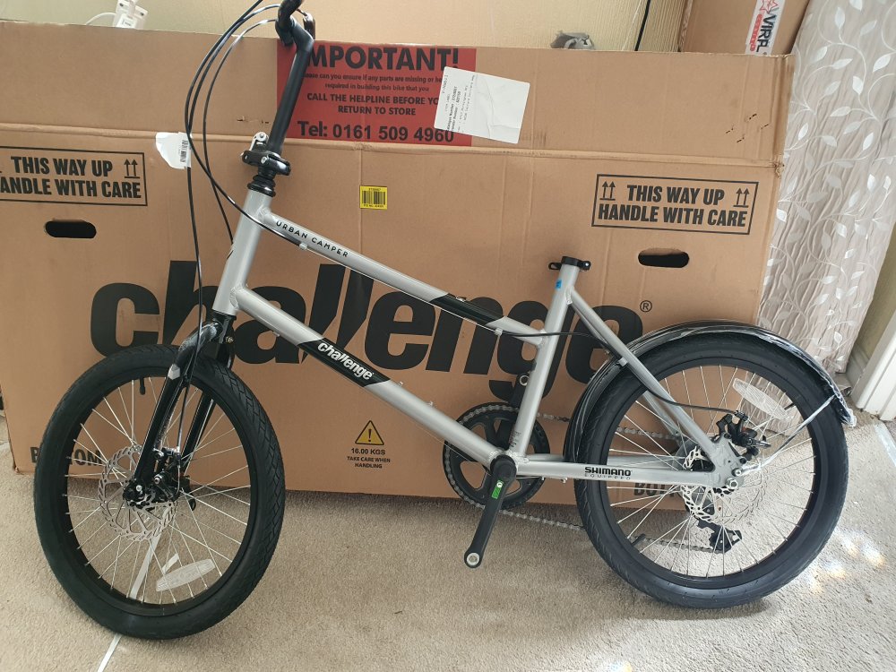

I collected this bike from Argos yesterday. It cost £120. Thanks to Waspy for pointing it out.

I'm a very happy chappy!
[ATTACH=full]64315[/ATTACH]

Are you really going to fit 3 front chainrings to a 20" urban bike?
Also, where's the front mudguard? I think the mudguards look cool on this bike, a good fit.
You guys are very sharp. It was £120. I'll fit the I will remove the inner chain ring to simplify the arrangement. there won't be a front derailleur, but at least I would have the option to hook the chain onto the inermediate ring if ever my battery went flat. I'll line it all up first and see how it looks.
