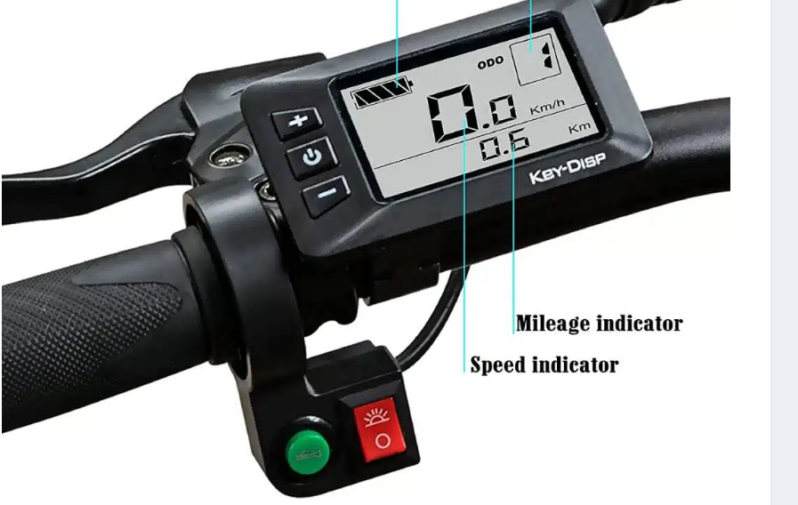

i found another bike on the internet which looks very much like my brothers bike with same lcd display...pls see the photos.
The lcd in your manual is different to the one on the bike and the menu is basic and different...the one on the bike is as shown in the photo....i was unable to get the battery level correct on the lcd display.

The photo doesn't shows just the screen, not the whole thing. What counts, though is what's written on the back.
11 minutes ago, daverave said:
D8vew sent me the link for this manual,
There are about 5 different control panels that share the same case, so they all look the same, but they're different inside. Try the one that Thelarkbox linked.
I never need a manual. They nearly always work the same and are logical. You press the two buttons within a few seconds of turning on to enter the settings menu. You scroll through the settings with the M or power button and you adjust the setting with the up and down buttons. When you see something that says 36, 48, Vol, or anything like that, you can adjust it or check that it's right.
The KT LCD7 is also the same but different. They have automatic voltage detection that can get messed up because there's an overlap between a 36v battery and a 48v one, where an empty 48v one is 40v and a fully charged 36v one is 42v. If the above doesn't solve anything, you need to remove your battery, short the two pins on the connector on the controller side to discharge any capacitors, wait a few minutes just for luck, then reconnect your battery. Obviously, if it's fully charged at 42v, it might get it wrong again, so you need to discharge it a bit.
