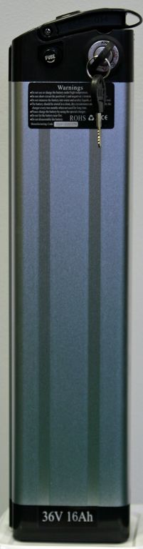

February 18, 201016 yr We, after careful thought, are sticking with Li-Ion. Our latest is 37V 17.4Ah and here is a photo. Huge current dumping capbility. Heat sink in a probust Al casing.
February 18, 201016 yr We, after careful thought, are sticking with Li-Ion. Our latest is 37V 17.4Ah and here is a photo. Huge current dumping capbility. Heat sink in a probust Al casing. Wow! A mighty meaty monster! Sounds like a good choice, but I imagine it's fairly heavy, though not as much as the twin batteries some companies and individuals use to gain capacity. .
