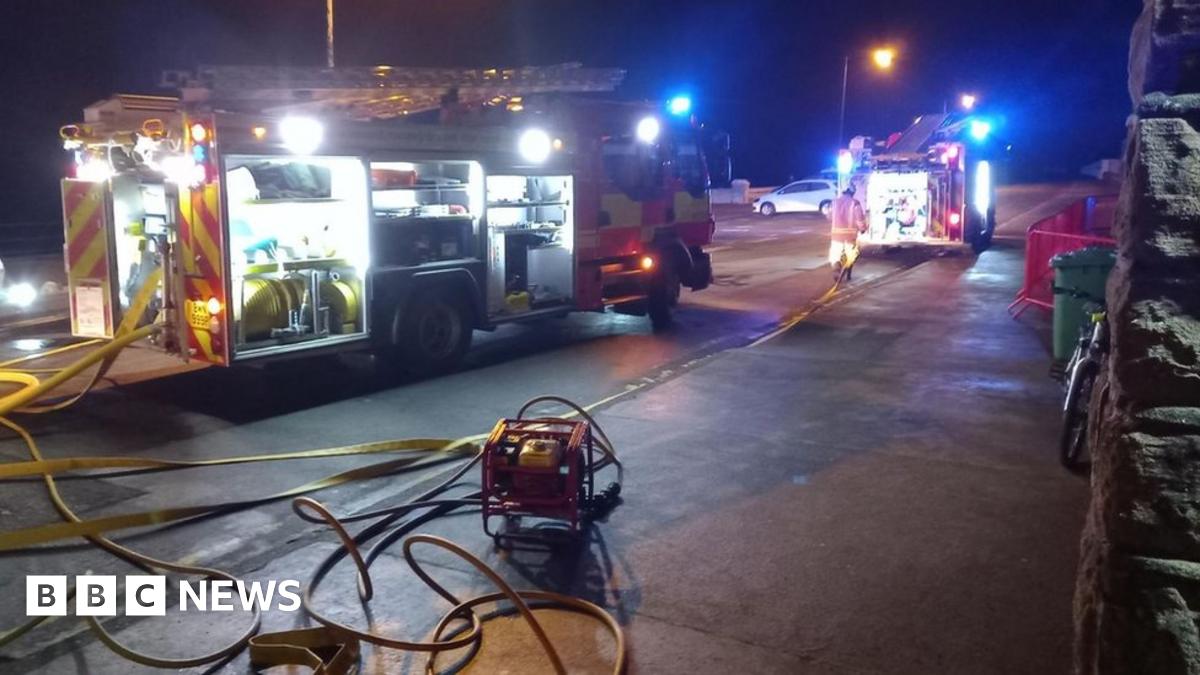

...but are they less likely to burst into flames, than a pack made with cheap new Chinese cells?
Another useless ebike fire article with no detail and of the two images, one is a fire engine and the other is where the ebike used to be. There is a bike in the image of the fire engine but no signs of issues with it and a different location to the wall with burn marks. However to include a different bike in the photo is confusing but that is what they seem to have done. Maybe I'm wrong but I would of thought pretty much 100% of people reading an article on ebike fires want to see an image of the ebike which ignited even if its an aluminium framed ebike and just a pile of ash after the fire.
10,274
3,007
Perhaps the BBC didn't pay the copyright holder for rights to use the burned bike's photos? Looks like a Volt ebike with a hub drive.
Looks like it's the Volt Alpine which I can find reference to all the way back to 2014. So could be a very old ebike with a very heavily used battery. The bike looks to good quality components. So this is more a old bike failing than a dangerous cheap model. Maybe that is worth thinking about how long we should use batteries for, maybe there is a point where even good quality batteries may fail after excessive use. I mean in theory the manufacturing date for this bike could be close to 10 years old if an early Alpine model. Alternatively maybe the charger failed and was replaced with the wrong charger or maybe its just wear and tear or something shorted out due to rain water getting somewhere it shouldn't, a worn seal maybe.
So despite the BBC getting billions from forced taxation and paying newsreaders £270k a few pennies to use an image is too much for them. Also aren't the BBC meant to have a lot of local reporters for such articles (they claim) so surely one of those could take their own image a lot of the time. I realise this is just a general news report that the BBC probably buy in and the only BBC bit is to rewrite the copy and chuck in a few images. Cheap journalism.
