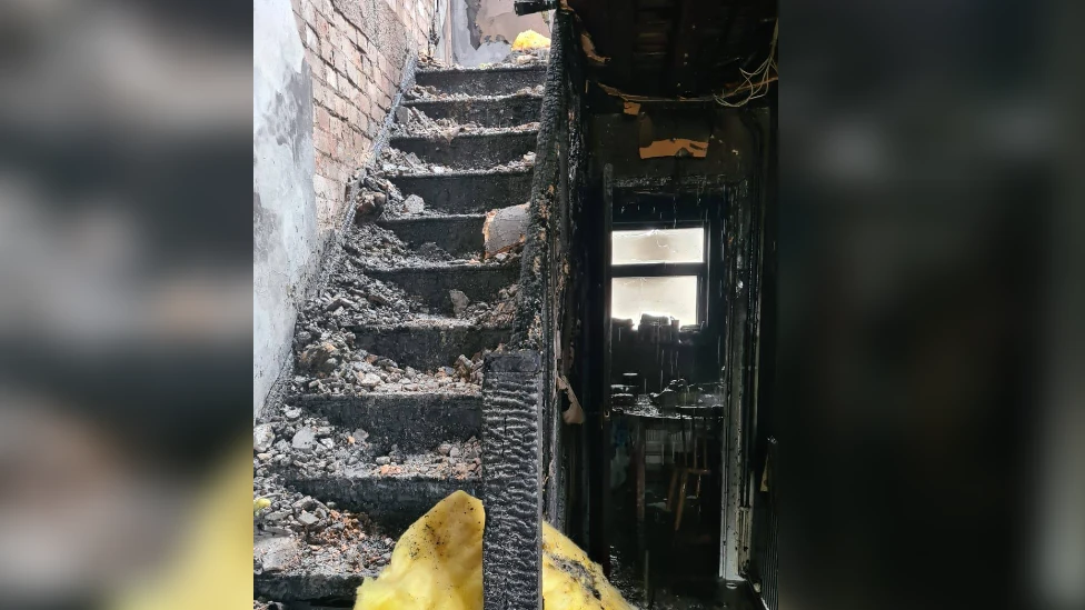

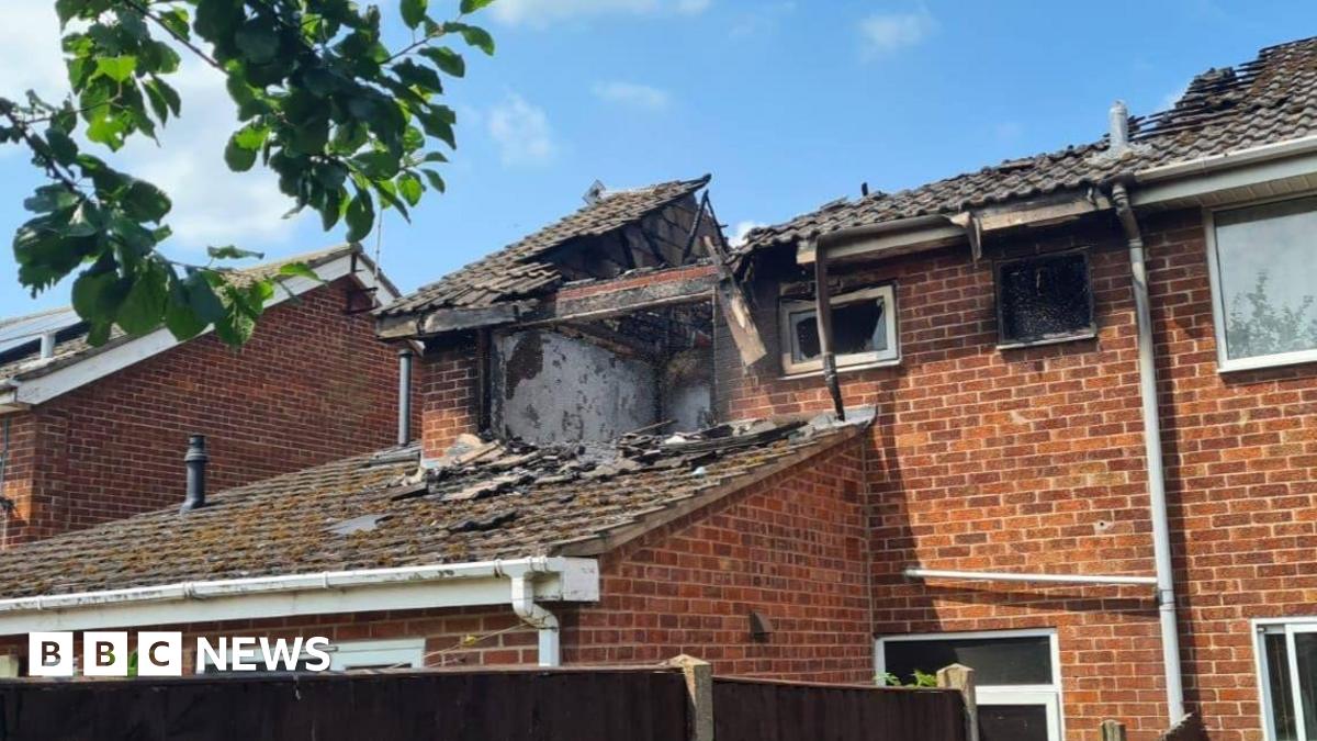

Midland fire chiefs make 'prevent tragedy call' amid shocking rise in one type of blaze
The West Midlands has seen a 50 per cent increase in fires linked to lithium-ion batteries in e-bikes and e-scooters in two years
