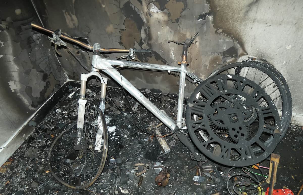

Swindon house fires caused by e-bikes spark urgent warning
Conversion kits can be sourced online from as little as £50 on eBay – but often don’t have safety features installed to prevent fires.
I find that unlikely.
Looking at the picture how do they know it wasn't the clock to blame. Can't trust clocks. Harbingers of doom.
