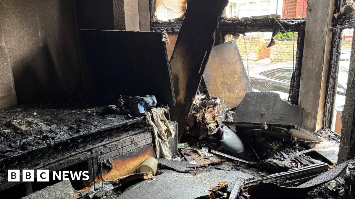

Charging Ebike battery fire from three days ago (July 19) in Hanwell west London.
