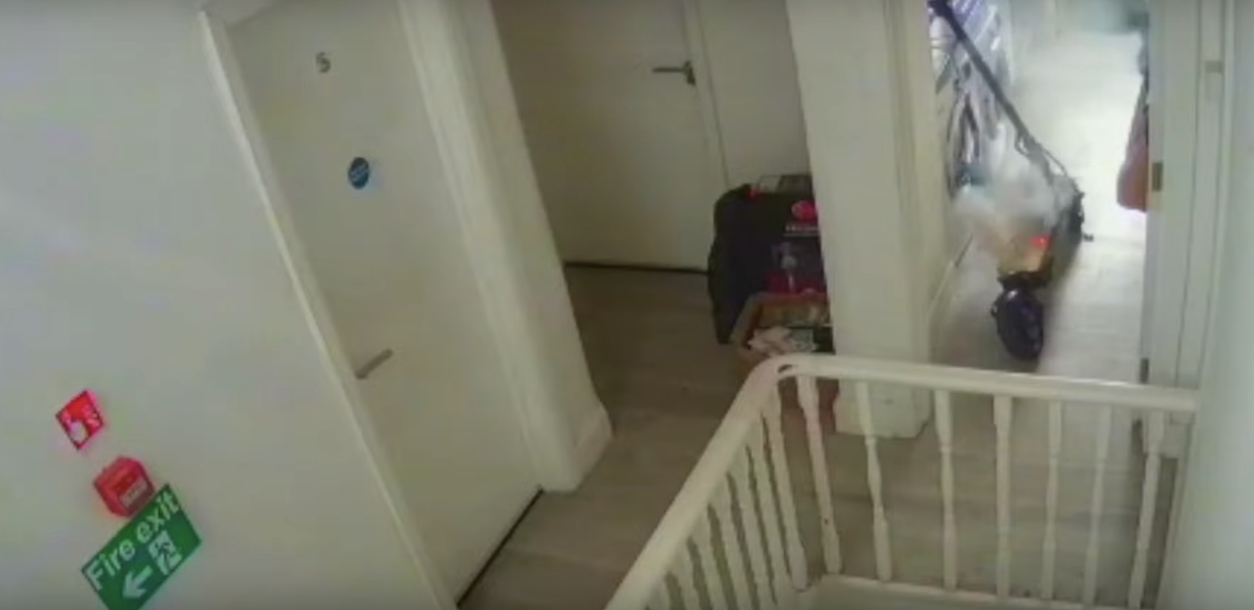

"Kent Fire and Rescue Service believe that the fire in St Margaret's Banks on July 18th was started when sunlight bounced off a vanity mirror and onto the pair's bedroom curtains. "
