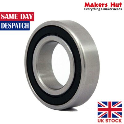

Bearings are easy to replace once you have the right one. The bearing casing has a seal on both sides and it has the bearing size embossed, use a magnifying glass to read it.

Bafang SWX02 hub that's the easy bit.
You need to remove the face plate if it is the end plate bearing that is worn or rough.
Once the bearing can clearly bee seen wipe the face clean and there should be a part number embossed on the seal.
It will read somewhere along the lines like 6002rs or 6904rs, it has to be correct so just don't buy anyone, once you know the number order from ebay.
