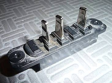

If I was to purchase the 36V10Ah Li-Ion Alloy 05-Case EBike Battery Pack from America I would have to make up a 24" cable from rear rack to battery, what kind of cable couplings would I require.
here is a photo of the set up on the bike where the battery goes

meant 24" cable from rear rack to connector on the bike, sorry
connector on bike shown

45,928
22,570
I don't know of any connectors suitable for plugging onto those thin blade connectors Rob. The usual way of adding a different battery is to connect floating cables onto the underside of that connector platform and then using inline connectors to plug onto the cables from the battery.
There are various inline connectors that are suitable, one type often recommended are the Anderson Powerpoles. This Google link shows everything about those. Others may have different connector suggestions.
You should easily be able to access the underside of the connector platform to connect in parallel to the existing cables, it's a type Giant and Panasonic have used for years, below is a later example. This one uses plug-on connectors underneath but yours may be soldered connections:

I have looked inside, only two small studs to remove, they are plugins and I have had a look at the Anderson couplings.
