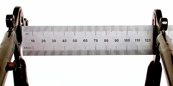

how do i also find out what size my rear drop outs are?
It is usually 135mm.
You can use a motor that has the same dropout or +/- up to 5mm.
This is because you can re-arrange the antitorque washers that come with the motor to make up the difference.
In the picture below, the dropout is 127mm.
