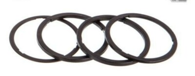

Any hollow tech 11 bottom bracket spacer should work for a BBS.
