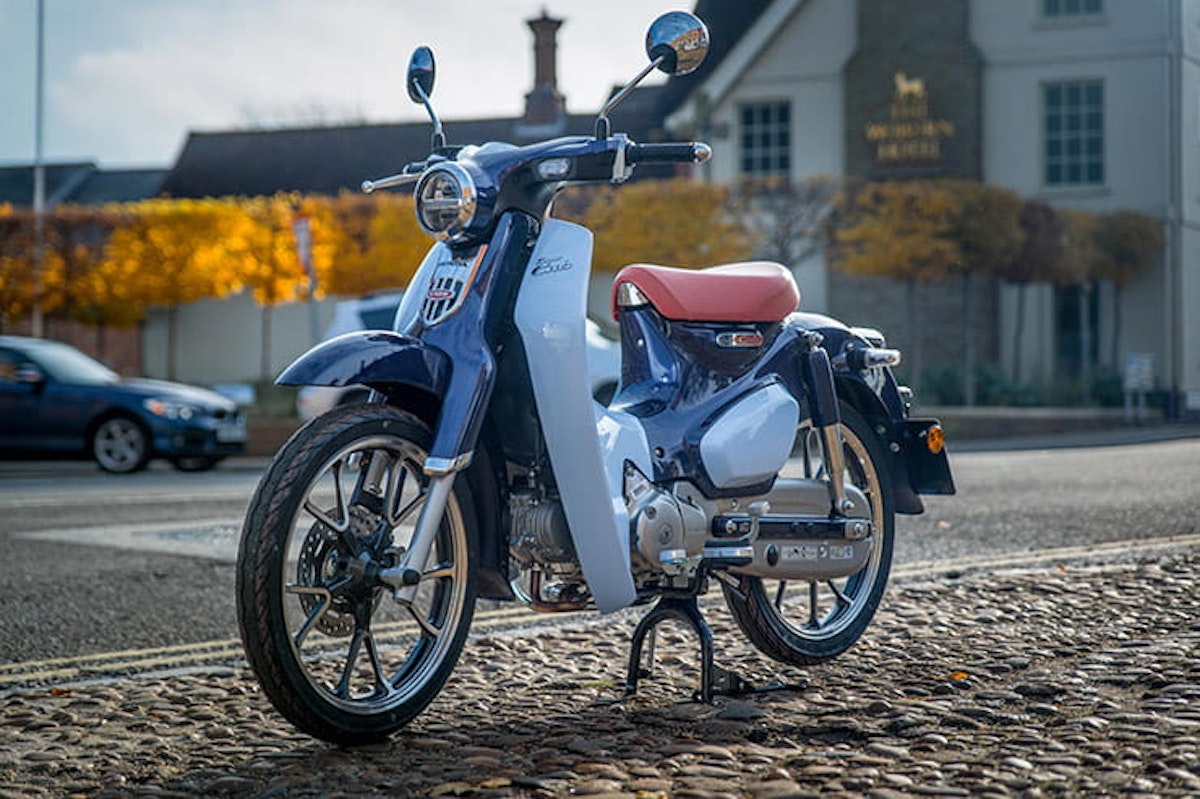

60 mile round trip a day regular commute on a folder mmmmm
Might want to consider a Honda C125
Well tbh it's 30 but just wanted to make sure that it could definitely do that range! Tbf I'd probably actually use human power for a fair bit, but just wanted the option of cycling all the way by motor
