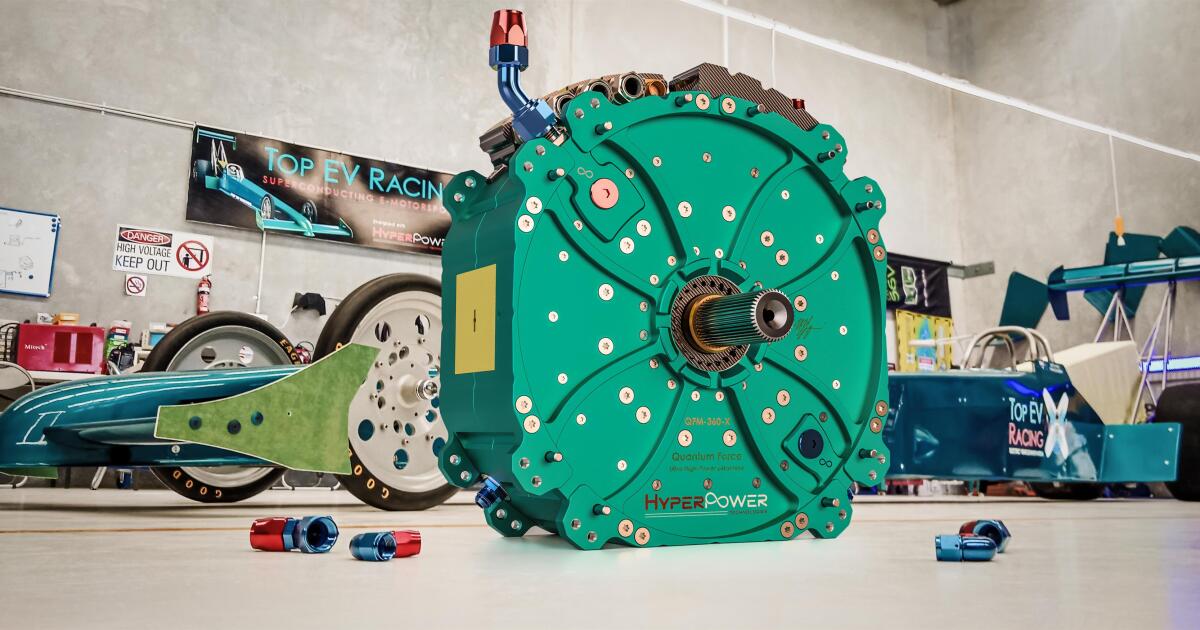

that will kick a sur rons ass , it will also destroy everything at warp speed some one should put one in a washing machine with some bricks in it :p

wont go very far going 200mph tho will it battle bots has a 3 min limit cos the batts are shite.
4-500amp 52v limit i think tho you can run the amps as high as you can but wepon speed must not be faster than 250mph.
if you have a batt to run at 52v and 5000 amps it will be like 8000nm and would destroy everything :p
you want you tube views you blow $hit up or risk ur life :p
