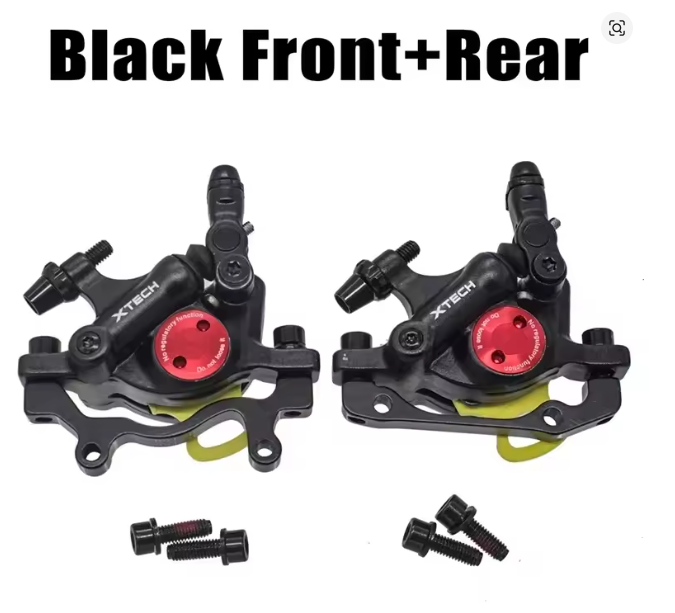

So, today's episode is about the brakes.

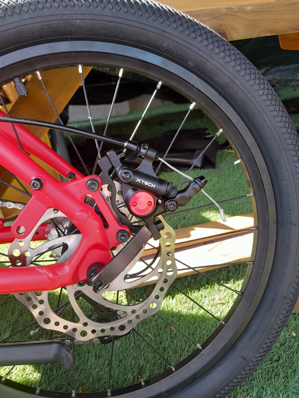

This is what I bought from Ali Express, cable operated hydraulic calipers, all the hydraulic fluid is contained in the calipers themselves.
These have been discussed on this forum many times before and the general opinion is that they are a massive improvement over mechanical disc brakes and I have to say I'd agree with that.
Someone pointed out that because of the very small amount of hydraulic fluid involved there is a danger that if you were going downhill at 45MPH and braking hard, the heat could cause the fluid to boil, leading to brake failure. Now, as I have no intention of entering the Tour de France on a 20" folder, I think I'll be alright.

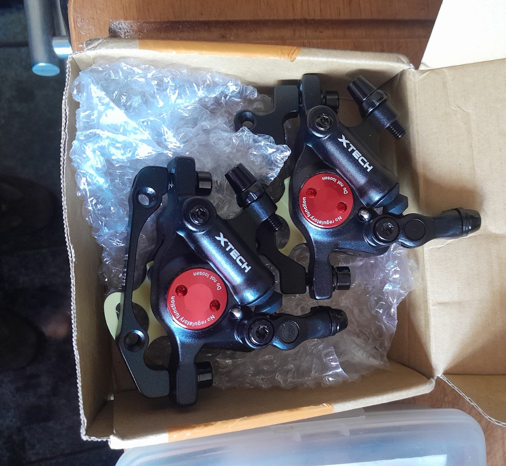

So then this small box of Chinese goodness arrived:
Tip No. 1: Have this picture on your phone when assembling the brakes, so you don't get in a muddle about which way the caliper adaptors go on:

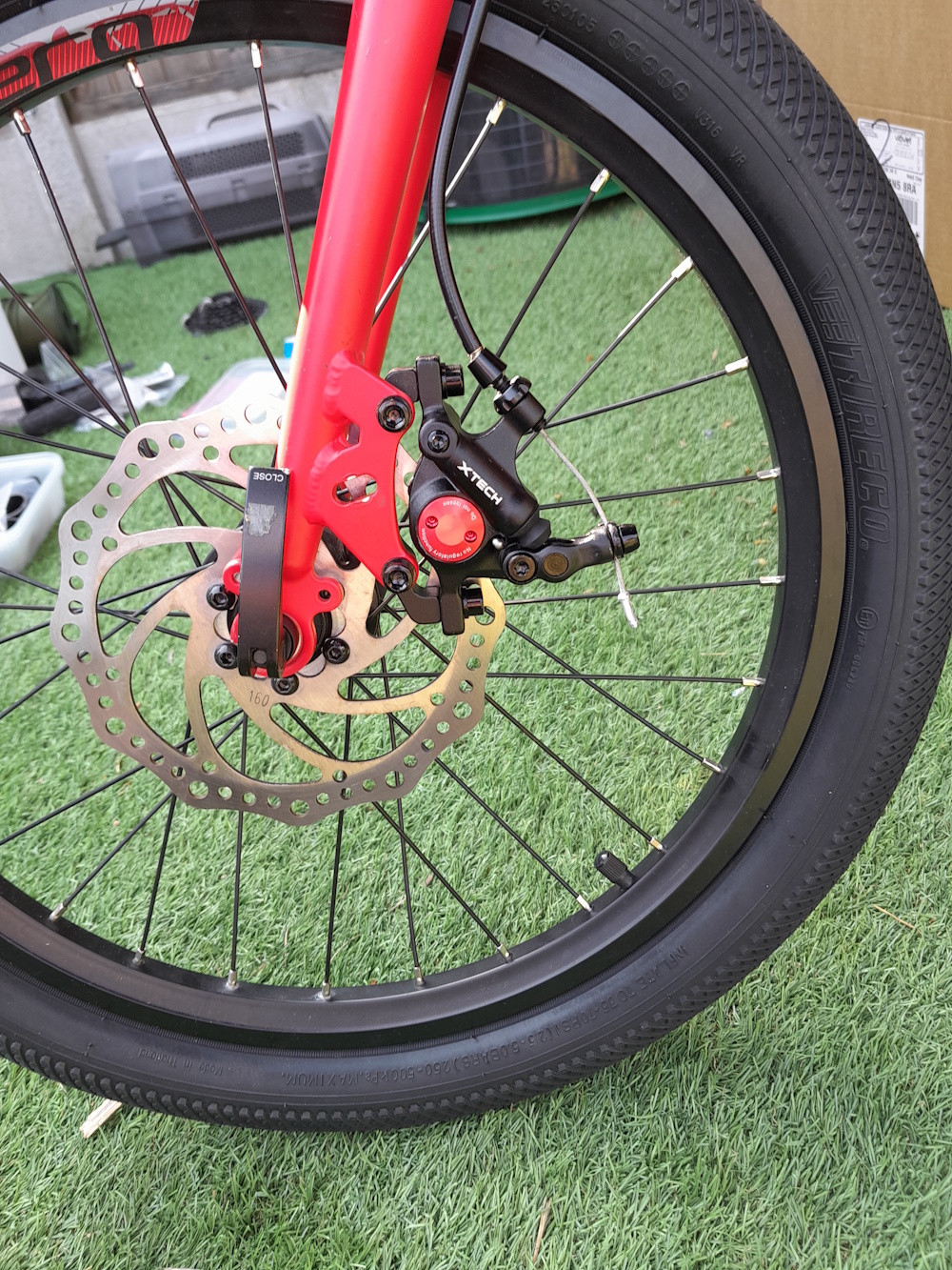

Front brake fitted:
Rear brake fitted:

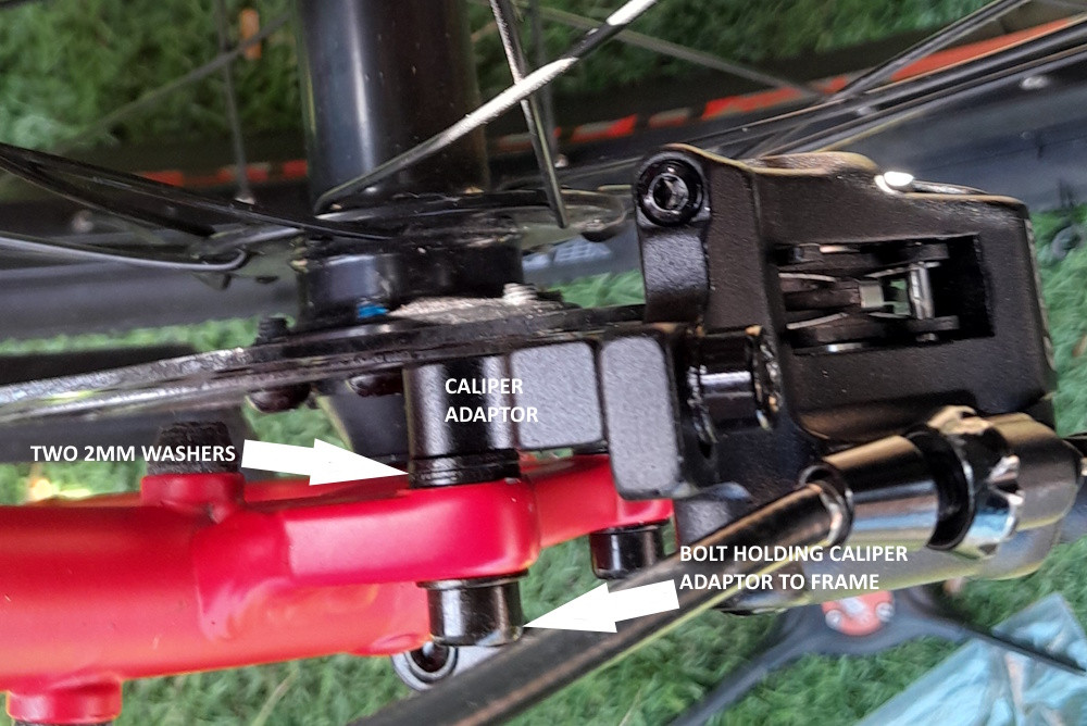

Tip No. 2: The front brake was a doddle to fit, but the rear one gave me slight problems. The caliper would not line-up with the disc. This was solved by fitting two 2mm washers on each of the bolts between the frame and the caliper adaptor, thereby moving the whole caliper and adaptor 4mm inboard.
Both brakes in situ:

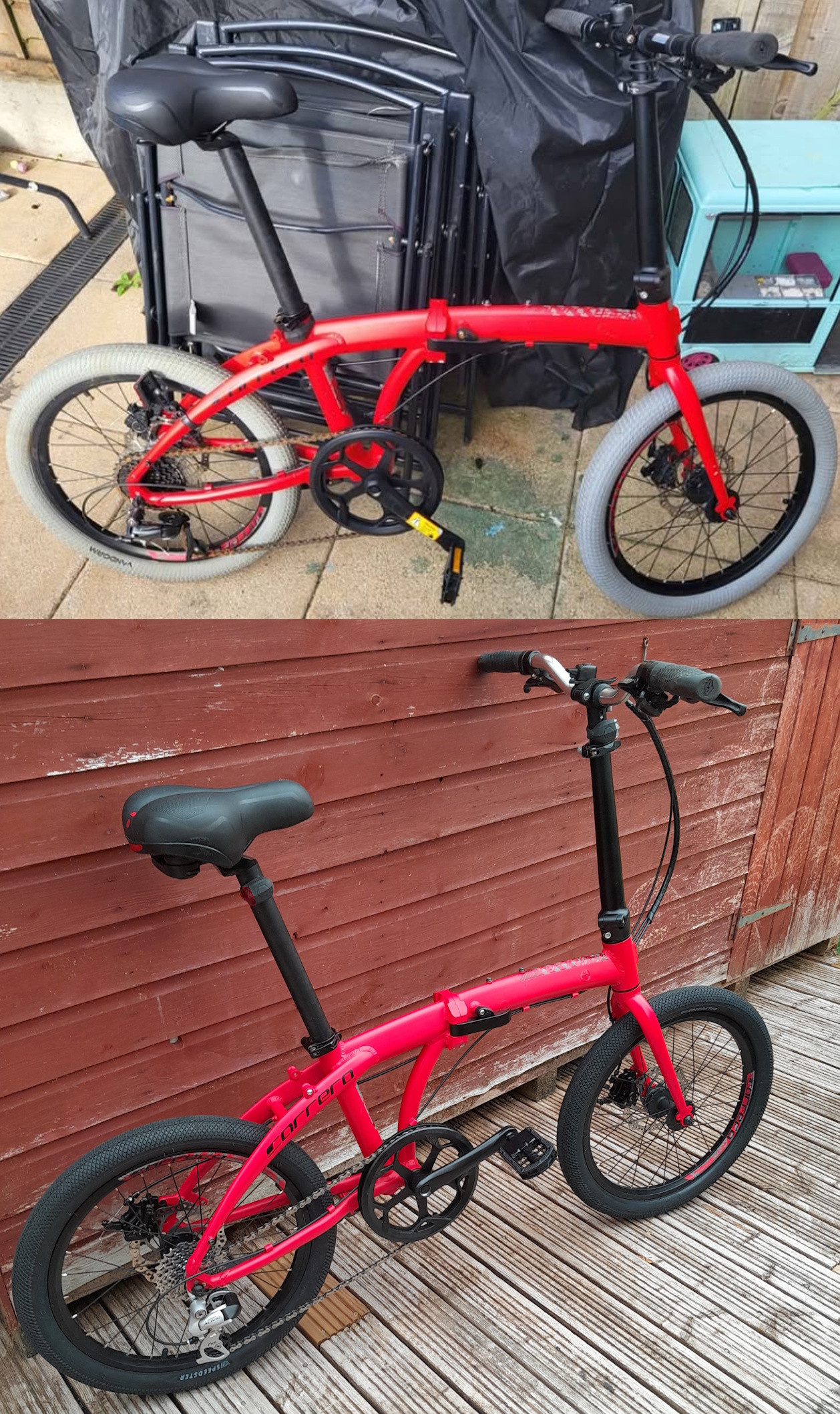

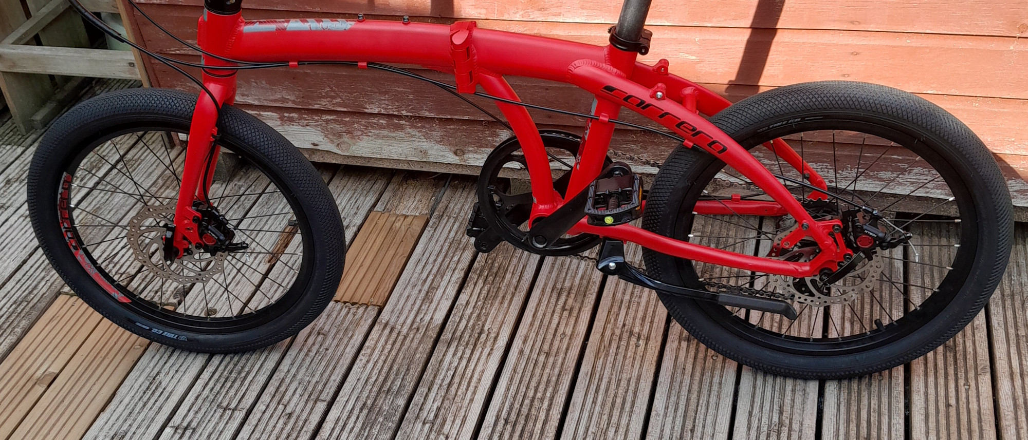

So the bike is now just about finished (just waiting for the magnetic latch to arrive) and ready for the fitting of the electric conversion stuff, which should be arriving today. And then will come the big decision about which battery and where to fit it.
Here's a before and after picture for your viewing pleasure:

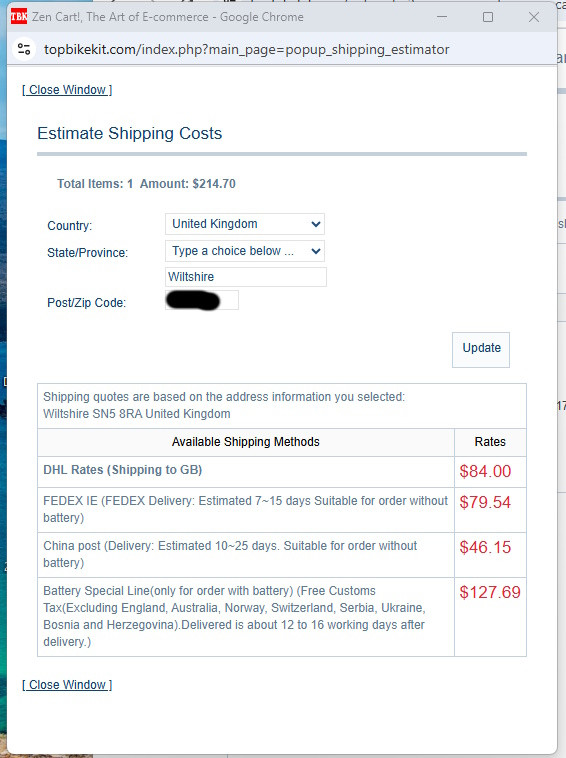

So may I ask which shipping method you chose please?
9,136
4,078
Even with batteries ?
I don't buy batteries from China. It's more convenient to get them from Greenlance, Yose and PSWpower, who have European warehouses.

I always select China Post because it the cheapest. It comes pretty quick anyway. If you're buying from Topbikekit, don't forget the KT controller and stuff to go with it.

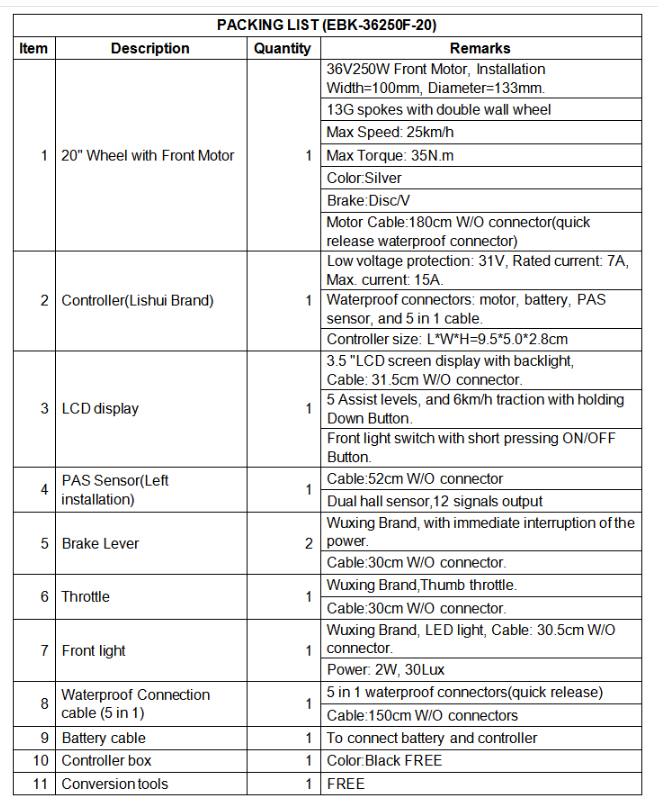

Err.... I've already ordered the Yosepower 20" front conversion kit (minus battery) which comes with a Lishui controller. £134 shipped. It should be arriving today.
I know you and other knowledgeable people here always recommend KT controllers, but I have a Lishui controller on my Trek and I'm very happy with it.
I'm a simple man who like simple things, with the Lishui controller you just go in the LCD menu once, set the wheel size and max speed and you're done, never have to touch it again.
From what I've read on this forum KT controllers come with about a billion different permutations of settings written in some secret code that Alan Turing would struggle with.
Anyway, it's done now but I always appreciate your advice mate. It's just that compared to you, I'm a bit thick :D

That's a shame. The Lishui ones are crap, especially on a bike with small wheels. You can't control the power, and it becomes like a moped. I get that every time I visit my sister and borrow her Woosh Rambletta. Whatever level you select, the bike goes straight up to that speed with full power. The small wheels multiply the torque, so it's power on or off. You can't choose how hard to pedal. That effect is not so bad on bikes with big wheels because of the lower torque.
As the postage from TBK is already covered on the battery, the KT controller stuff would be very cheap. I'd be tempted to get it anyway, maybe for a future project, or use it on this one and put the Lishui on the future project (big wheels).
