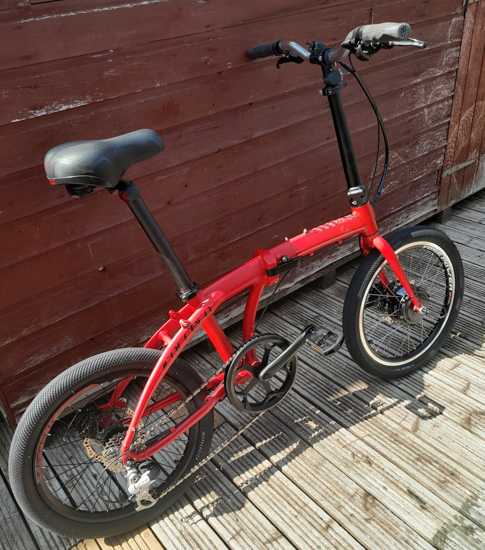

Chinese 20" wheels are always 406mm, but it's just as well to check. I converted a Raleigh 20 that had 251mm rims and rim brakes. 45mm difference is massive. Unfortunately, I didn't realise the problem until the wheel was built the first time with a 406mm rim. The brake wouldn't adjust that far and it didn't look right with odd sized wheels. I couldn't get a ready built motor wheel in that size, so I had to get a bare motor and build my own wheel. I also had to rebuild the rear wheel to match, and it had SA 3-speed gears with a dynohub, so the spokes were different on each side.
Before:
64014
After (11 years ago before we had nice batteries):
64015
