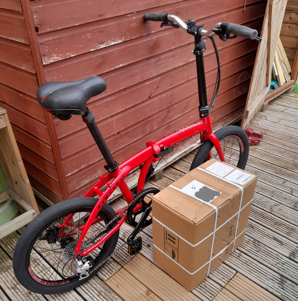

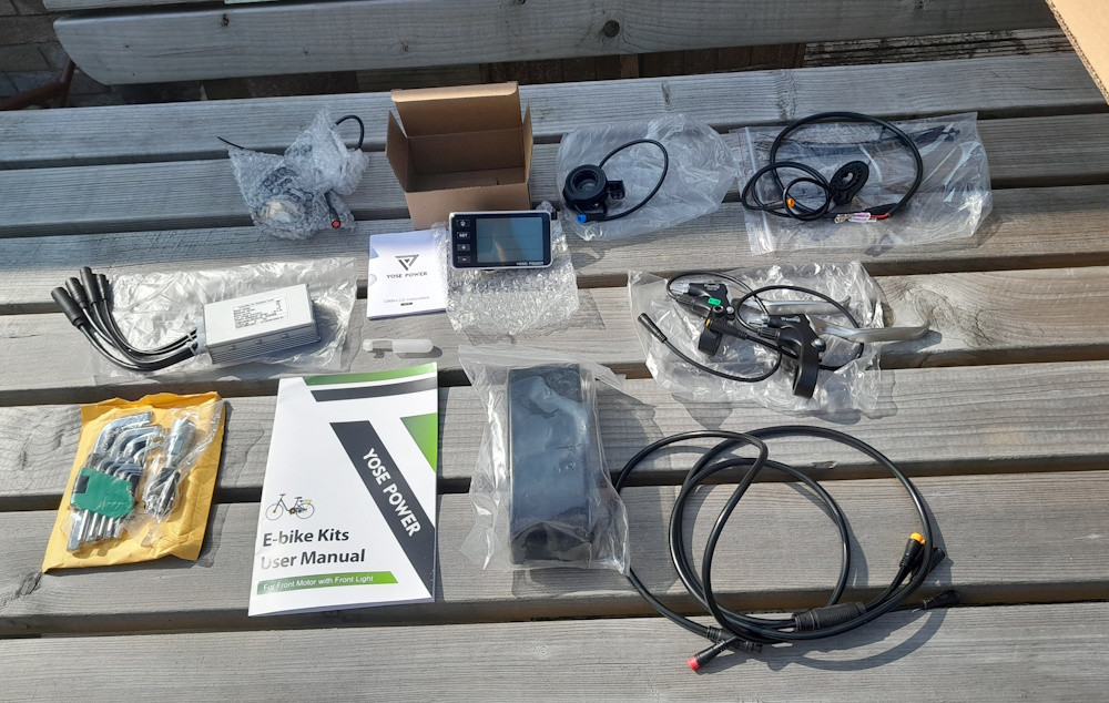

OK so a new day, the sun is shining, time to open the Yosepower box.
These were the contents - minus the motor wheel and the 9 pin extension cable, the reasons for which shall become apparent shortly.
Most of these parts I have no actual use for, I don't use throttles or brake sensors plus I have my stuff arriving from TBK soon. I guess it either goes on eBay or gets added to my box of bits.

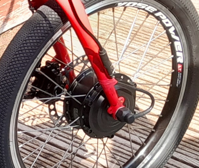

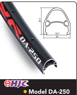

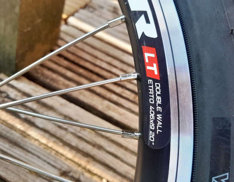

I emailed Yosepower before I ordered and specifically asked if the rim was 406 because I wanted to fit 20x2.0 tyres. They replied, the tyres "should" fit. To be fair they did attach a picture of the rim dimensions which were within 406 parameters.

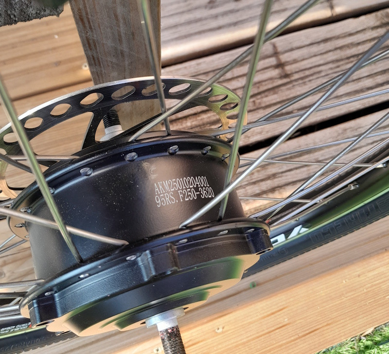

On getting the wheel out of the box, it says right there on the rim - 406!

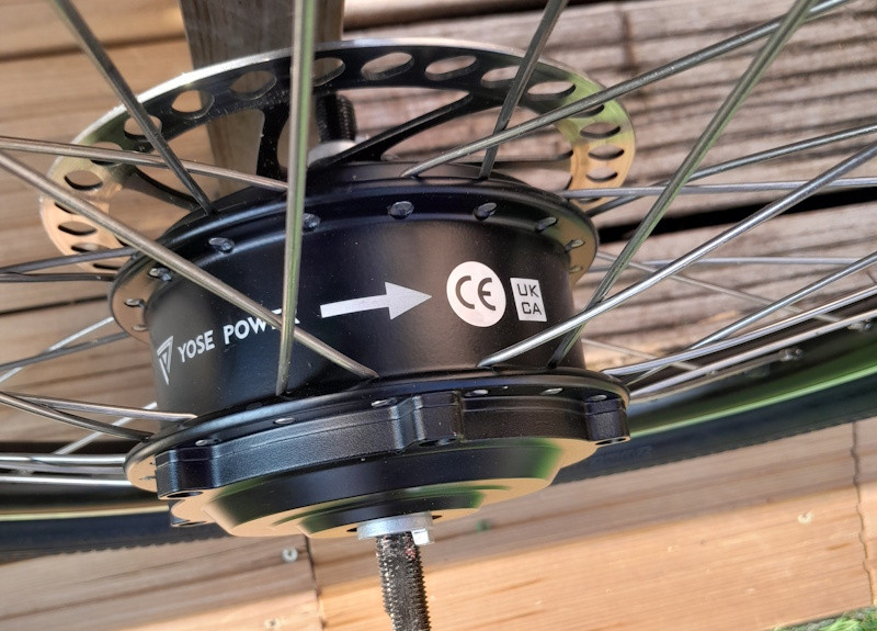

This is all the labelling you get on the motor, so not UK legal then!
So once again I have had to make my own label, which will be getting attached to the motor toot suite.

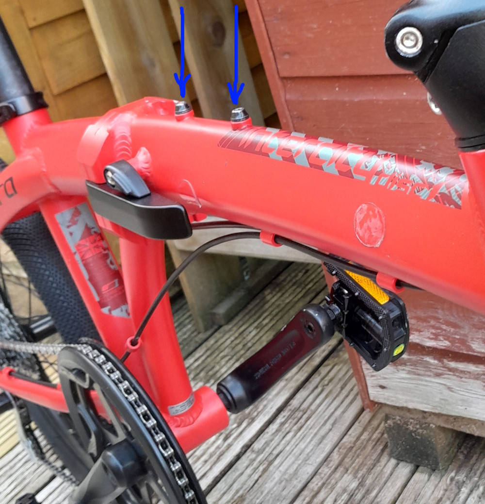

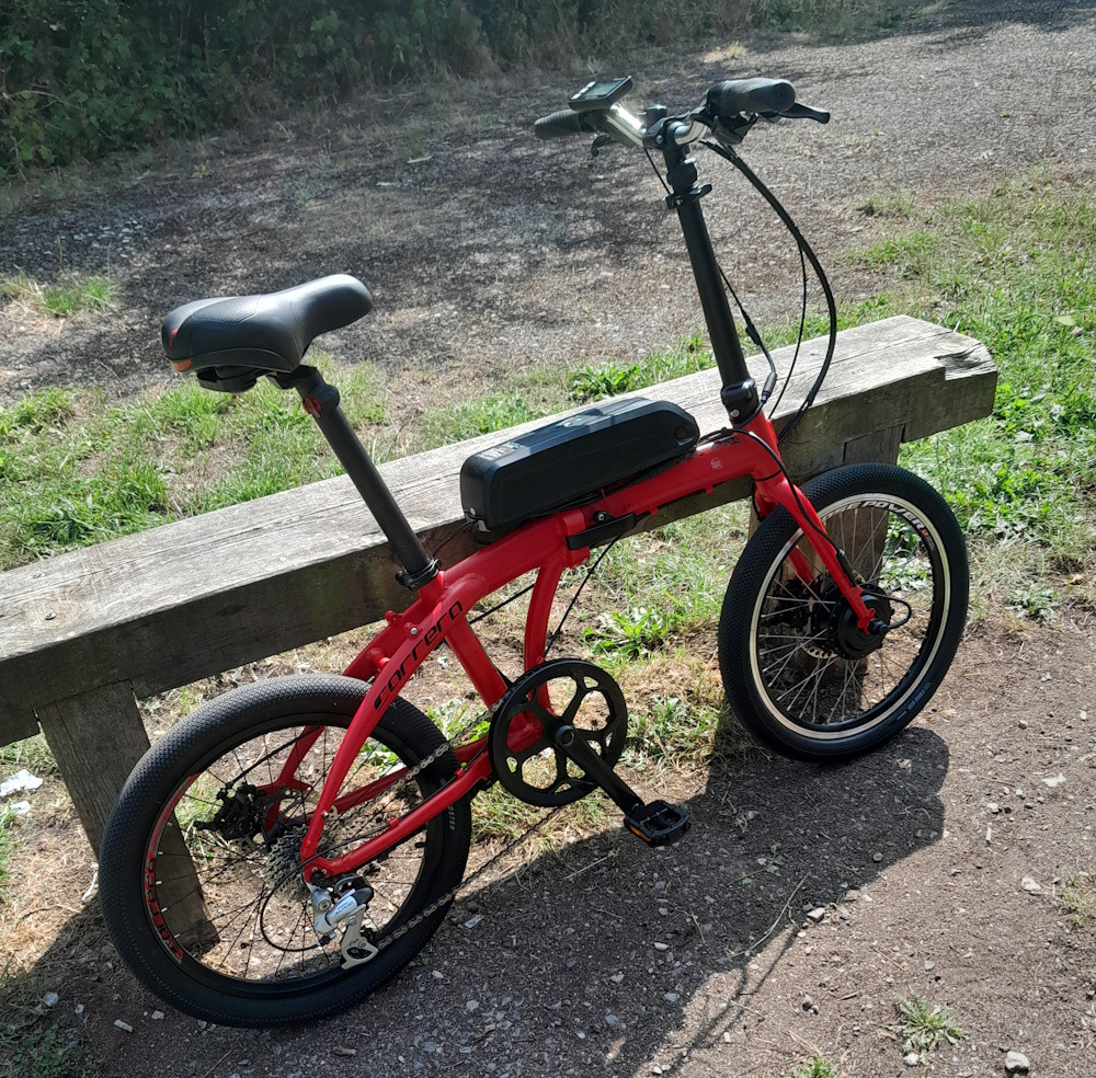

So, I observed that there are two M5 rivnuts on the frame in a very useful place, so just for fun I stripped all the electrics (bar the motor) from my Trek and fitted them to the Carrera. This leaves all the Yosepower bits unused (apart from the 9 pin extension cable, which I had to use on the Carrera) which may help if I come to sell them.

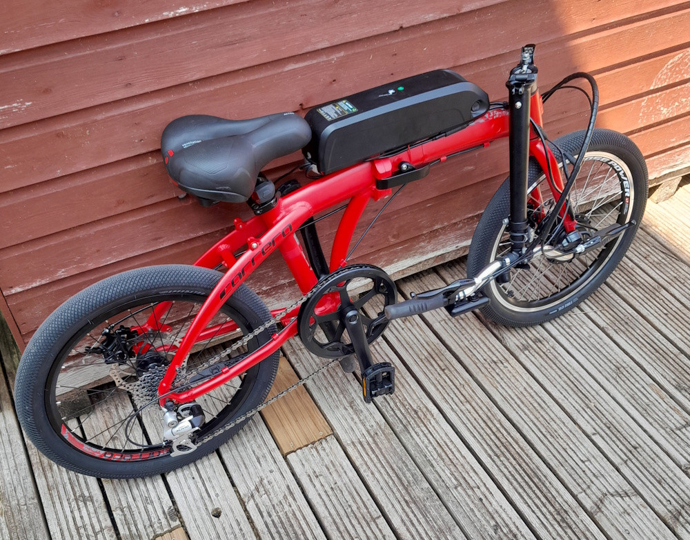

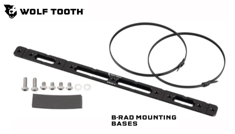

I had one of these Wolf Tooth mounts in my box of bits, which enabled me to attach the battery cradle to the frame. The Wolf Tooth is attached by two screws, the battery is attached to cradle by three screws. I think that if this was a permanent job, I would also add cable ties or velcro straps to fix the battery cradle to frame more securely.
One slight problem is the fork drop outs are nearly horizontal, so I was not able to create much of a drip-loop. Doesn't really matter, I don't cycle on rainy days anyway.

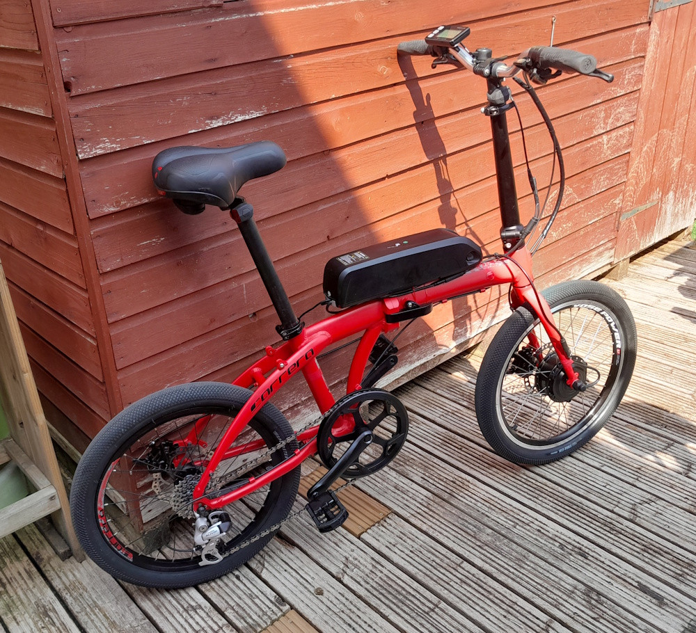

So, I took it out for a test drive to the local park and it all works really well, who knew 20" bikes could be such fun?
This is about as folded as the bike gets, and the battery can easily be removed as well of course. So not exactly a folder any more then but still much easier to get in and out of a car than a full size mountain bike.
And, anyway, when my box of goodies arrives from TBK and gets fitted it will be back to a full folder again.

It's engraved as an AKM250 although I agree that adding a 'W' would have been helpful.
Yes!
I have that problem on my BBS01. I don't look forward to arguing it out with some keen young Gestapo officer at the side of the road.
The motor engraving says 'Mm340.250' and some letters - most unhelpful.
I have affixed an after market Bafang sticker to the frame which carries the legally required information.
Had it not been for the vast amount of irresponsible riding and ridiculous excess power and speed of many many conversions, i would never have had to worry about the motor markings. Four years ago, no one was ever likely to be stopped unless riding dangerously. Not any more.

I don't get the problem with the rim. You asked for 406mm, they confirmed 406mm, 406 mm arrived, but you can't use it?
There is no problem with the rim. As you will know, 20" wheels come in two sizes 406 (far fatter tyres) and 451 (for skinny tyres). I learnt this from Peter.Bridge because he says the Carrera Intercity Disc 9 has 451 rims which only accept skinny tyres. (I did not know that 406 meant millimetres).
Google says this about 406 rims:
"Rim Width: Can vary, with common widths including 25mm and 19mm"
I asked Yose power if their 20" kits definitely had 406 rims because I wanted to fit chunky tyres. He appeared to have never heard of the term '406' but he said fatter tyres "should" fit and he sent me a picture of the rim dimensions.
So I was surprised when the wheel arrived and it clearly states on the rim "406". Which he (the guy at Yose Power) should have known, I mean it's their product after all.
And yes, I can use it, it fits the bike and my 20x2.0 tyre perfectly.
I apologise if my post was confusing, I should have been clearer.
Here's the picture the guy at Yose Power sent me. The dimensions fit within what Google says a 406 rim should be...see above.
To be fair to Yose Power, they answer email quickly and they try to be helpful.

I didn't even notice the bottom bit. The first 250 might be coincidence.
95RS F250-3620
Model number, Front, 250W, 36V, 20"
Neither did I, Neither would Plod.
Also no mention of maximum assist speed, which is a legal requirement on labelling of eBikes and conversion kits.
