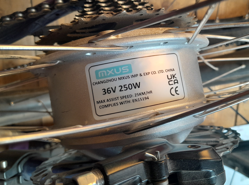

Motor labelled and ready to go:
The motor itself is labelled. The bike isn't - yet. I know it needs to state the speed limit and also the manufacturer, but who the hell is that? AKM (the motor), Carrera or me?
The label on the motor looks good to me. Similar to my homemade label for my Mxus motor.
As far as I'm aware a factory ebike should have a label on the frame, listing name manufacturer of bike, voltage (48v max), wattage (250 max) and max assist speed.
But with conversion kits the label with this information should be on the motor, but obviously name of manufacturer should be the motor manufacturer.
I'm a bit unsure if you need the max assist speed on the label of the motor, but it would do no harm to have it on there.
This is mine (after several attempts).
