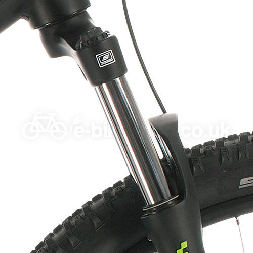

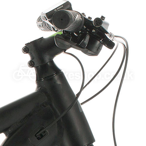

or the Cube Acid Hybrid One 2020
Cube Acid Hybrid One 500 2020 Bosch
Cube Acid Hybrid One 500 2020 BoschCube Acid Hybrid One 500 2020 BoschCube Acid Hybrid One 500 2020 BoschCube Acid Hybrid One 500 2020 BoschCube Acid Hybrid One 500 2020 BoschCube Acid Hybrid One 500 2020 BoschCube Acid Hybrid One 500 2020 BoschCube Acid Hybrid One 500 2020 BoschCube Acid Hybrid One 500 2020 Bosch
Range
Range
30 - 140 Power
Assisted Miles*
Motor
Motor
Bosch 250w Crank
Drive G3 Performance
Battery
Battery
Bosch 500Wh
PowerPack 36v
Speed
Speed
Electric Assistance
up to 15 mph
My question is can a throttle easily be retro fitted to the controller circuitry ( plug and play)
to enable me to use bike in the same way as I have been riding my previous bike. I am a retired electrician so if it is possible I'm sure I have the competance to perform the work required.
