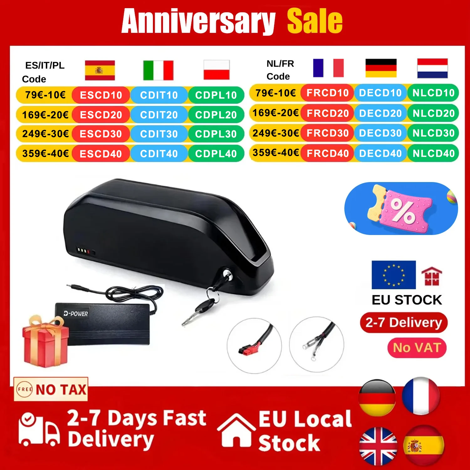

thanks ive found this ones on aliexpress they should be all right with all the informations i have now, chatgbt said everything is compatible and by looking at reviews this have the most and pretty good ones aswell
1st link is the wheel CSC Electric bicycle kit 36V 250w freewheel
2nd link is battery Electric Bicycle Battery Hailong 21700 18650 Cells Pack 36V 13Ah
3rd link also this battery has good sales aswell
will let you know what i get told by pswp or yose i already messaged them

That kit looks OK. They show KT controllers in the photo list, but they don't give the option to select them. It might be asking them if they can supply the kit with a 15A KT controller and LCD3, which are significantly better than the SW900 one that you can select.
