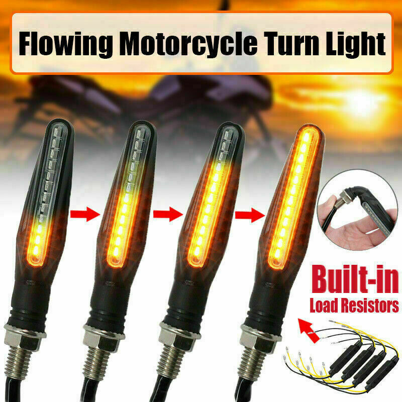

Sounds like a good idea @AGS , this end a couple of things have arrived from my great ebay buy everything session, the amber and red neon led strips, as well as 4 x el cheapo motorcycle indicators that require No flasser unit, they use a led meter effect just need 10-14v..
So I have mounted the m/c indicators on bars to hang off my front and rear boxes, and cut and wired lengths of orange neon led to sit under the box lips left and right front and rear. The neon leds will be flashed by a seperate 12v flasher unit with a 'tunning' knoob, so with luck i may get them in sync with the m/c indicators..

You can sync your additional orange lights by taking a wire from the main flashers to toggle a MOSFET to turn power on and off to the extra ones.
If the power 'flashed' yeah, but it doesn't, think uv meter ranging from 0 to 100 to 0 to 100 etc when supplied with 12v, knight rider or zylon eye style led.. am i showing my age??
@ less than £7 for 4x it had to be worth a punt..
