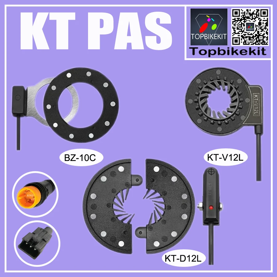

I have only had a quick look at these products
This is were I got the PAS I am using from, this is the KT PAS I purchased - looks cheap but delivery will cost!

These are the links:
I just noticed these are both Topbikekit products on their aliexpress account lol if you are buying a new PAS I recommend the KT-D12L the one I have, it is near enough universal fitting; some have mentioned having to modify parts in the crank or bottom bracket to fit the YOSE standard PAS, thinking of your full suspension idea.

PC2017 YOSE are sending a new pas sensor so i will wait to try that before cutting any plugs of, but i am going to order the controller and will go with your recommendation of the KT-D12L pas sensor as it is good for a hollowtech crank, i just haven't got round to it yet work and playing in kayaks got in the way. cheers for the information and to the others people on this thread that have contributed to my e bike learning as limited as it is.
