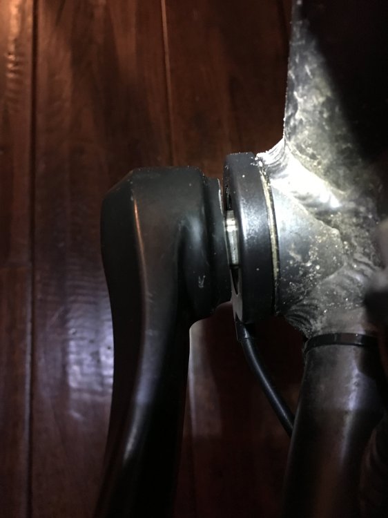

Or you can go at it a bit heath robinson, with a hacksaw and file cut off a bit of the inside edge of the pedal. mines been like this for over a year now and did the job:
