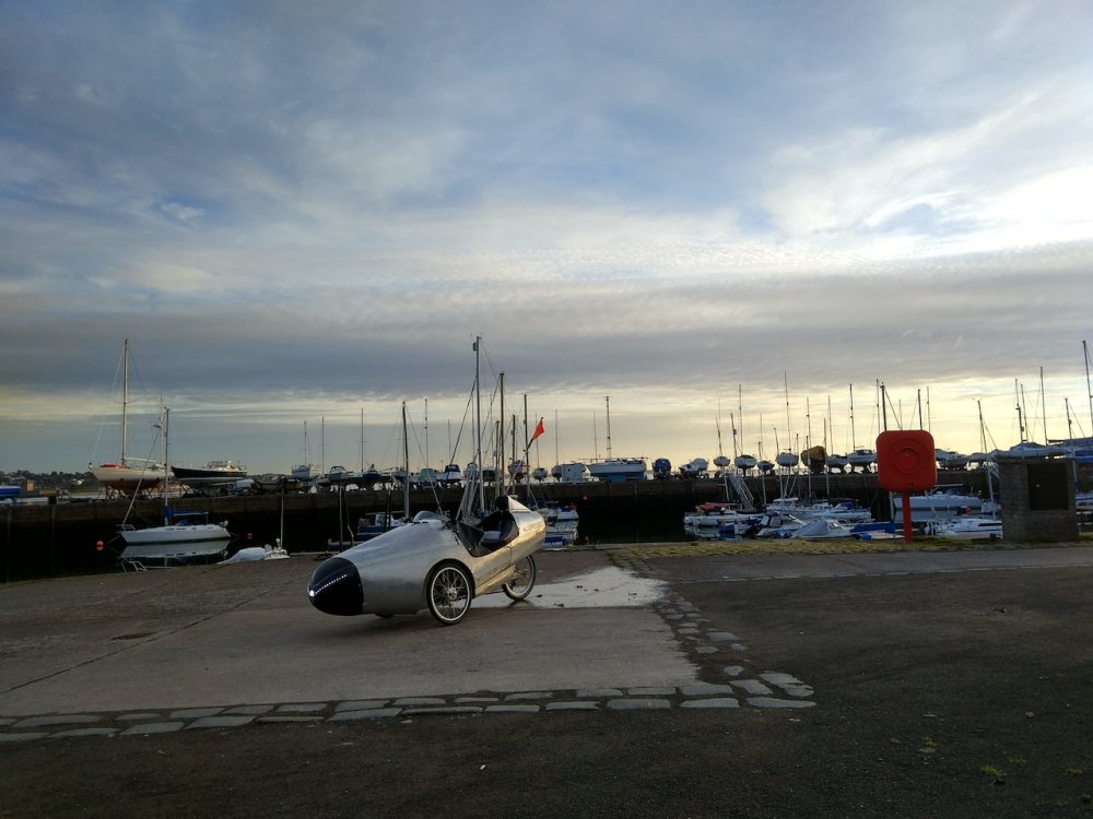

  13. Interesting find - I hadn't realised that GNG were working on smaller, lighter motors as well as the powerful but rather industrial units they used to make. I'll stick with the GSM as I have it for now, but will keep an eye out in the future... That GNG unit could have the potential for a thinner Q-factor as well - due to the different geometry. Yes, I have an A4. Great fun, except when going uphill and running out of low enough gears Picture attached about half-way into my commute - the bike path at that stage goes past a local harbour.
