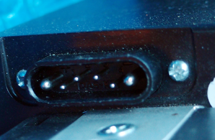

  3. Well at the moment the bike is a rockrider 8.1 but I think that will change sooner or later... Anyway... my backpack plan .I still fancy plugging wires between the two connectors but I 'm thinking it may be simpler to put the controller and battery in a backpack and simply extend the motor/PAS and display cables. I would still like to know about my battery / controller connector . From what I see online most connections from battery to controller are just POS and NEG , what might the four thinner connections be on mine.?

  5. My oxydrive kit is great but the battery doesnt sit very securely on my frame. and since I want to bounce around on the rough stuff, I think it might be better to carry it in a backpack.. I reckon If I left the controller on the frame, all I would need is a cable which can connect to the battery/battery housing plugs.. has anyone done this before.. can I get cable connectors to fit this?
