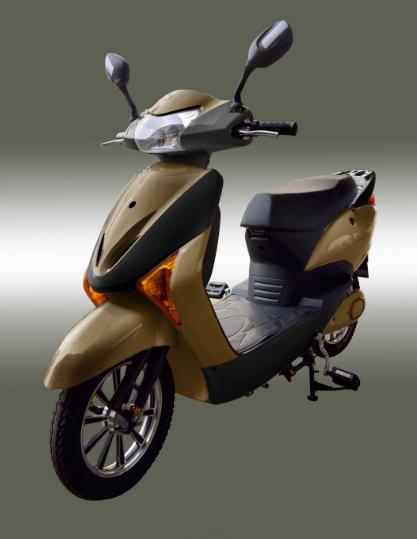

December 24, 201213 yr As some will recall, I got involved in trying to help a chap with a scooter who similarly was stopped by the police. In his case the scooter wasn't impounded and he wasn't charged, just advised to get it registered (something I tried to help with by taking the thing for an MSVA test, which it failed). This is a photo of a very similar scooter to the one I know for sure is not only illegal, but cannot easily be made legal to use here: [ATTACH]4722.vB[/ATTACH] We didn't attempt to argue that it could ever be classified as an electric bike, as the (very helpful) traffic officer demonstrated quite clearly that it was near-impossible to use the pedals as the primary means of propelling the thing, and I had to agree with him. Apart from the difficulty imposed by having the pedals spaced so far apart as to make pedalling very awkward, there was also the added problem that the pedals seemed to be geared at around a 1:1 ratio with the small rear wheel, making the cadence so high as to make pedalling faster than a walking pace impossible. The EU EPAC definition includes this: "cycle, equipped with pedals and an auxiliary electric motor, which cannot be propelled exclusively by means of this auxiliary electric motor" and the UK EAPC definition includes this: "be fitted with pedals by means of which it is capable of being propelled" and that the UK definition has been clarified by case law (Winter Vs DPP) such that pedals not only have to be capable of propelling the vehicle, but that such pedal propulsion has to be a viable means of propelling it in the absence of electric motor power. Anyone who tries to pedal a scooter such as the one in that image above will quickly realise that the pedals are purely for cosmetic purposes!
