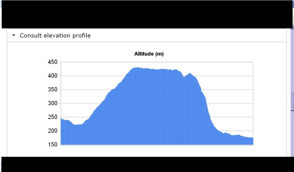

April 16, 201313 yr very good indeed. [ATTACH]5467.vB[/ATTACH] Dont like the Bank Brow bit, see pic, going down is 40mph fun though Edited April 16, 201313 yr by Ettica

April 16, 201313 yr very good indeed. [ATTACH=CONFIG]5467[/ATTACH] Dont like the Bank Brow bit, see pic, going down is 40mph fun though Here's a short journey I do in the car Wow I wish I had hills as tame as that
