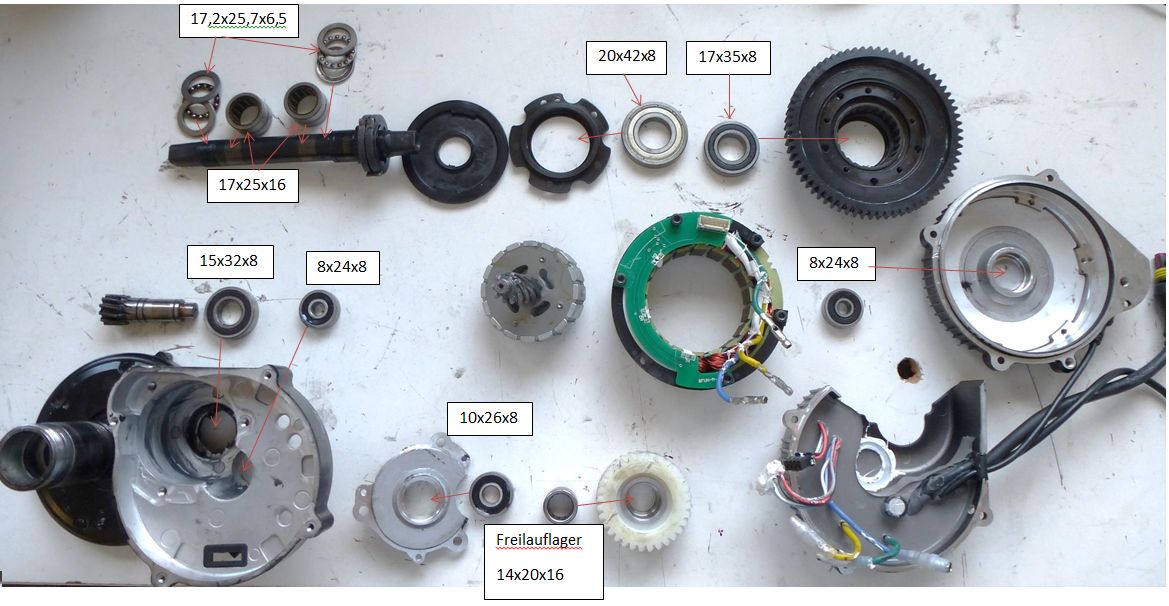

if you want a bafang with high-power then choose the 36v 500Watt.
Why not the 750watt? because the 48v 750Watt develop this 750watt at around 120-130rpm at the pedalarms. This is simply bull.... for normal bikerider´s
If you please have a look to the crankbearings´s, they cant handle this crankspeed for a long time. Please check the photo. This wretched needle-bearings including the chinese low precision.....
