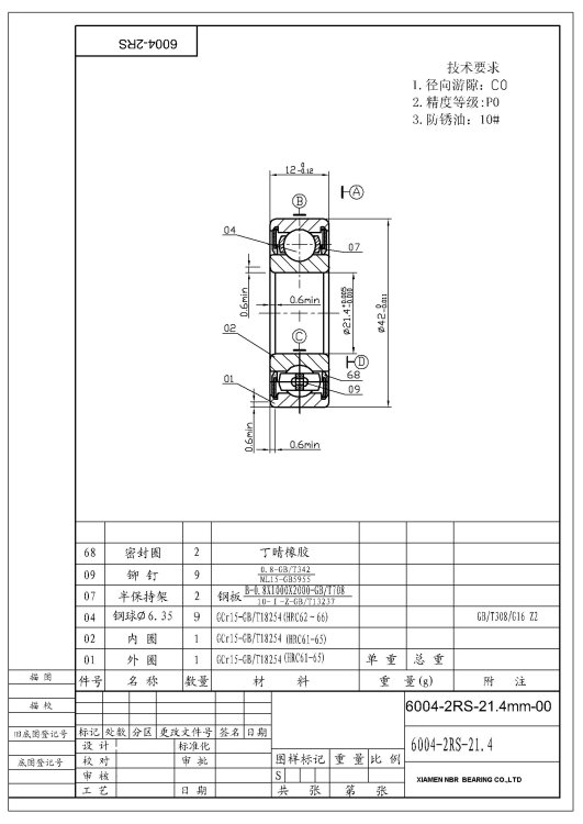

March 12, 201610 yr all that over a bearing pmsl can prob get 1 custom made for 50 quid. The engineering places I approached said they couldn't enlarge the bore of a bearing. But if you can find one that may help someone if they need the bearing. You need a 42 x 20 x 12 bearing bored to 21.3 mm (roughly) I've been trying to help Phill via PM after he messaged me. Phill's bearing is in far better condition than mine was, so a relatively easy fix if you're mechanically minded. and not requiring the unobtainable bearing.

March 12, 201610 yr Artstu so did you manage to get 1 in the end and fix it? Only the standard drive side one which had a huge amount of play, the one with the unusually sized centre bore on the opposite end of the shaft had to be refitted and soldier on.
March 12, 201610 yr have you got a pic of it? and what type it is and will ask my m8 as his gf runs a place that makes them for the mod. might get lucky can only ask.
March 12, 201610 yr have you got a pic of it? and what type it is and will ask my m8 as his gf runs a place that makes them for the mod. might get lucky can only ask. Worth a try, it's just one like this one with a centre bore of 21.3 mm (that needs double checking by someone) instead of the standard 20 mm bore.
