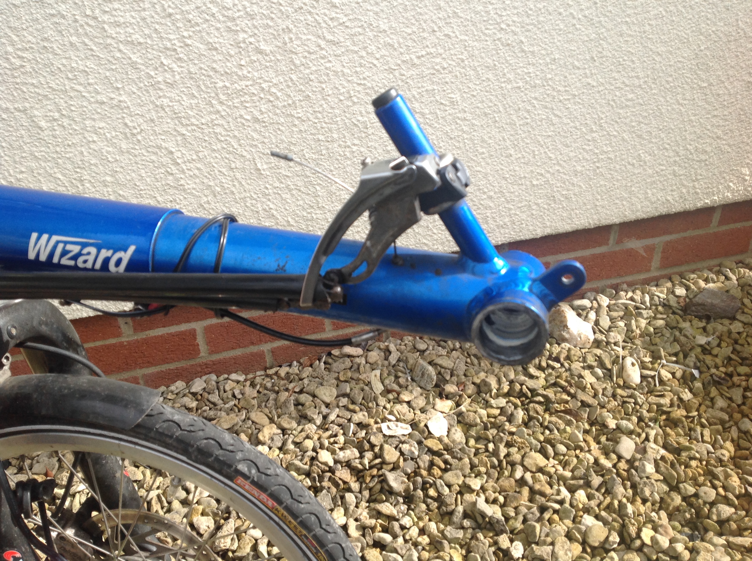

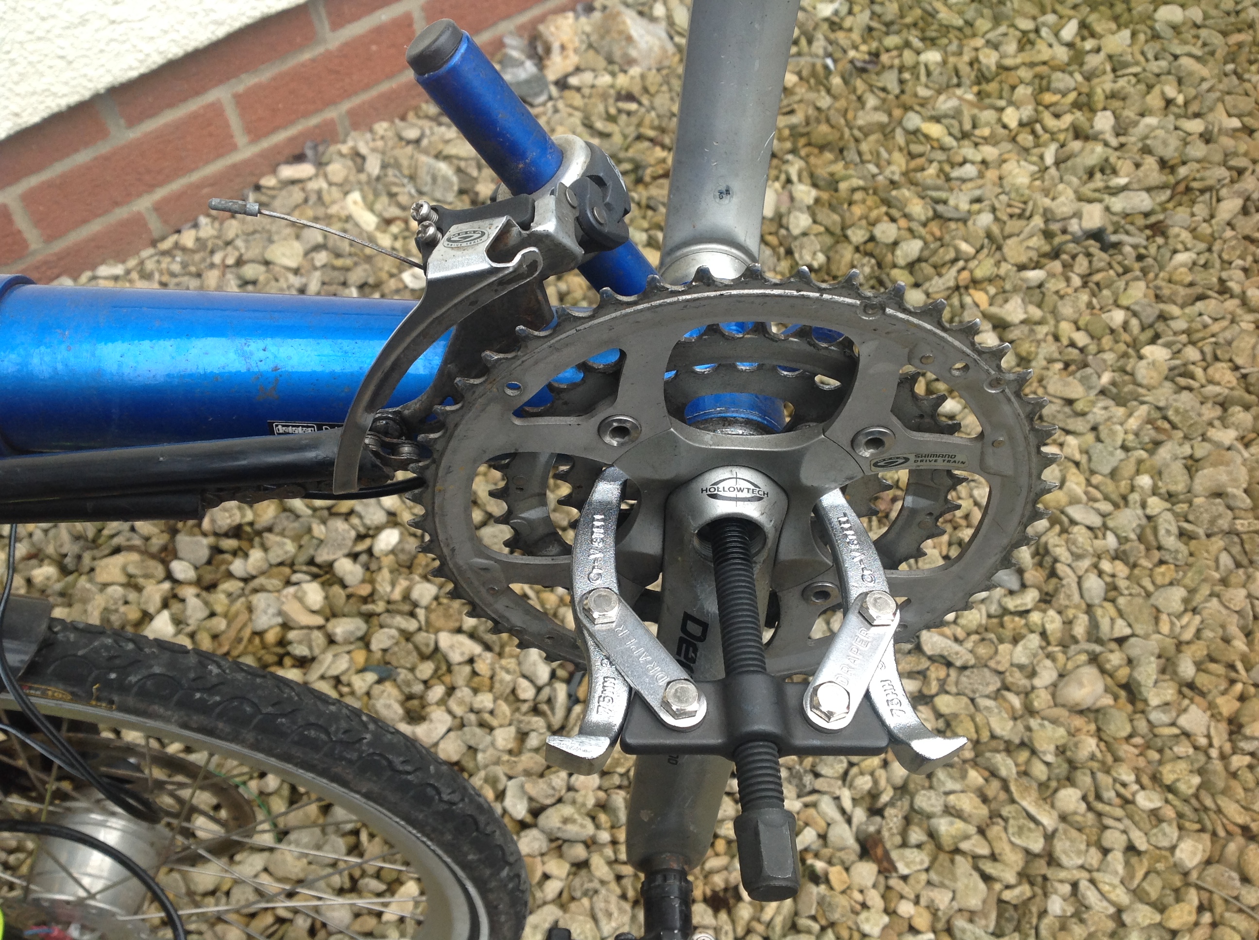

Fitting was simple gear puller to get the cranks off.

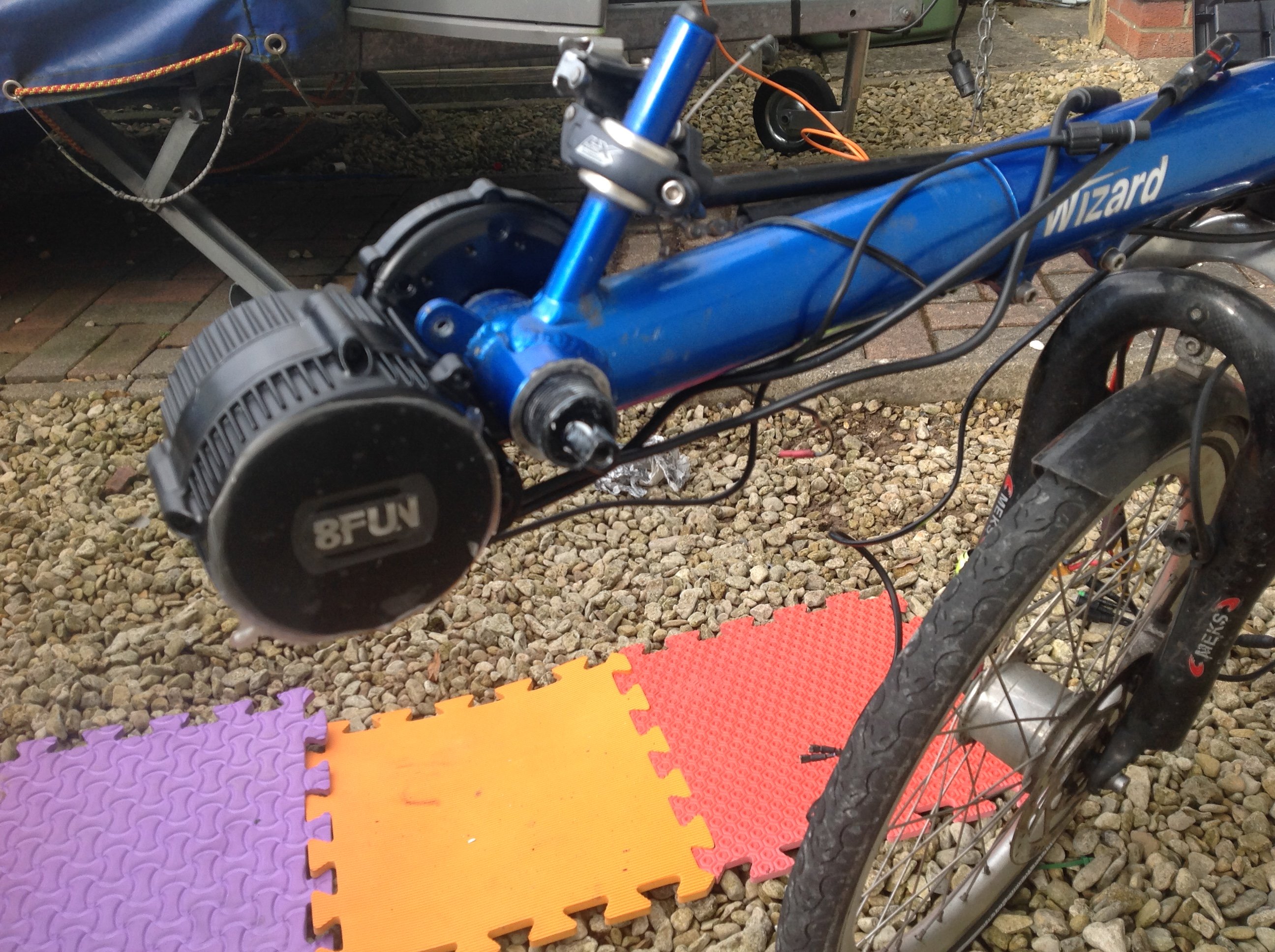

Slotting the BBS into the bottom bracket required a bit of dremeling to remove a band of proud material.
Then slotting was easy.
I have hydraulic brakes so time to order a cutout switch along with a speed extension cable.
Well my bottom bracket is out front and the standard won't reach the magnet on the wheel.
So extension and cutout switch sorted what about battery.
I have a few liposuction so a pair of 3ah 5s gave me a test rig.
The standard conectors were andersons on the BBS but the lipos have xt60's no problem and a quick solder job jobbed.

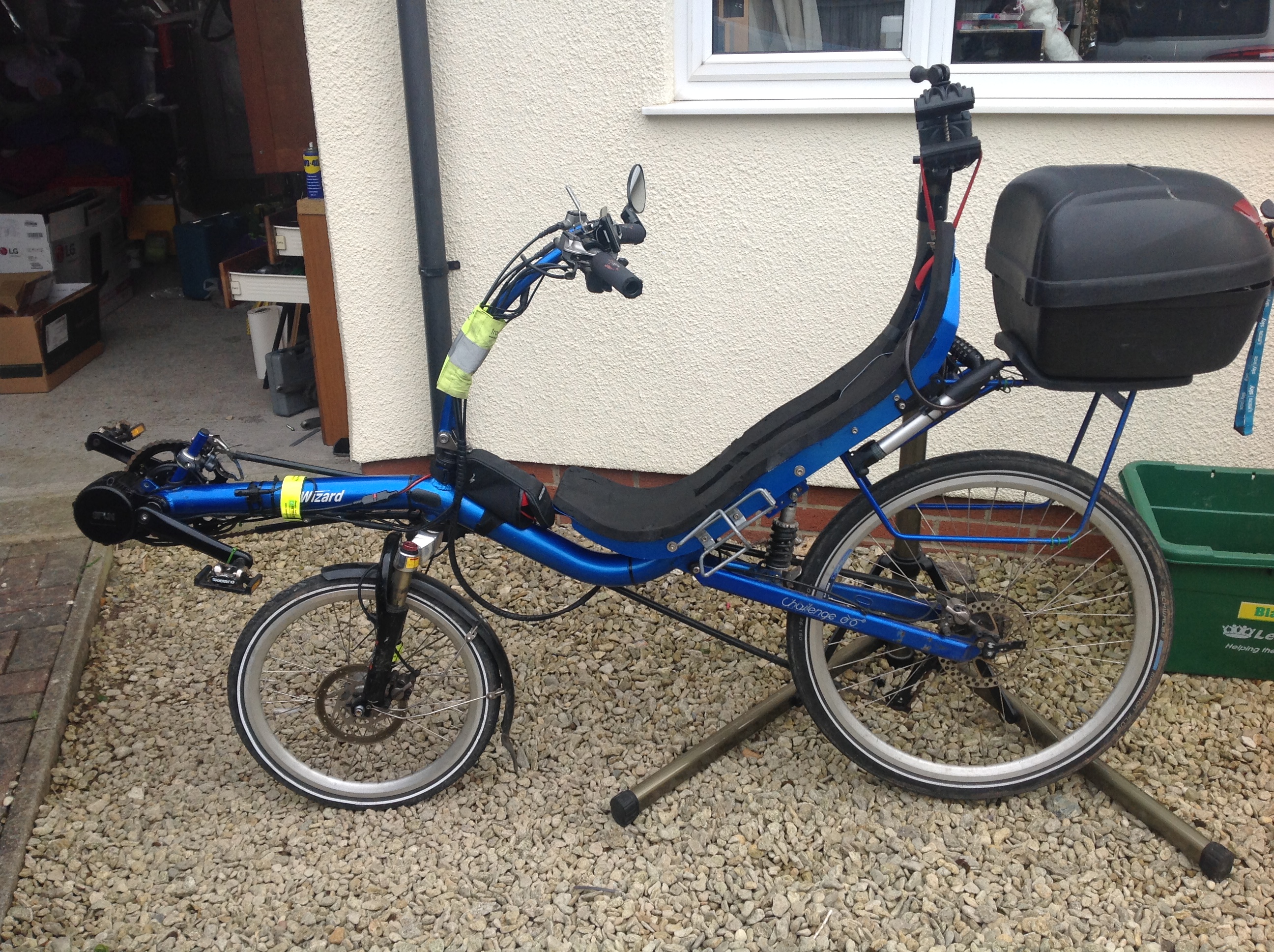

The bike is now set with factory power settings 15 amp but without the throttle I should only draw 10a (60%)
What's it like to ride.
Well top speed is down with only a 46 on the front 30mph is spin out time.
It crushes at 17 on the flat and the power delivery is on/off. Not good for slow speed manuver and when it finally comes in its all or nothing. Right gear required to start on a hill or forget it.
However I the right gear it pulls beautify despite the low power.
I left a decent cyclist for dead this morning accelerating to 16 and then the recumbent cut through the wind and he disappeared I'm my mirrors.
The speedo works but over 35mph. I think the anti bounce ccts cut in and the recorded speed falls to 17 ish and as I continue down hill I know I'm doing 40+ but the speedo lies.
