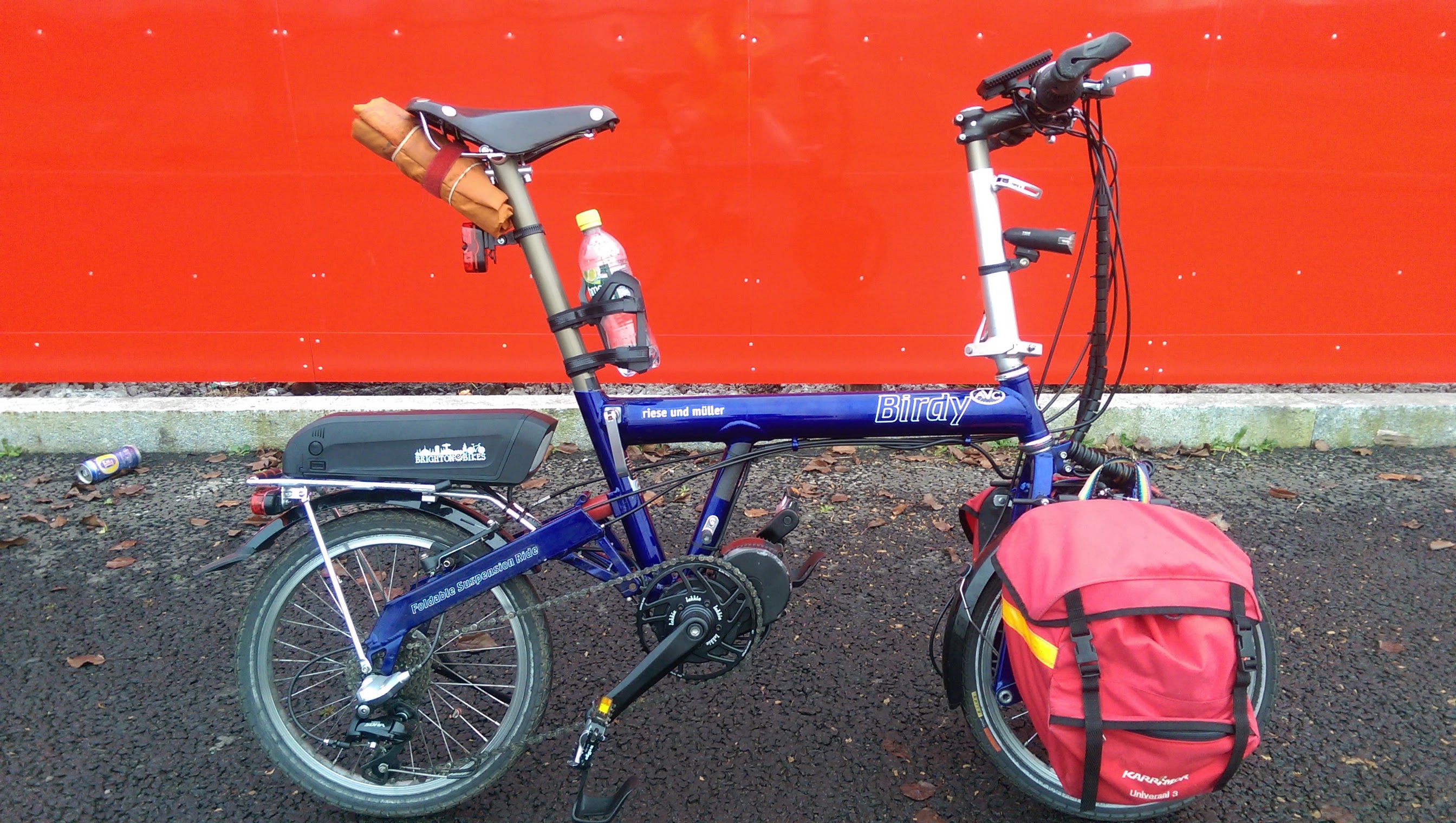

Birdy is a good machine to convert with a Bafang mid drive putting battery on the rack. Bought my kit from Brighton E Bikes.Splendid service. TheBafang.thumb.jpg.79af7a503eaf9154e70490cfae0ec04c.jpg Driveside.thumb.jpg.bbcfaecf35c4b591494324c0b5bb7da6.jpg Took me just over four hours. Works 100%.
Have you had to replace the large chain ring?
It would make the gearing very low, that's what put me off the idea of using that motor.
I have fitted a Lekkie 42T ring. Not too low on gearing for me. I have a three speed hub with 8 speed cassette. Before 'electrocuting' it I had a 56t chainring. Far too high a range so I changed that for a 48T. Even then I still never used the high gear in the hub. I thought I might with Bafang fitted, but no, its still middle hub gear most of the time and just slip onto the low for the inclines. Maybe one day on a long descent that top gear........... Theunit.thumb.jpg.3e1086fe1e3091fb16678cbf5d3923e6.jpg ...................................will come into its own!
You can put the chainring you want/need on the motor with a spider. I have put one on the GSM (Bafang spider is compatible) and the chainline is quite good. Not as perfect as it might be but not presenting any problems.
I have a 42 tooth on my 28" wheel bike, I think on a small wheeled folder I would be running a 50 tooth narrow wide chainring with maybe a 38 for the hills.
