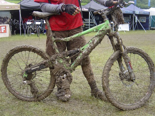

September 16, 20169 yr Author Thanks for the answers! Regarding derailleurs, years of muddy mountain biking has shown that as soon as it gets dirty a derailleur set up starts to fail. Shifting goes out or stops altogether. Chains snap. With the rohloff being completely sealed it works no matter what. Only downside is its heavy and expensive!
