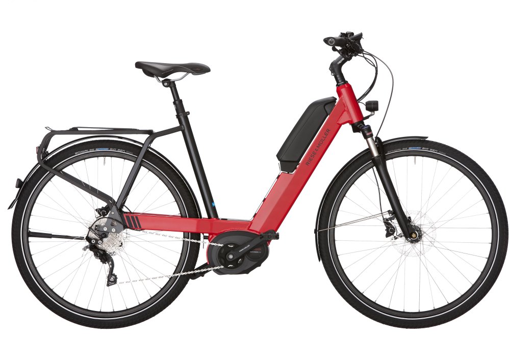

The money no object answer is the Riese and Muller Nevo, a step-through with a down tube battery.
Riese and Muller are among the sturdiest and best made of bicycles, so it would last for the several years of which you speak.
As a keen cyclist, you will probably appreciate the quality bike bits.
https://www.r-m.de/en-gb/e-bike/nevo/
Seems like the designers of the Nevo lost an opportunity to lower the centre of gravity on this bike
Why is the battery mounted so high
They could have put it on top of the motor on the down tube and still have enough room without loosing the benefit of a step through
The Nevo is one of the strangest looking Ebikes out there. It was designed as a step through that can be comfortably ridden by everyone regardless of height and weight. The large frame version is perfect for 6' plus and 20 stones. The styling is aimed at both men and women. The designer H. Müller claims it's the first step through designed for men as well as women. The battery position slows the ride easy access when mounting.
When I first saw the bike I was convinced it would be dreadful to ride particularly considering the the battery position would raise the C of G to an unacceptable level. My comment to RM was that the bike would never sell.
How wrong I was. The bike is solid well balanced and the effect of the battery being do high on the frame actually makes the bike feel more stable. I have no idea why but it does. The Nevo is one of RMs biggest sellers.
Strange but true!
All the best, David

The Nevo is one of the strangest looking Ebikes out there.[ATTACH=full]17596[/ATTACH]
I really rather like the look of it. Got a bit of a Dutch look to it. No surprise that it's popular.
The mention of the click in system on the rack for child seats might well suit Cari's needs.
Gaz
The bike might but the price may not.
£4200 for that Nevo. I guess people buy them, but, personally, I find it very difficult to understand how anybody would want to spend that sort of money on an electric bicycle.
This one (Chinese) follows the same idea:
This is very bike is very different. Completely different actually. There are so many differences it's tricky to know where to start. It's a generic Chinese frame built to a tight budget for a mass market. Nothing wrong with this kind of bike built to be rebadged and sold at a keen price, but a Nevo it isn't.
The Nevo is very expensive but absolutely superb for someone who wants to ride what, in my opinion, is the best step though in the world. It's solid and handles brilliantly.
Edited by Wisper Bikes
Weight higher up isn't a dynamic problem on two wheelers, modern motorcycles totally outclass the handling of those from long ago, despite their weight being carried much higher to allow greater banking angles.
I think the Nevo design is excellent, the higher battery a perfect solution for providing good foot space for step through.
That it looks good too is a bonus.
David, I did not compare the two bikes, having seen neither in the flesh.
I said the Chinese bike follows the same idea, there is no need to go further.
I've never ridden a Nevo, but I doubt moving the battery a few inches - which is all it is - further up the down tube makes any difference to the centre of gravity.
I expect that girder frame will be rock solid, so the down tube probably weighs more than the battery anyway.
