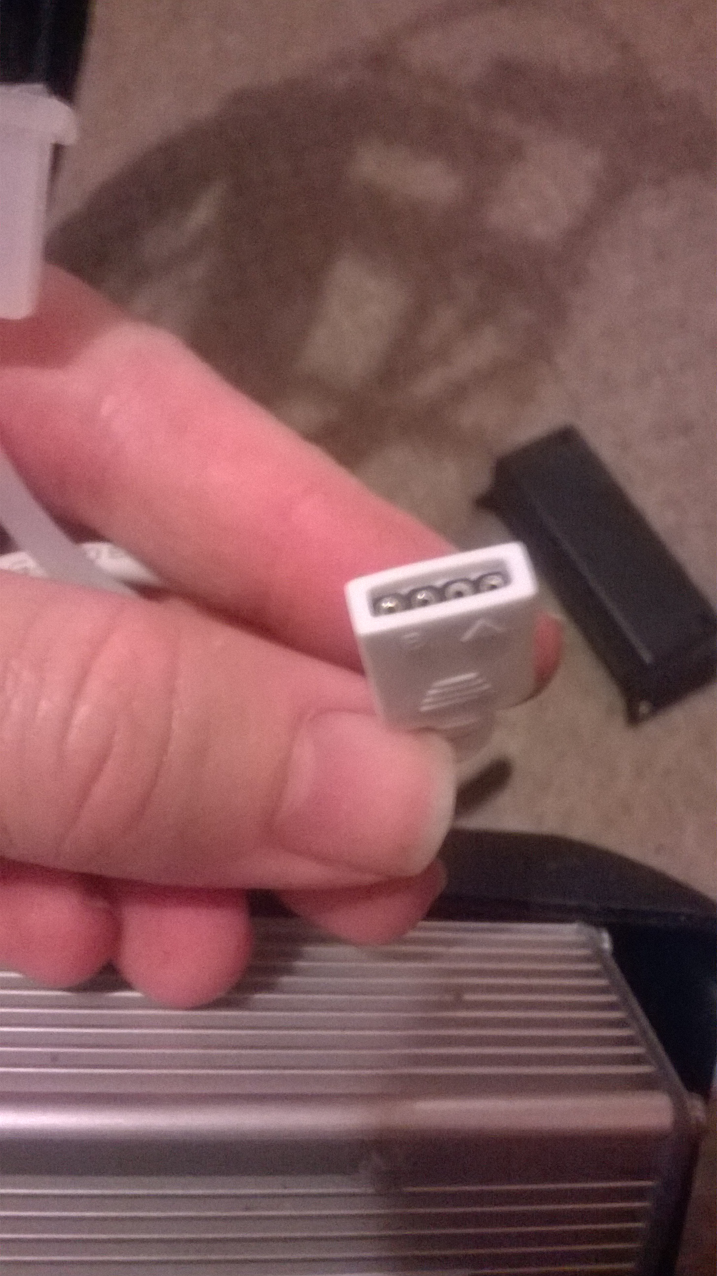

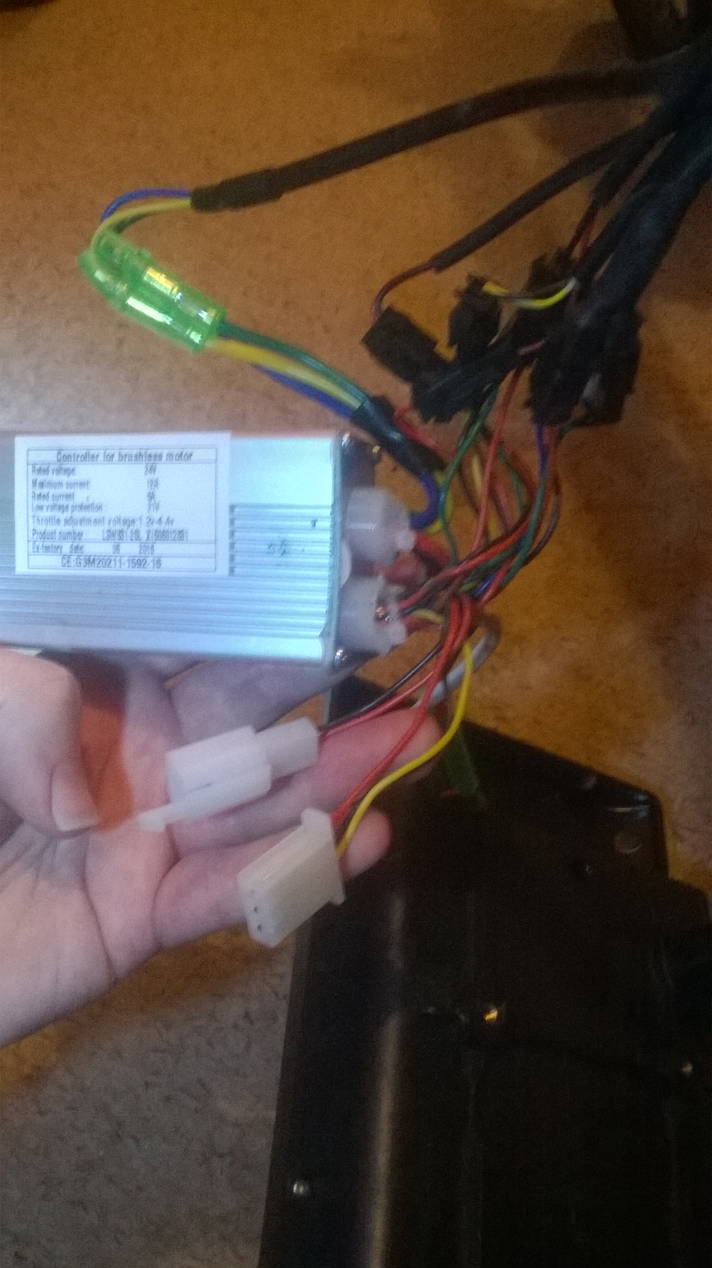

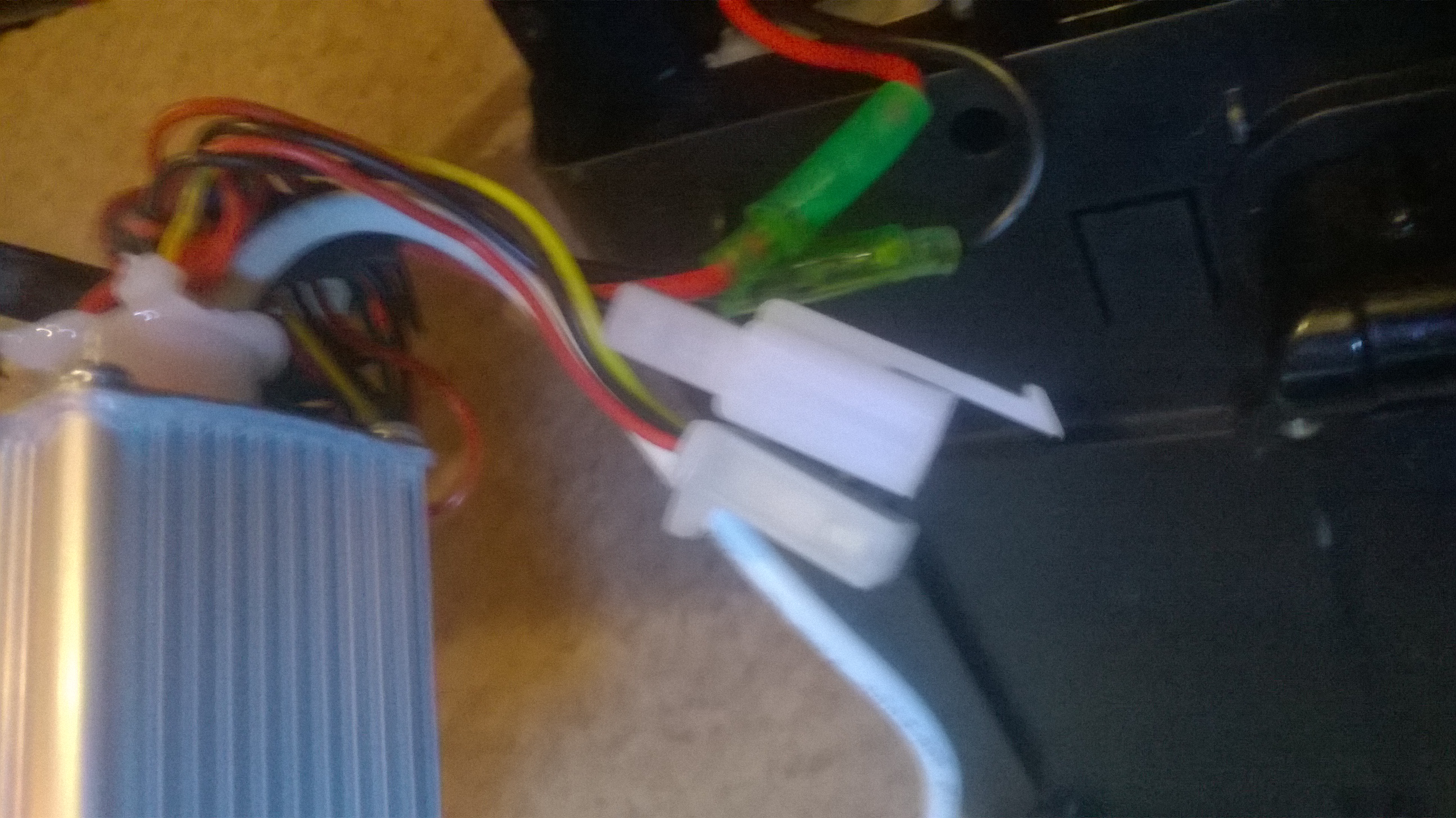

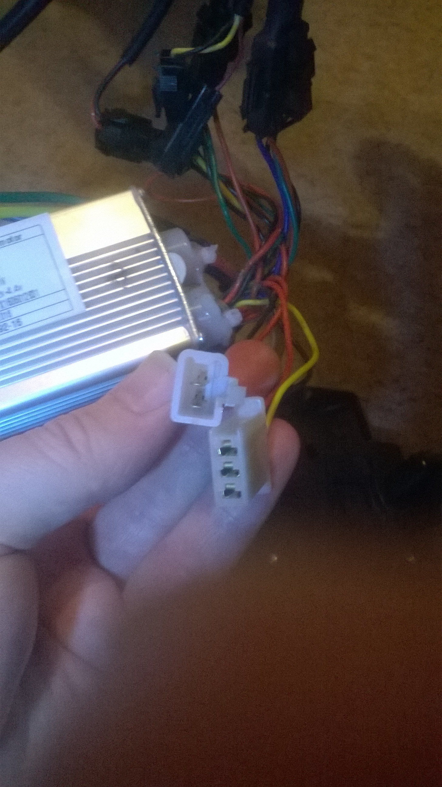

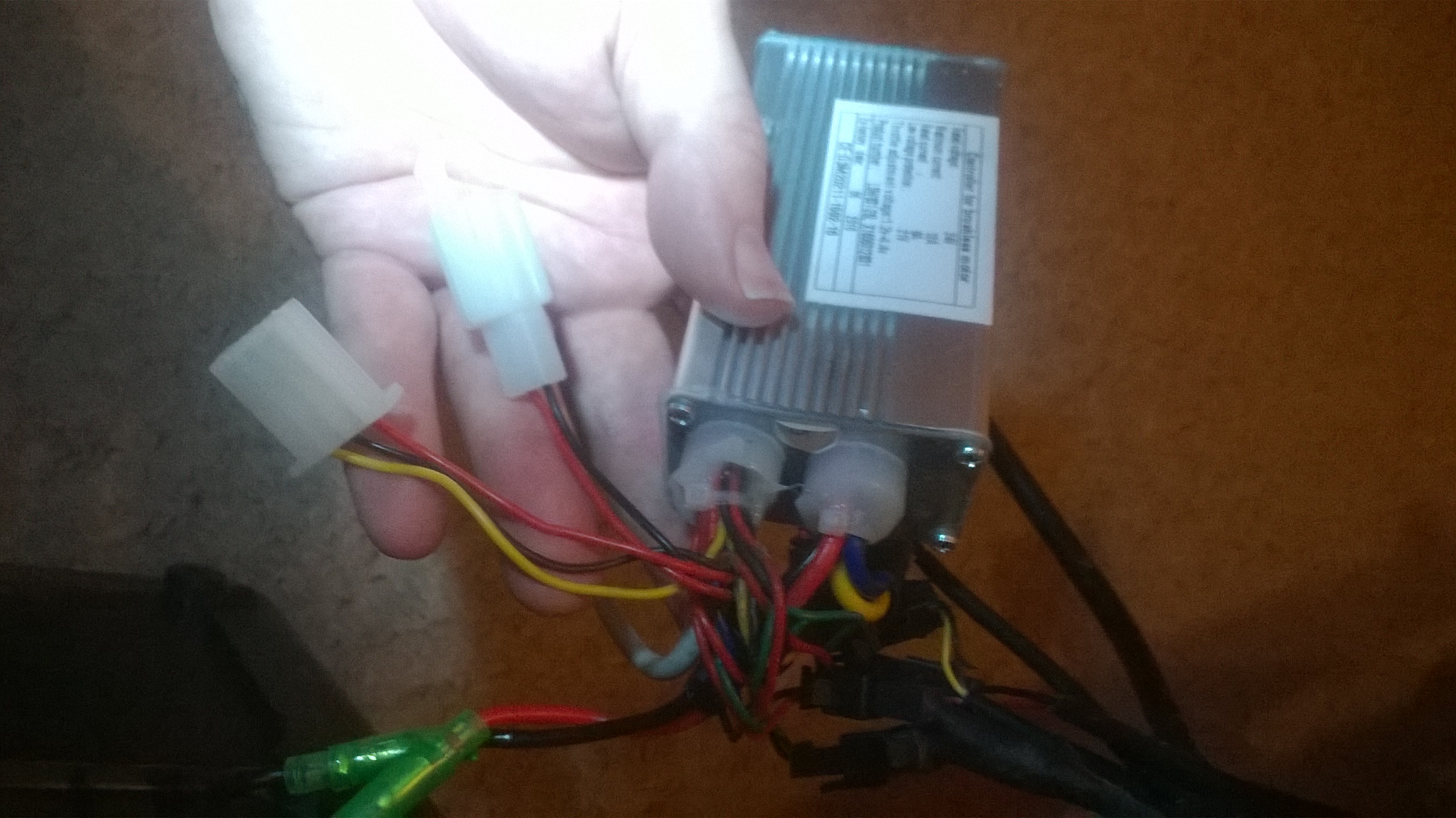

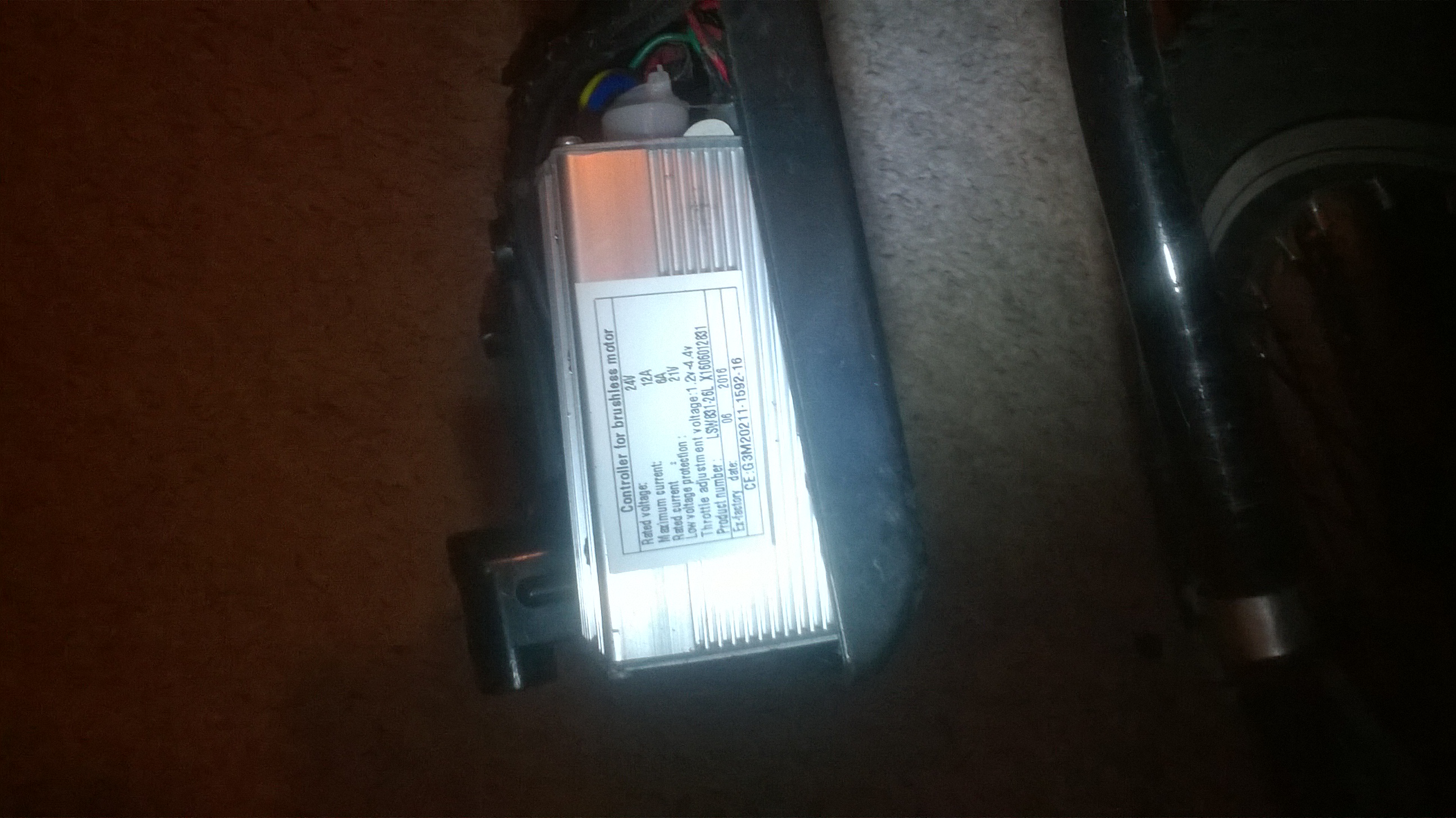

The controller sits in that little box at the front of the battery. You need to open it up and drag out the controller, then take a photo of all the connectors.
I'm hoping this is a generic sort of controller. There are three empty sockets - can I just buy a throttle and plug it in? Any help much appreciated :)

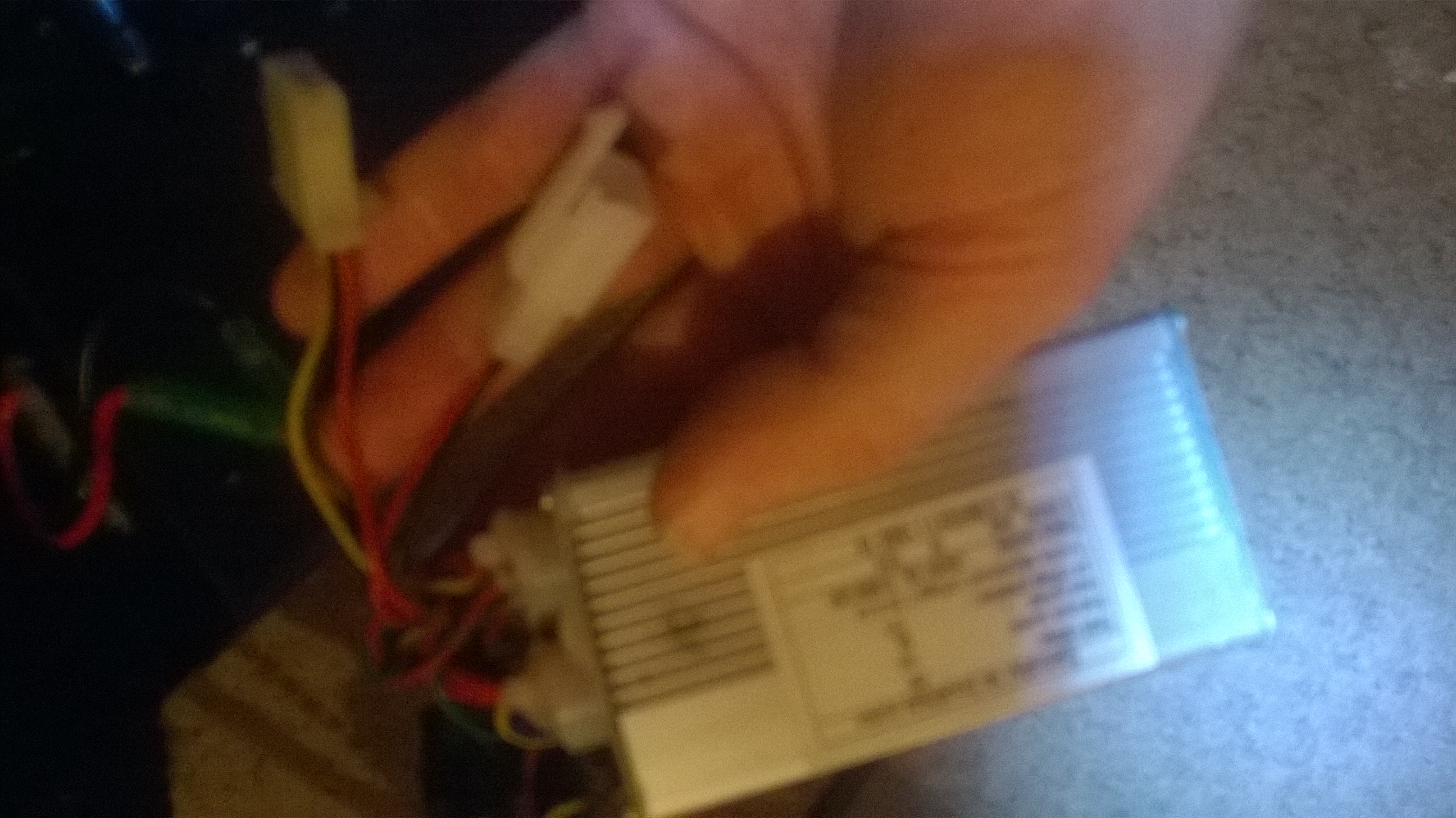

Pics are very poor :eek: and make viewing on the eyes uneasy..
The last one 4 pin is a data cable for programming forget that. If you only have those other two then you need a 3 wire/pin connector.
Red, black and yellow looks like a throttle connector. That's the old standard connector. When you buy your throttle, it might have the newer small black connector, in which case cut the connectors off and join the wires. make sure that yo connect red to red, black to black and yellow to whatever. Any throttle will work, but the small plain thumb throttles are normally easiest to fit.

A throttle will work 100% i have the same controller. Viking eco steppers also have a throttle connector.

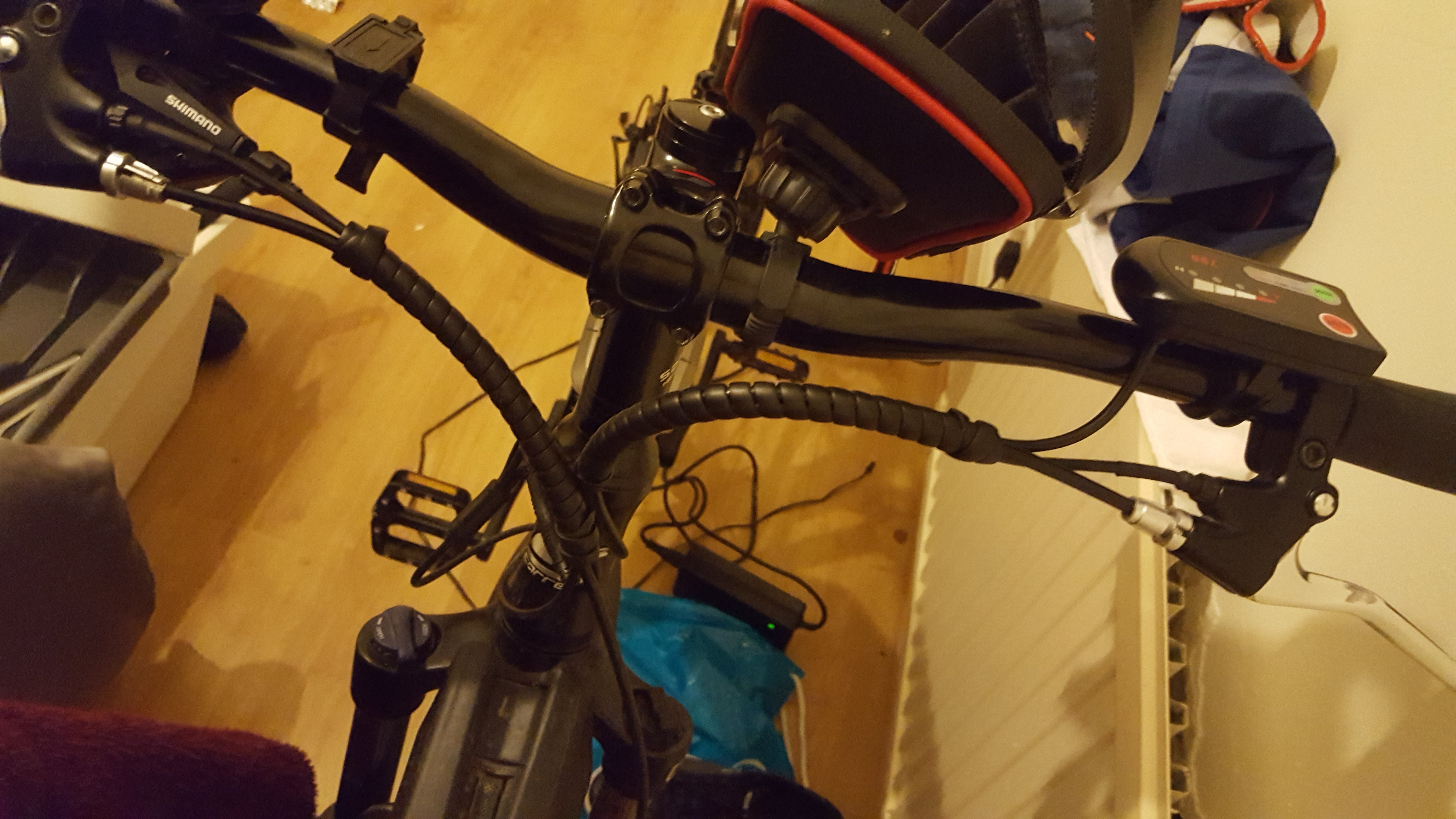

The only thing that could be considered a problem is that the Coyote Connect doesn't have space for the throttle on the handlebars as it comes - you will have to get your Allan keys out and move things around (it wasn't a problem for me, because I am now running the bike as a single speed, so I have put the throttle where the old Revoshift gear selector was).

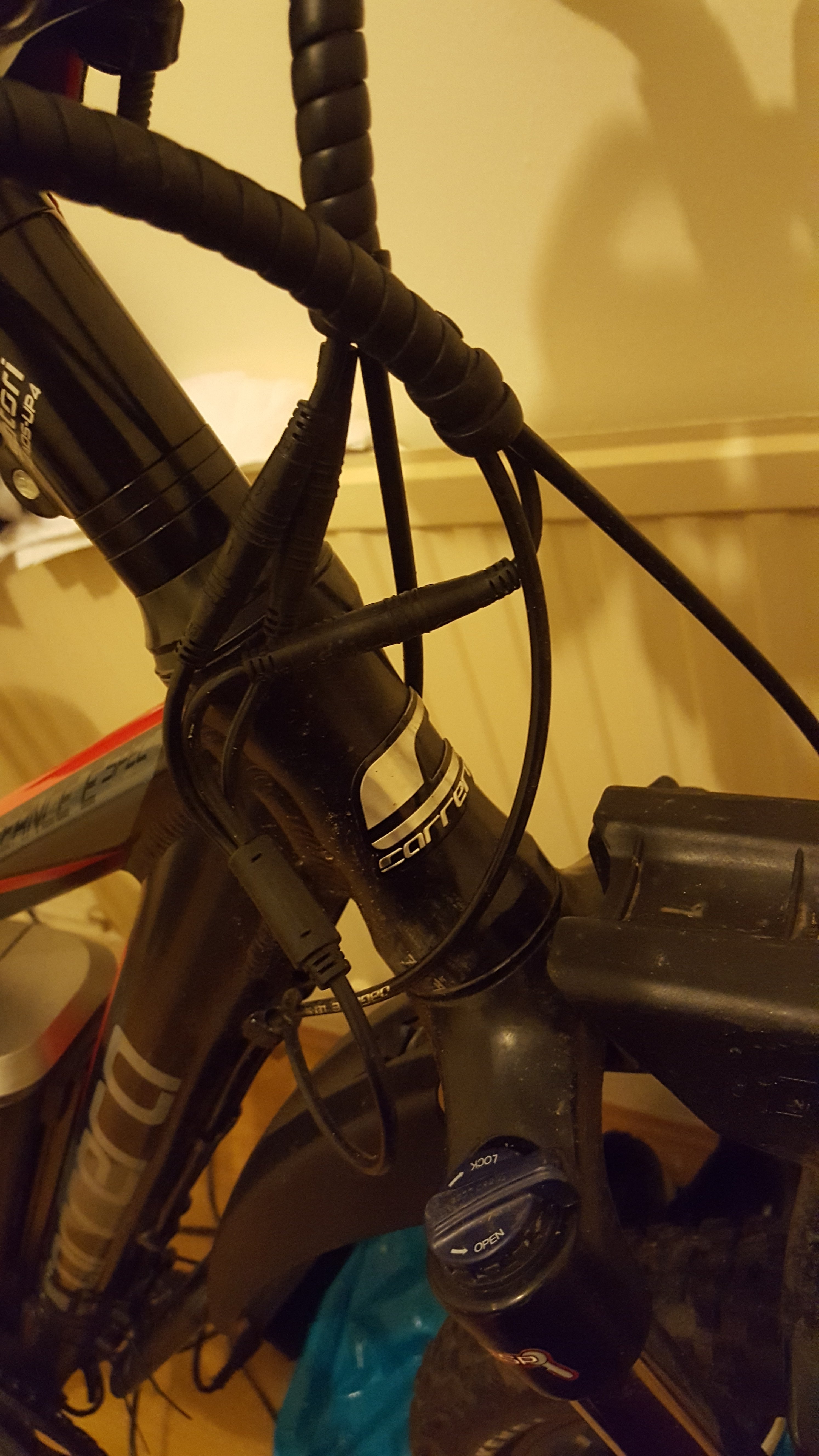

Hi, i would like some help fitting a throttle onto my bike it has the same kind of connector as the bike mentioned above i also got mine from halfords but mines a Carrera Vengeance E bike.
i really know nothing about these e bikes and dont want to mess my bike up can either of you help me step by step fit a throttle onto mine ?

Are you sure you have a connector for the throttle? Where is it? What does it look like?
Literally no idea but that bike has a similar remote control thing as mine
where would it be what can I take photos of for you to see weather it would work or not
I'm pretty sure that yours doesn't have a connector because you have a different type of controller with sealed wiring.
20180202_015317.thumb.jpg.6745bc8d927dd35da888e0973fcad849.jpg 20180202_015311.thumb.jpg.7a55b8405f7b47094ed78d4c72ef8421.jpg 20180202_015311.thumb.jpg.7a55b8405f7b47094ed78d4c72ef8421.jpg 20180202_015306.thumb.jpg.6a73410f4171e0c064de1aba574d849a.jpg So do you think there is no way to add a throttle onto this bike
Myguess is no. Photos don't show what I need to be sure. If the main harness branches into 3, then it's no. If there's 4 branches, find the empty one.

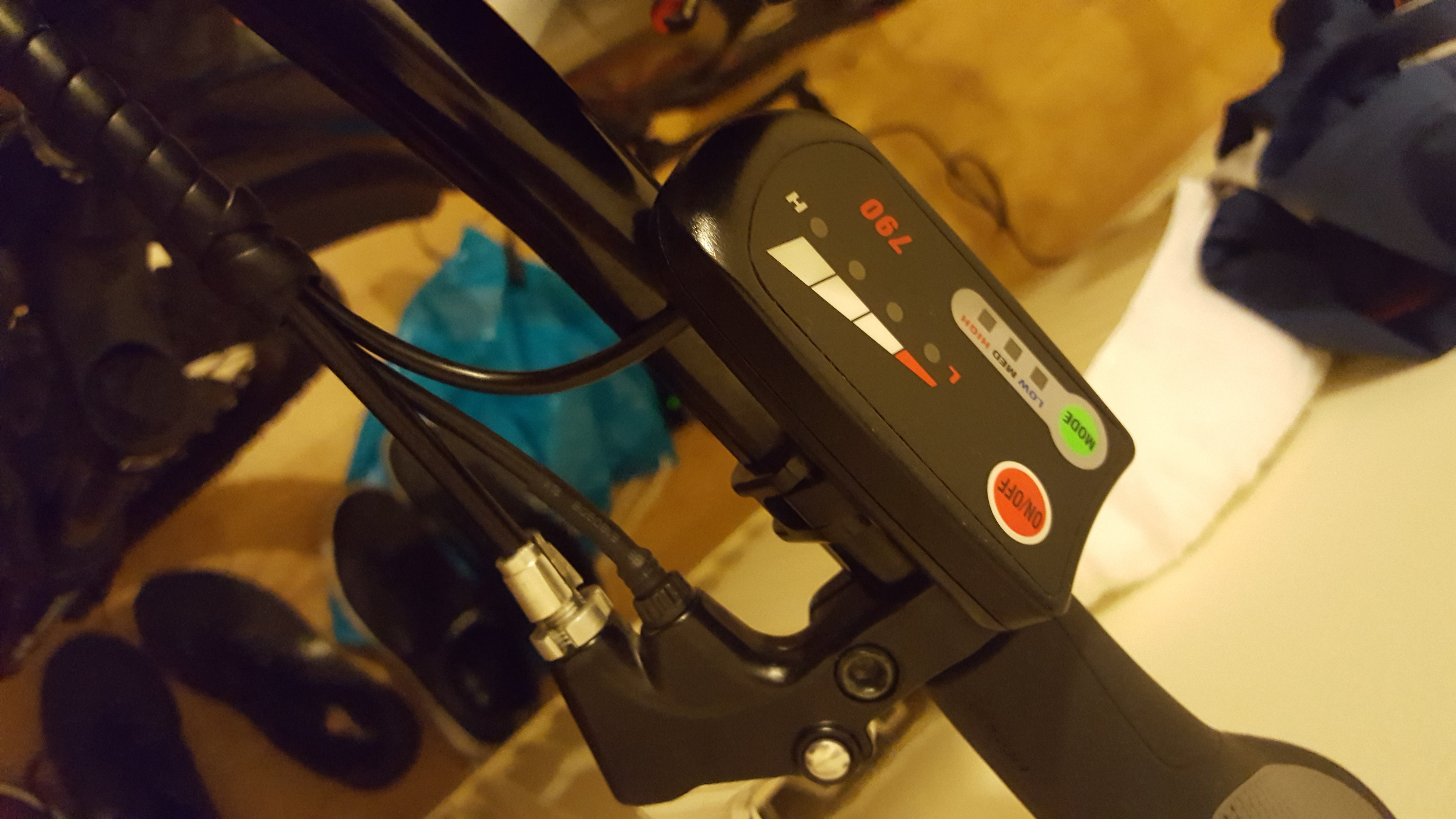

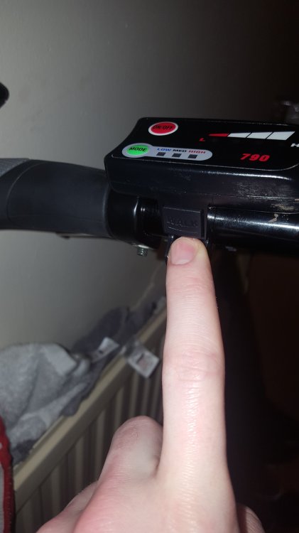

there is like a button thats kind of like a throttle because you press and hold it and the bike thrusts forward but it's very weak like walking speed maybe there is a way to increase the power output to the motor so it goes faster look I uploaded it 15176087974041323473160.thumb.jpg.8a6b06d10ea512a5ab4c4fc02478e395.jpg

there is like a button thats kind of like a throttle because you press and hold it and the bike thrusts forward but it's very weak like walking speed maybe there is a way to increase the power output to the motor so it goes faster look I uploaded it [ATTACH=full]23285[/ATTACH]
Sorry I've only just seen this, not been on the forum for a bit, I'll be honest - based on my experience I wouldn't recommend a throttle! It absolutely leathers the battery and isn't much easier than just ghosting the pedals around. I did have great fun with the throttle at first (because I'm an overgrown child!, but hardly use it now.).
The photos they need to see are of the guts of the controller etc:- the internal wires, connectors. If you aren't comfortable opening stuff up, they won't be able to help.
