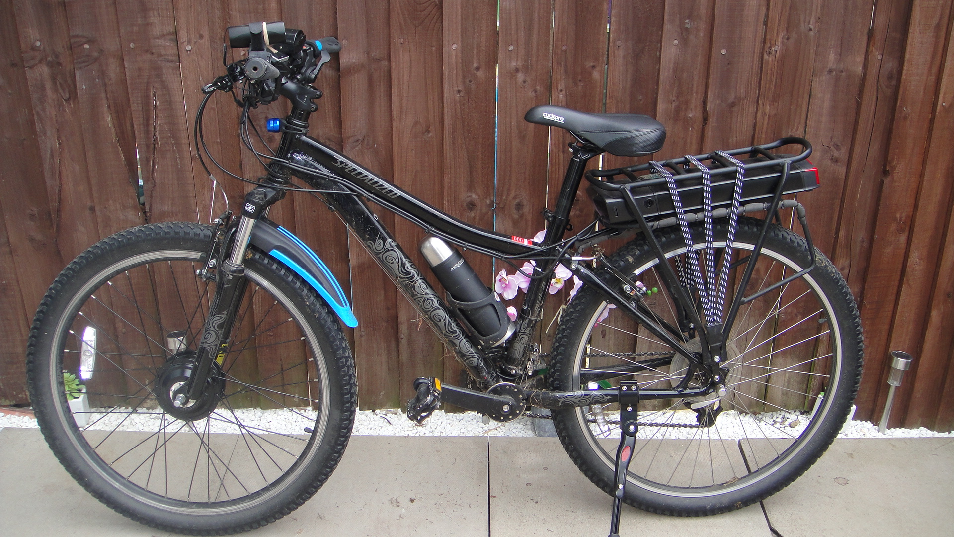

June 15, 20178 yr It's more my type of bike as well. I like cross country bikes and the oxygen's styling. The Oxydrive kit bike I bought off [mention=11625]STEVEMANFA[/mention] is spookily similar in it's setup. I'd pay for the extra battery power too.

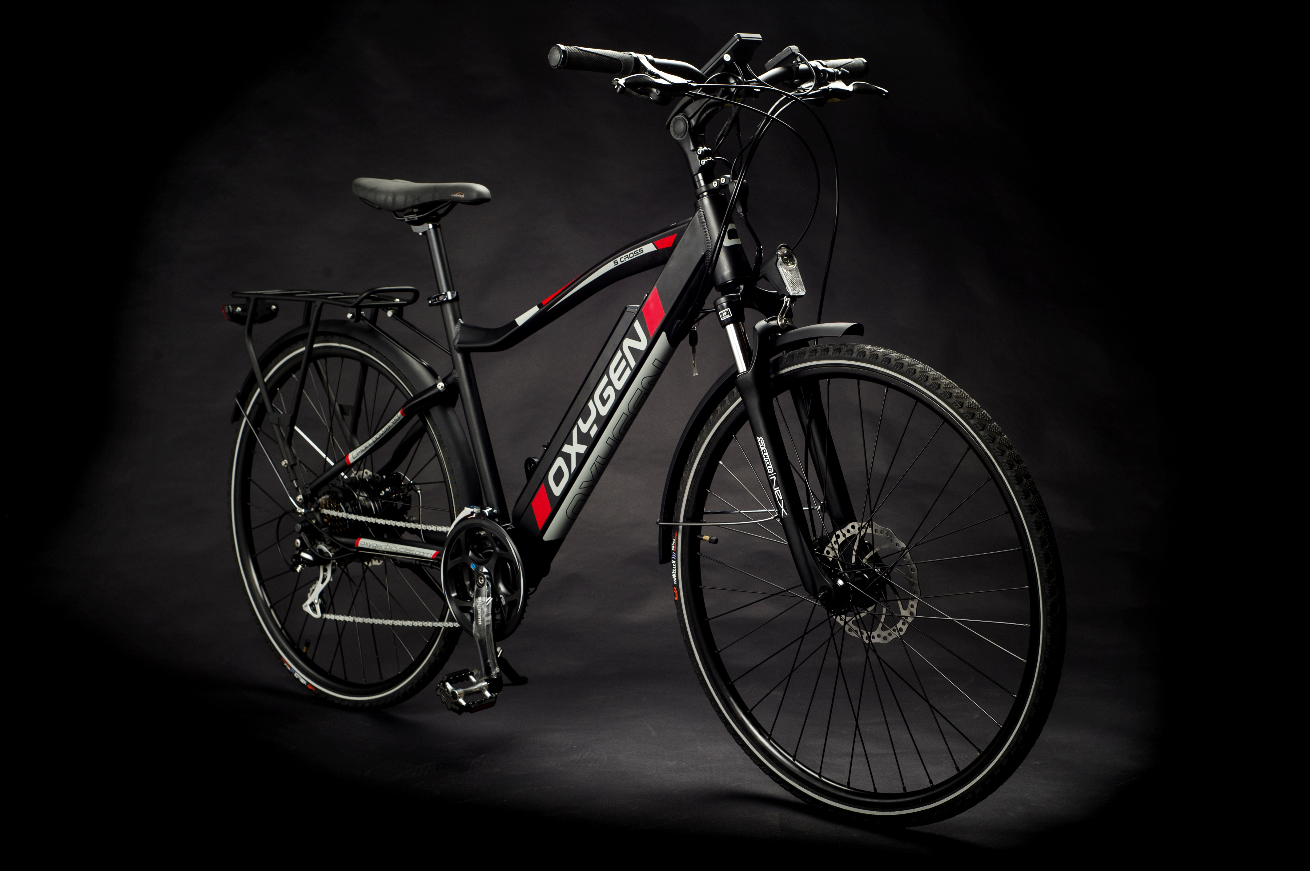

June 15, 20178 yr Many people choose the Oxygen because they found out how to derestrict it for 26 mph, which is handy for commuting. The Oxygen MTB is a bit more expensive, but it's worth it for the superb handling and braking.

June 15, 20178 yr Hi D8veh, The derestrictment was one of the reason too, but on the same time would that be a double cutting edge shortening the battery life? I guess that in the end it's you who decide whether to use it or not... is the Oxigen available only through E-bikedirect? Is the website trustworthy? They even have an ex-display one for 150 quid less, but I wonder if it's best to go for a proper new one. It will hardly affect the battery at all because the current goes down the faster you go. Maximum current comes at low speed when you're climbing. Also, the Oxygen has independent power control, so you can have the higher speed limit with reduced power. There are 18 combinations of speed and power control: 6 for speed and 3 for power.
June 15, 20178 yr Looks like an easy pick then. I've tried the Carrera and it was really nice, anyone who tried both of them? Basically I would pay the carrera 1100 compared to 1400 for the Oxigen. the Oxigen is a better model, but is it worth 300 quid more in your opinion? Also have you ever bought anything on "e-bikesdirect"? My reason for choosing the Oxygen would be that it uses standard Chinese parts, so spares will never be a problem. You can mix and match motors, controllers and batteries, so you don't need to rely on expensive OEM parts. The Carrera has a locked system. You can only get spares from Halfords. You'll have to pay whatever they charge, though their prices are not that expensive at the moment. One other point in favour of the Oxygen: It comes with a self-fit throttle. A throttle is generally not necessary, but it can be extremely useful at times. I wouldn't want an e-bike without a throttle. I've been saved at least three times by having one: One time my pedal/crank came loose so I couldn't pedal; another time I fell off and banged my knee so that I couldn't pedal; and last week I had a bad foot, which stopped me from pedalling. I couldn't use my car either and I needed to get to the doctor.

July 3, 20178 yr Author After a week with the s-cross cb, I can definitely say that is worth it's money. I've tried the carrera as well, and as a term of comparison I can say that the engine of the carrera felt a little bit more powerfull, but maybe it's just because the s-cross is a little bit more heavy. On all the rest the s-cross win. It's more comfortable, the power settings are more "advanced" and this alone is worth the bigger price tag. Battery life looks decent, using the 35km/h speed limit allow me to ride for 25 miles and still be on 34.5v. The only thing that I still have not figured out is the cutoff of the battery. Is it 32v or 30v??
July 3, 20178 yr I did 37miles in a hilly area and was on 35v or 36v and one bar lit, I can't remember exactly, I am not sure what it would be when completely flat, did you start at 41.5v, that's maximum for me when fully recharged.
July 3, 20178 yr Author Almost the same, max 41.5, got flat at 33.5, and the range was more or less 30 miles I would say, maybe 33-34 max. Discovered it the bad way, with 5 miles left and a massive hill to ride xD
July 3, 20178 yr The only thing that I still have not figured out is the cutoff of the battery. Is it 32v or 30v?? 30/32v is a bit low unless you are doing a discharge test. most 46v batteries will have lvc at or above 33v. My Oxydrive's are at 33.5 when lvc kicks in though will recover by about 0.5 - 0.7v once cooled this is normal as a fail safe to prevent over discharge of cells.
