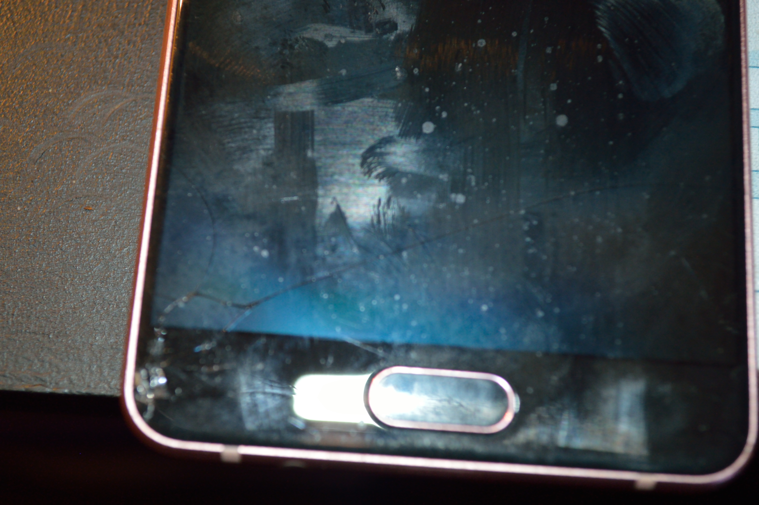

pmsl my mom just dropped her phone on the floor and look what happens.
but only the glass is broken and 9 quid on ebay and easy to fix :rolleyes:
fkn thing is all glued together need a heat gun station oven and about an hour to even try it fkn bin job
[ATTACH=full]22551[/ATTACH]
