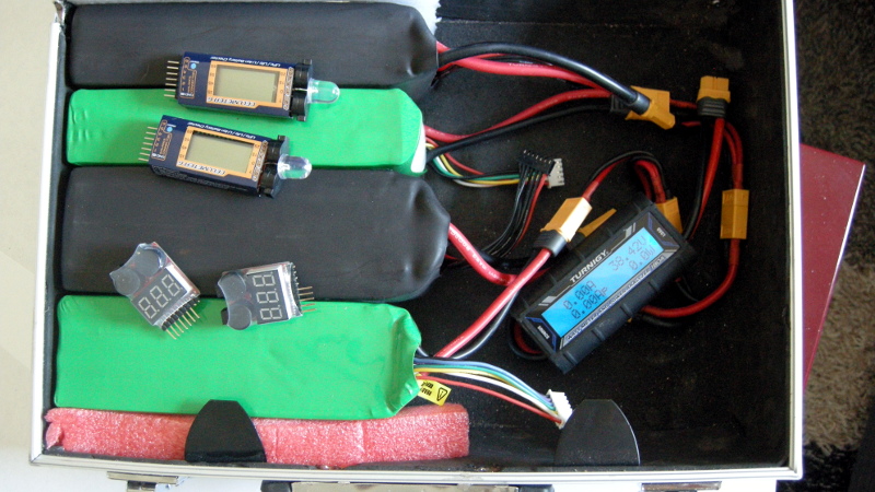

November 23, 20187 yr Some other things that come in handy are alarms set to go off when a cell reaches 3.65v and a Wattmeter. The most useful tool is a thing called a Battery Medic which gives the voltage reading for each cell in a brick and can be used to balance the voltages. Another important thing is to not let the cells get out of balance with each other, mine are always within 0.03v of each other (the black ones 0.01v). As said above charged to 4.15v per cell and discharged to 3.65v. The green ones are good for 80% of the Ah printed on the packaging and the black ones 90% (have had 9300/10000 mAh) so what you see is a 16 Ah 36v battery. I also use them as an 8 Ah 36v battery and a 8.5 Ah 44.4v battery. Most often I charge after having used 5 Ah or 12 Ah for the big one above. I have been using the above for just over 2 years. I used to charge in the oven because I didn't have an outdoors. Now that I have an outdoors I charge them there...
