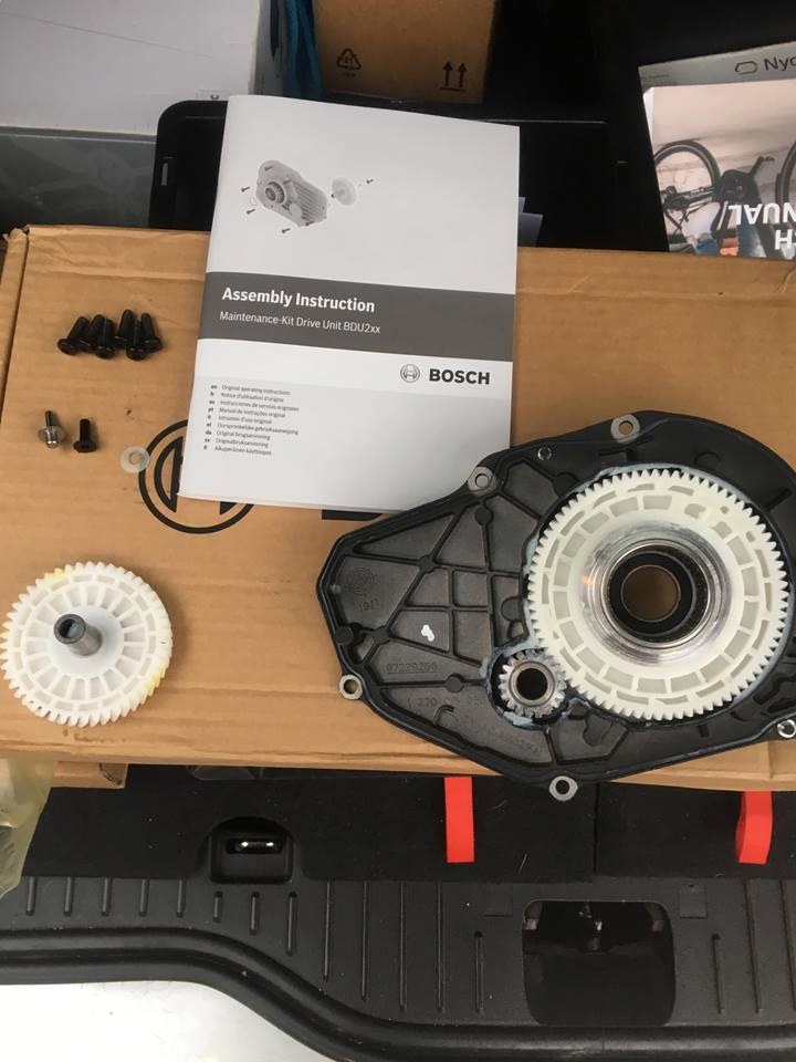

As you may already be aware, Bosch are just about to release a maintenance repair kit, which is designed to offer peace of mind to those owners that are buying an ebike that is out of the covered warranty period.
Given that the kit comes with the following items shown below, including outer case and gears, it offers exceptionally good value at a retail price of £95.00. Whilst primarily designed to be installed by a Bosch approved dealer, with correct tools, and due care and attention, I can't imagine it being outside the scope of a competent person to carry out the process at home. As well as looking easy to install, the kit also comes with a two year warranty. I wonder if anyone else advertising bearing replacement, could offer that kind of cover.
What seemingly never gets mentioned when people talk about replacing bearings within the Bosch drive unit, is that there is high probability of damaging the torque sensor when changing the left hand side (non drive side) bearing, which can lead to the ebike ghosting. I have replaced right hand (drive side) outer bearings my self for other people seeking help, and as far as I'm concerned this kit offers everything that you will need, without risk of causing damage to sensitive parts of the drive unit.
I was made aware of 'ghosting' a while back, by someone that had recently had a drive unit rebuilt by a non Bosch approved company, and wouldn't personally risk touching or dismantling anything beyond what is sold within this kit, and it is with good reason that no Bosch technician is permitted to so either. The torque sensor is tested and calibrated in what Bosch call an “end of line test” at the production facility. If you remove it, it’s not possible to check the calibration after refitting it....even if the paint is aligned across the nut and torque sensor shaft.
I shall update this thread over the next few weeks with defined photographs when I get the chance of being able to review the kit my self, but I certainly think that with what is being offered, it represent superb and hassle free value for money.

Don't get me wrong here, if you are familiar with my posts I am normally the one who has normally defended Bosch and their engineering quality etc.
I am also please that they are stepping up to the plate with this solution and at an unbelievably cheap price too!
However, there are a few issues here? Most motors I see that have failed in the usual way i.e. water ingress, and many suffer damage and wear to the bearings on the other side of the motor?
So, you pay your £95 + Labour, but only end up with half a repaired motor!?
As for Bosch scare mongering with "Ghosting" stories! (Ghosting, is the bike taking off on its own). I have never seen this? From an insider at Bosch, this has apparently only ever been seen once and was caused by a software fault! Nothing to do with the torque sensor.
The torque sensor has two flats on the bolt that goes through the left hand motor case that also has two flats on it. So, the torque sensor can only go in one place. Saying that, there is room for a couple of mm of movement. So, although I have removed and refitted many, many torque sensors I put a motor on my test rig anyway. here I can set the pedal pressure and try the torque sensor in every position I could get it. As predicted no ghosting and no difference to the amount of pressure required to kick the torque sensor in.
And don't forget, the motor needs to see both pedal pressure and speed sensor to allow the motor to keep running, so again "Ghosting" from the torque sensor position should not be possible.
I can't help feeling that Bosch releasing this £200 part for £95 and telling stories about Ghosts etc. maybe to try and hurt a certain Bearing Man :rolleyes:
This kit is an absolute bargain if you strip or wear out a plastic sprocket (not that anyone has ever seen that yet?) Half a £600 motor for £95, you can't go wrong! But, sadly what will happen now, is it will just end up costing people £95 to £150 to fix their £10 - £15 main motor bearing :(

https://www.pro-cycling-golla.de/Service_Kit_Instandsetzung_BDU2xx.html
Service Kit Repair BDU2xx
Item No. 0275007384
The service kit includes the following parts:
- lid (incl. Sealing, bearings, freewheel)
- gear
- gear grease
- cover screws
- Lagerpin with elastic waistband sleeve and front cover
- service manual with
the bearing with bearing protection ring and bearing grease is pre-assembled.
The repair may NOT be carried out in the following cases:
- Within the warranty.
- If the eBike has a coaster brake.
- If it is a drive unit of type part numbers 0.275.007.020 to .025.
- If the drive unit is not functioning electronically.
- If the drive unit has obviously been manipulated or damaged.
per piece (including 19% VAT)
119,90 EUR
Limited quantity 3 - 5 days
Sold only in the shop
- gear
- gear grease
- cover screws
- Lagerpin with elastic waistband sleeve and protective glass
- repair manual
is the bearing with bearing protection ring and bearing protection fat assembled.
